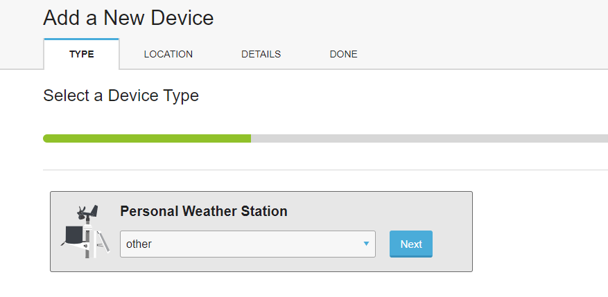

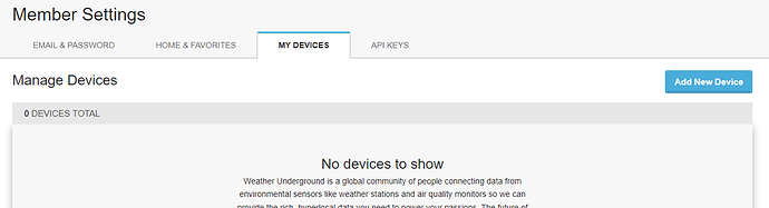

I was able to get one and don't have a PWS. I am starting to think it was because I was thinking I needed to add my Hubitat device to My Devices first. I did not see Hubitat in the My Device list, so I selected "other". Then I got an API and I have been using it for a couple of months.

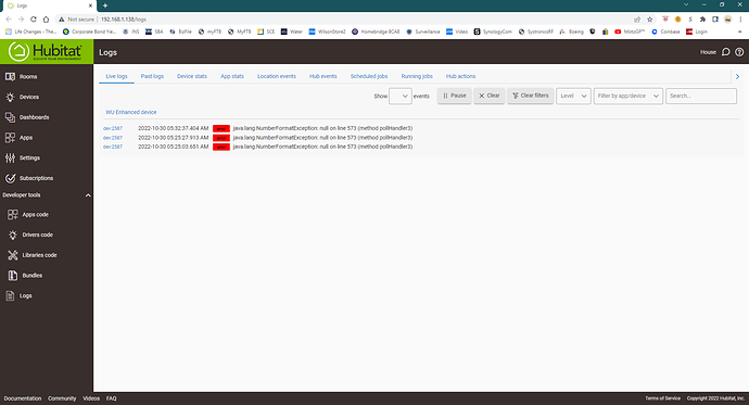

Thought I finally had this thing running, but.... Getting the following error in logs
dev:4042022-10-26 04:50:02.002 PMerrorgroovy.lang.GroovyRuntimeException: Ambiguous method overloading for method java.lang.Long#minus.
Cannot resolve which method to invoke for [null] due to overlapping prototypes between:
[class java.lang.Character]
[class java.lang.Number] on line 248 (method poll)
dev:4042022-10-25 07:28:16.779 PMerrorgroovy.lang.GroovyRuntimeException: Ambiguous method overloading for method java.lang.Long#minus.
Any ideas? My Lat and Long look good in settings. I have no problem reconciling them in google maps.
What is also funny, it polled data one time. Has not polled successfully since.

Are you using your own PWS or another site? After reviewing the log you sent, this look as if the Station ID is not reporting rain. Can you switch to another station if you are not using your own PWS, or can you get rain values from your PWS.
I don't know enough about the PWS devices and if some don't have rain gauges. If they don't then I will need to make the rain history optional in settings.
