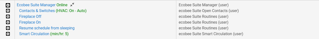

My question about child apps though is about the helper apps that you setup as part of Ecobee Suites. See my list below.
There is no doubt that Ecobee uses resources, but I wouldn't expect it to kill the hub.

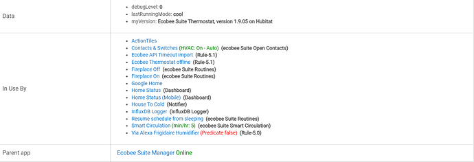

I would also be curious to know what apps are attached to the thermostat and the sensors. You can look at the bottom of the device page and it would look something like this.
It would be interesting to know if you had a bunch of stuff other then your Ecobeee Suite helper apps listed.

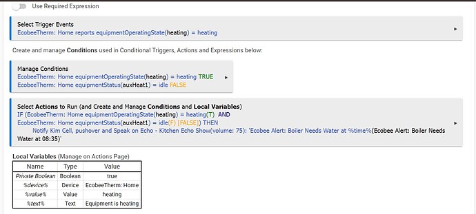

I am trying to set-up a rule that notifies me when the boiler is offline (out of water). Ecobee doesn't seem to have a notification when the boiler is offline. Equipment status doesn't seem to get updated frequently. I have polling at 3 minutes.
This is what I show for equipment updated - it's 9:26 now.
  • equipUpdated : 2023-11-05 08:21:08
  • equipmentOperatingState : idle
  • equipmentStatus : idle

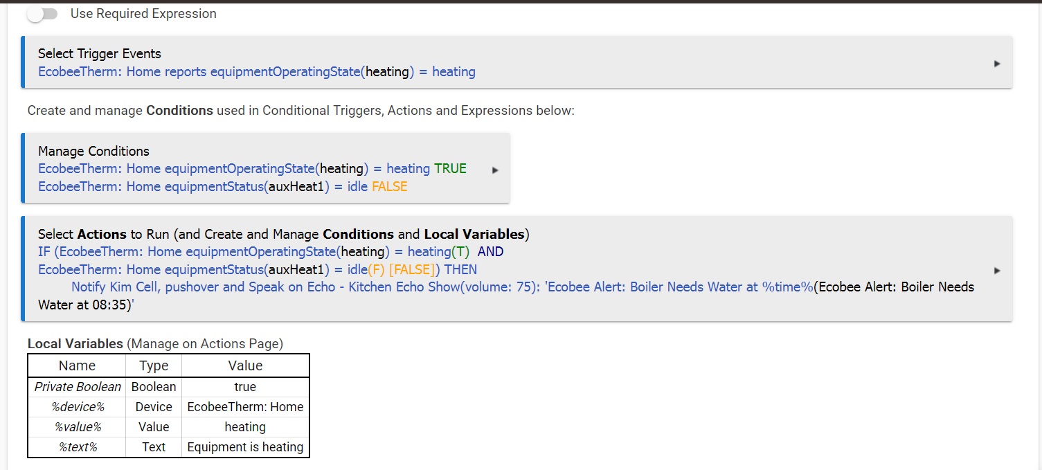

I tried this but it keeps going to idle even through I had put in offline.
I am not sure what I need to get this to work.

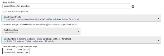

I am fairly certain that Ecobee only reports offline when it loses the connection between the thermostat and the cloud servers for whatever reason (e.g., power outage, network outage, etc.). I don't think there is anything that reports that the HVAC itself has shut down, unless the thermostat is powered by the HVAC system. In the above case, does the thermostat have any display, or is the screen black?
Also, you will need to run poll cycles every minute if you are going to test if it stays off for a minute (the value can only change during a poll cycle). I suggest 1 minute cycles, and then you test if it stays offline for 2 or 3 minutes...
I tried this rule with 1 minute polling. I tested by turning up the heat and shutting off the boiler. The equipment status didn't change to idle after 20 minutes. EquipUpdated doesn't seem to update with polling which would update the rule.
Right now, I have C on a transformer because we have only 2 wires (W1 and RH) going to the boiler. I might be able to come up with a better solution once we rewire to add the C wire. At least I hope I can.
yeah - with a dedicated transformer, the thermostat will never be able to report "offline" due to power loss. It doesn't know that the boiler is off, because it (the thermostat) still has power.
You might consider using a relay connected to the boiler power (24VAC probably), and the other side connected to (for example) the contact sensor leads on an Ecolink z-wave contact sensor (like this one), and then building a Rule that uses this as it's trigger event...
