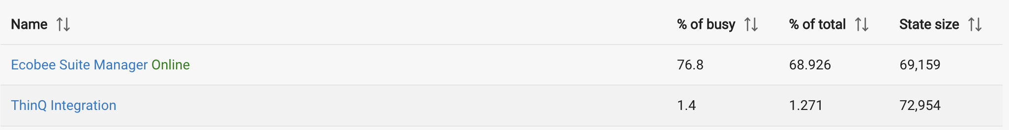

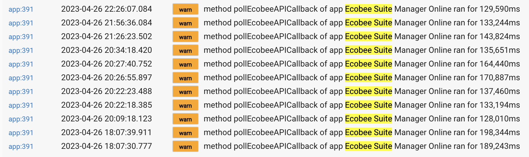

Thanks for the reply. Using the 1-min poll time only worked temporarily.
Now the hub is back to ~ 70% of uptime being used by this plugin and Hubitat keeps telling me that hub load is severe.
Any tips to optimize or profile?

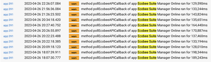

The logs show that each poll takes 3 minutes

Wow - something definitely is wrong for your installation.
Please turn on Log Level 4 (In ES Manager Preferences) and PM me a snippet of a complete cycle or two...
FWIW, that doesn't necessarily mean anything is wrong. Here's my own stats:
Local apps: 1h 33m 2s / 2d 19h 44m 26s total (2.3%)
Name Total, ms Count Avg, ms % of busy % of total State size
Ecobee Suite Manager Online 4,081,559 6,330 645 73.1 1.674 23,891
Notice that local apps are busy only 2.3% of wall clock time, so ESManager being 73.1% of 2.3% means that it is only was "busy" for 1.64% of wall clock time. This is well within the CPU capabilities of a Hubitat Hub.
Thanks for the info! I'll log some info and report back!
In my case, Ecobee Suite Manager is 68% of total! If I understand this correctly, it means it is busy ~16 hours every day. Your number looks a lot better since it's only 1.64% of wall clock.
FWIW, it returns to a low percentage after I reboot but hubitat becomes slow and unresponsive after a few days.

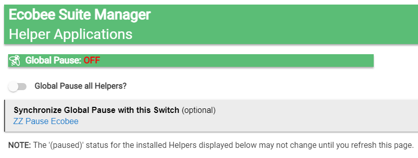

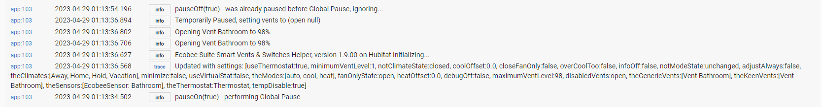

I have been using Ecobee Suite for a while now and have loved it. Recently I started using the optional "Synchronize Global Pause with this switch" feature.
The only helpers I use are the "Mode\Switches\Program" Helper and the "Smart Vent & Switches" Helper.

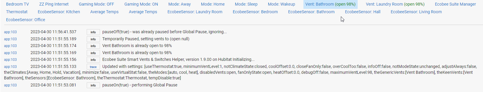

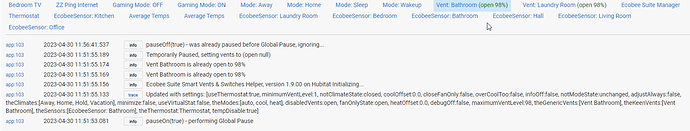

When turning on the virtual switch I am using to sync global pause (ZZ Pause Ecobee) it works and pauses all helpers I am using. However when I turn it back off, it will unpause all of the Mode Helpers but I can never get it to unpause either of the two Vent Helpers I am using. I am seeing in the logs:

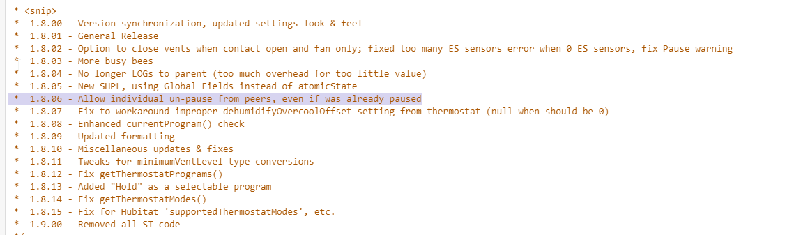

Is this a bug in this particular helper or am I missing something? I saw in your changelogs in the Smart Vents helper code (the line i have highlighted in purple) and am wondering what this means
Thanks in advance for any help.
Try manually unpausing both the Vent helpers, then turn on Global Pause, wait a few minutes, then Global Unpause and then check the logs for the Helpers. It won't un-pause if they were previously paused when the Global Pause was turned on.
Let me know if it isn't un-pausing when the Helpers weren't paused when the Global Pause was started...

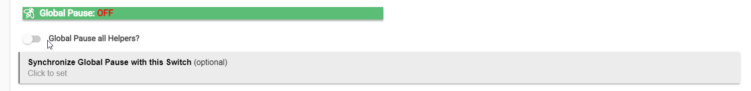

Thank you sir. I tried it. I made sure the Global Pause slider was off, went into each helper and turned off the "Pause this helper" slider. Waited a few minutes. Turned on the Global Pause slider, verified all helpers were showing as paused. I then waited five minutes and turned off the Global pause slider. All helpers except the vent helpers would unpause. The only way I can get the vent helpers to unpause is to go into each vent helper and manually turn off "Pause this helper"
I did remove the virtual switch from the optional "Synchronize Global Pause with this Switch" setting to eliminate any issues with that
Thanks again.
PS I have remote admin and a guest account if you want to look at it yourself, DM me and I will shoot you the credentials.
