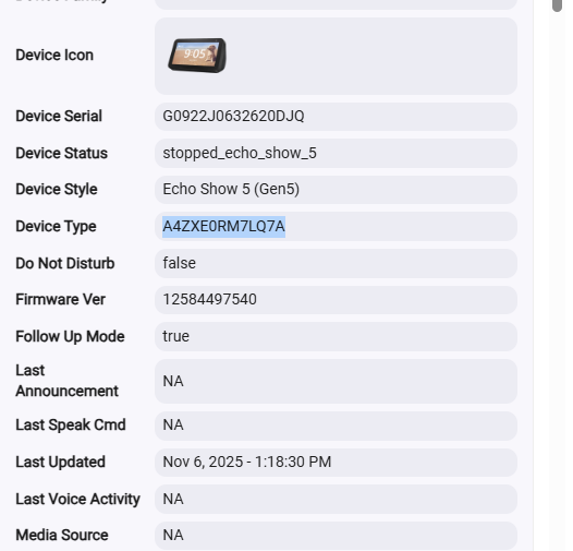

I have a 5th gen Echo dot but it shows up as a echo show 5th gen. I assume it uses the device type parameter to set this. The device type it returns is A4ZXE0RM7LQ7A, which is listed as a 5th gen echo show in the echo speaks app code. I saw in the change log the quoted line below. @jtp10181 is the device type wrong or is there something I need to do to get it updated? The device is working fine. I seem to remember there was some discussion in this thread about this, but I couldn't find it, it's quite a bit of stuff to look through.

[Edit]I have removed the device and let echo speaks re discover it but it comes back as the same thing.
I have no idea why I got tagged on that notes line, it was someone else who added it. I am the one who added the Heroku url override to get that working again.

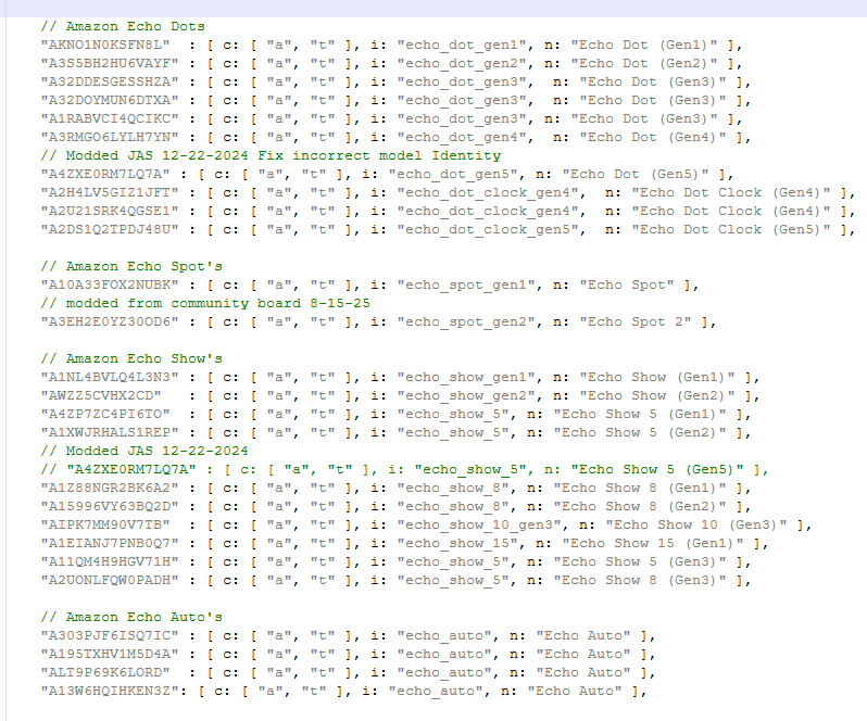

Anyway... I guess someone just got it wrong in the code, its here:
I had found it in the code, but I was unsure of exactly how that was determined. So I guess I can just change the description on that line?
I would go for it, if anything goes sideways just run a repair in HPM.
Yeah that's what I did and it seems to have worked. I linked to the Echo Dot 4th gen picture as there doesn't seem to be a listing for the 5th gen. It works though.
this is a regression bug to me. I had forked and was managing devices, icons and music play stuff for myself as it felt like the app wasn't getting love. Then a recent resurgence - I upl'd my graphics and stuff to help filter this out - here is my sections from a year ago - which also includes a notation about someone else discovering a new device, and a unit incorrectly described in the Echo Spots as a gen 1 when it is a Gen 2

@tonesto7 PR sent. I included images and some updates to the device tables.

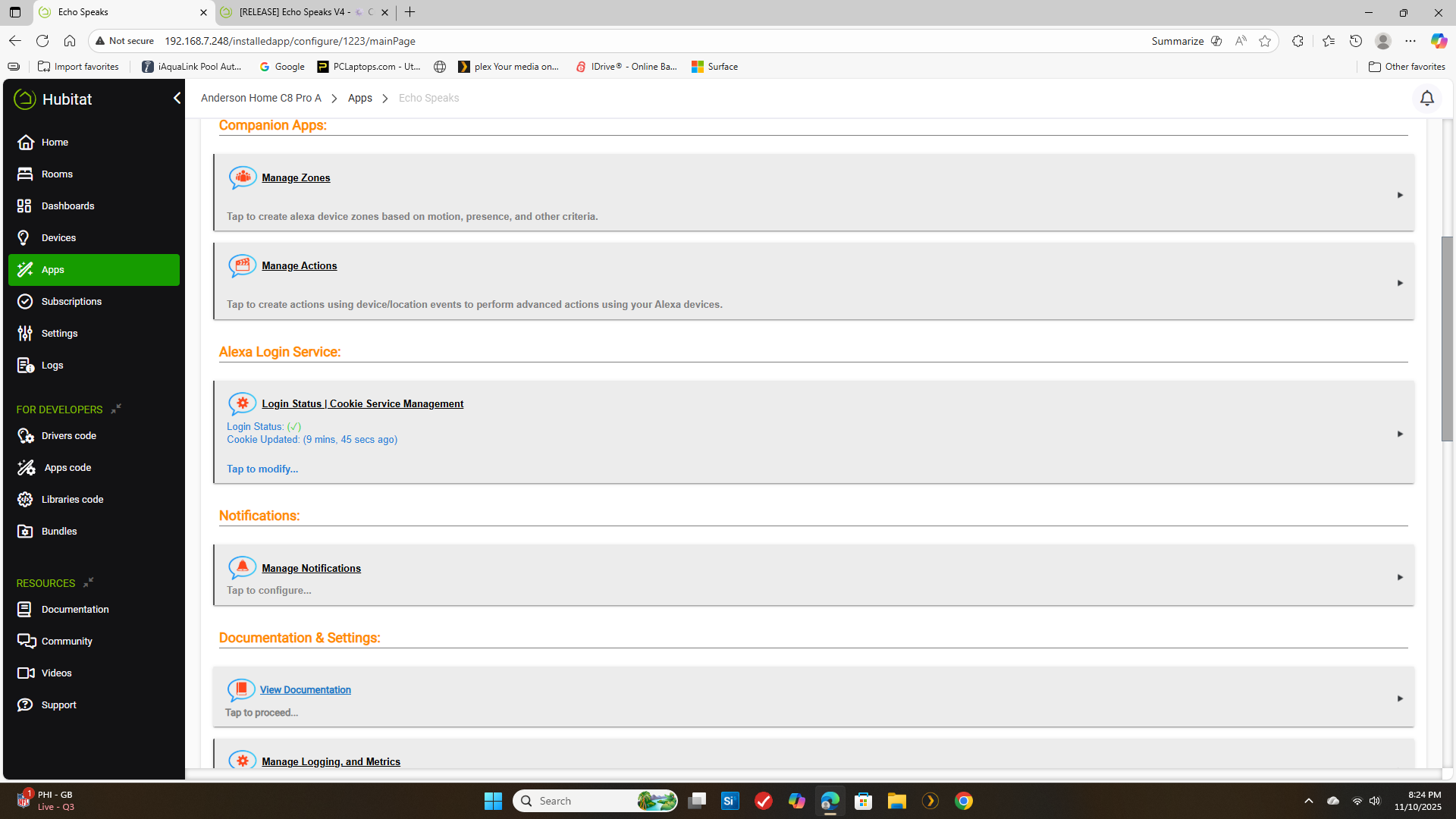

Echo Speaks seems to be working fine. I am using a local server that @jtp10181 helped me set-up several years ago. The app seems to retrieve the needed cookie but I'm getting errors in the logs and also have the Red X on the Auth Status but all other check marks are green.
Any thoughts on what may be wrong?

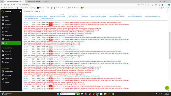

Hi has anyone had this issue with deploying a container for the echo speaks cookie. I cannot seem to get past it,
It all states that it authenticates in i get the successful cookie message and then it redirects me back to the same page where it says login again. I have been going through the logs and i find this under the NPM logs

@john022662k have you tried restarting the cookie server container?
@benmoore1991 have you tried this from my guide? (click the link to see the full post)
