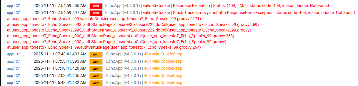

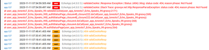

Something seems to have changed on Amazon side of things. I now also see this in my app and logs. Never had an issue before and Echo Speaks is working properly.
It seems that per the error, and looking at the corresponding lines in the app code, the app no longer seems to like the response returned for the cookie auth status.
@tonesto7 perhaps you can take a look at things when you have a moment?

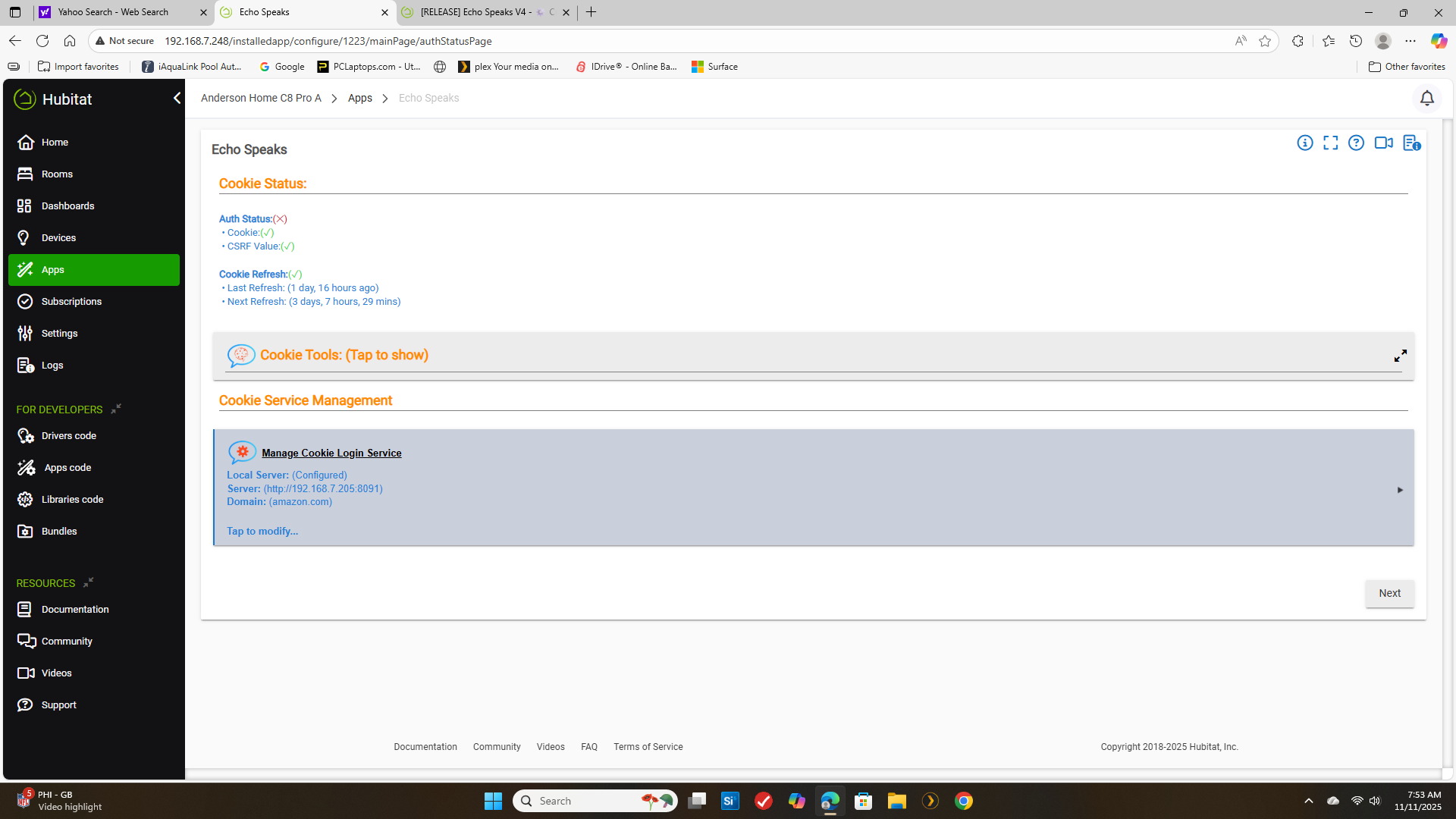

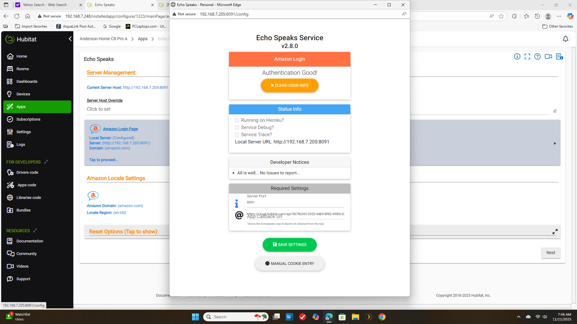

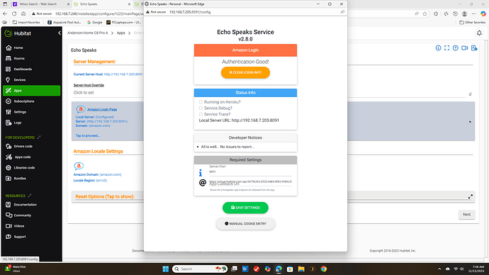

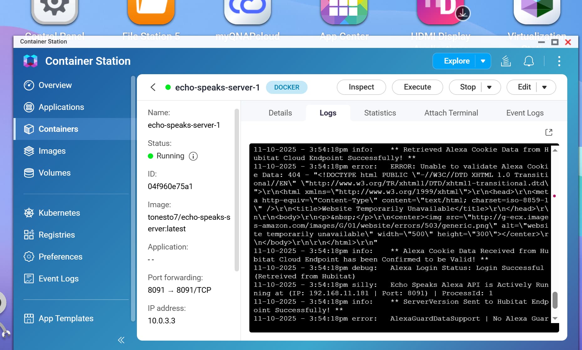

@jtp10181 ... I've restarted the container, and at the end of the text run of the container it states the cookie was sent successfully. However, the red X on the Auth Status does not go away. It looks like @jkudave is having the same problem.
I think there may be something going on with the Amazon side that is not allowing the app to work nicely with Amazon.

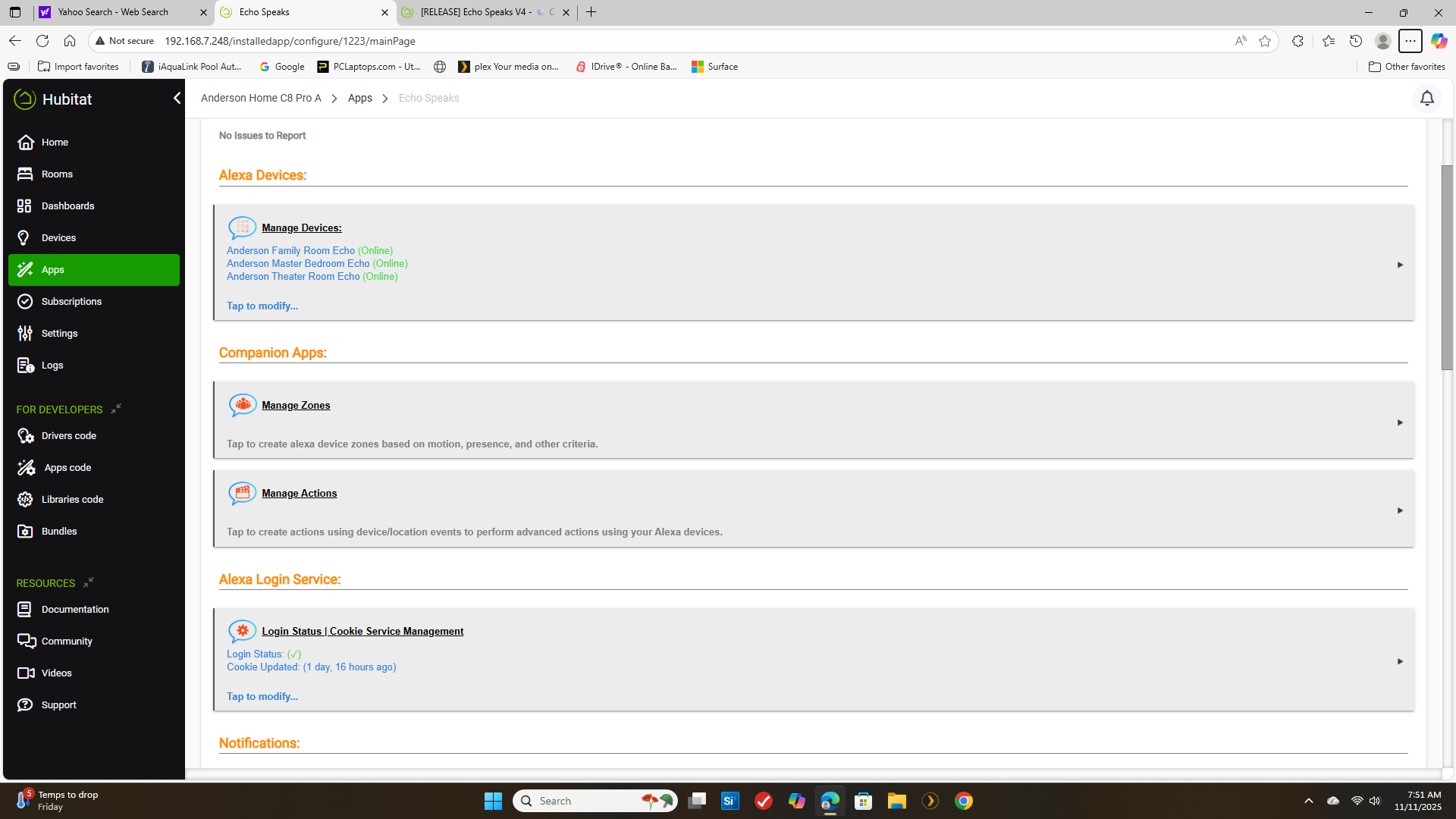

Below is a screenshot of the Amazon Page. Should I try to clear login status and try again?

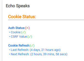

Everything on the page of the app looks good
But still the red X on this page of the app

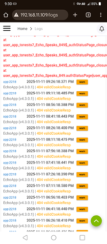

Seeing same thing on mine.
You aren’t doing anything wrong. This appears to be something new on Amazon’s side of things. If things are working, leave them be. Either it will get sorted on its own, or @tonesto7 will need to take a look when time permits.

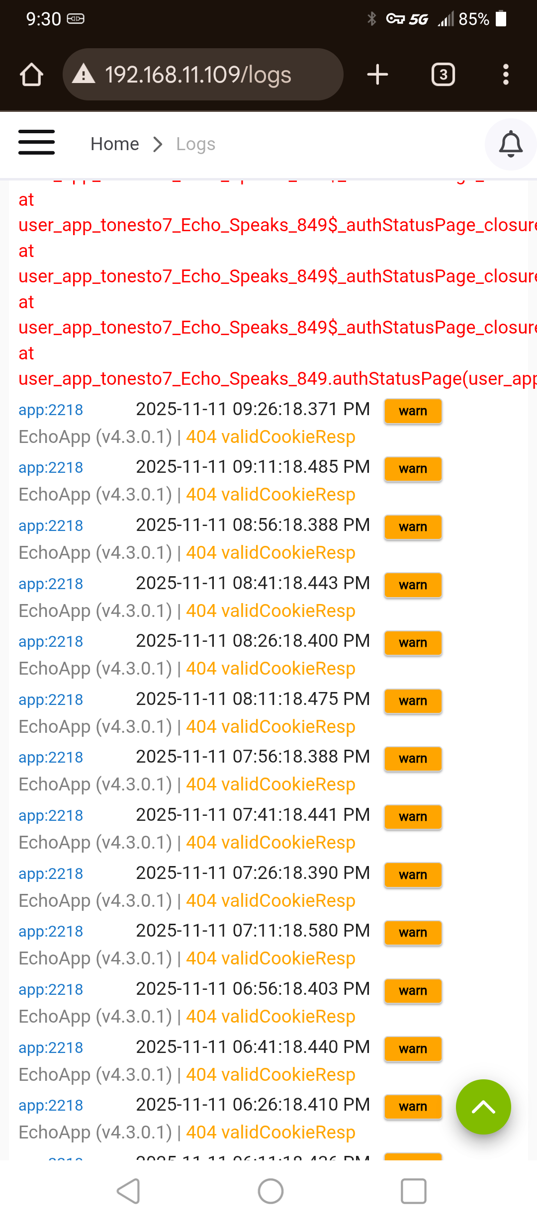

weird it stays in the server logs it got the cookie but cannot validate it.. 404 error .. not sure what it does to validate but it seems the url has changed.. wonder if it is the alexa plus crap?

Only @tonesto7 can answer that. However, it seems that cookie refreshes are successful despite this error/warning.
You are correct. My last cookie update does show 1 day 1 hour and I have been getting the error since 11/6.

I wouldn't worry too much about this. Cookies are being refreshed and the app continues to work. It's just a matter of the authorization health status in the app not working. It's more of a cosmetic check than anything else, as far as I can tell. I don't know if anyone other than @tonesto7 can fix this, and it's essentially up to him to be able to find the time to address the issue. My take is that at some point, sooner than later, the ES app will need a bit of a re-write.
