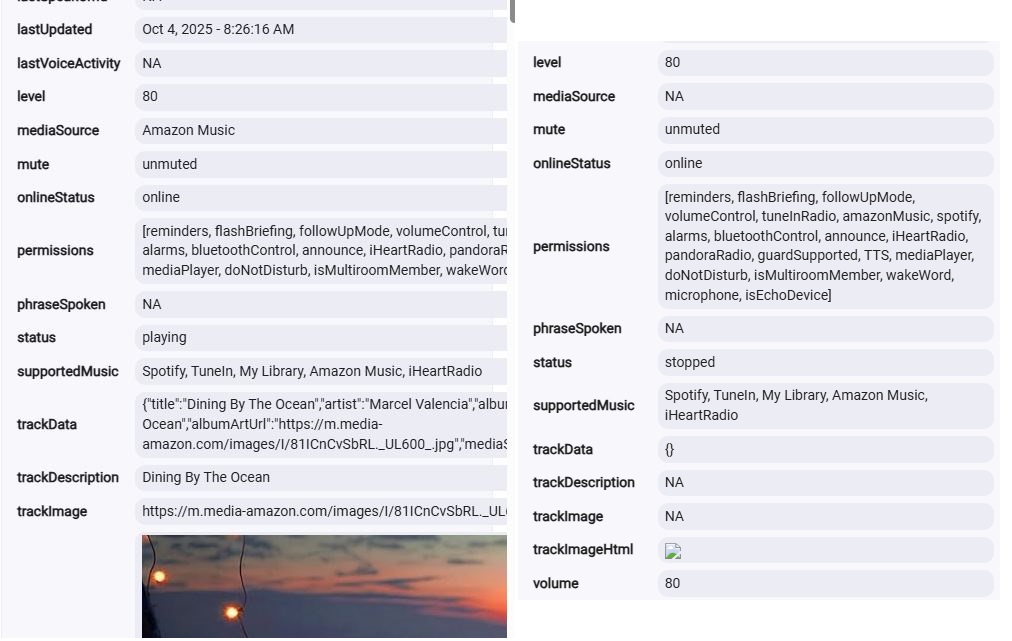

Hi,
I would like a validation here.
Track info are not working for me but only in Spotify. I tried Amazon Music, Iheart and TuneIn and everything is working great. In Spotify, track infos are all NA and the echo status swtich to stopped, even if the echo is playing. Track data are all ok within the Echo App..
Image is with Amazon Music playing on the left and Spotify playing on the right.
Is anyone else experiencing the same behavior?
Thanks!

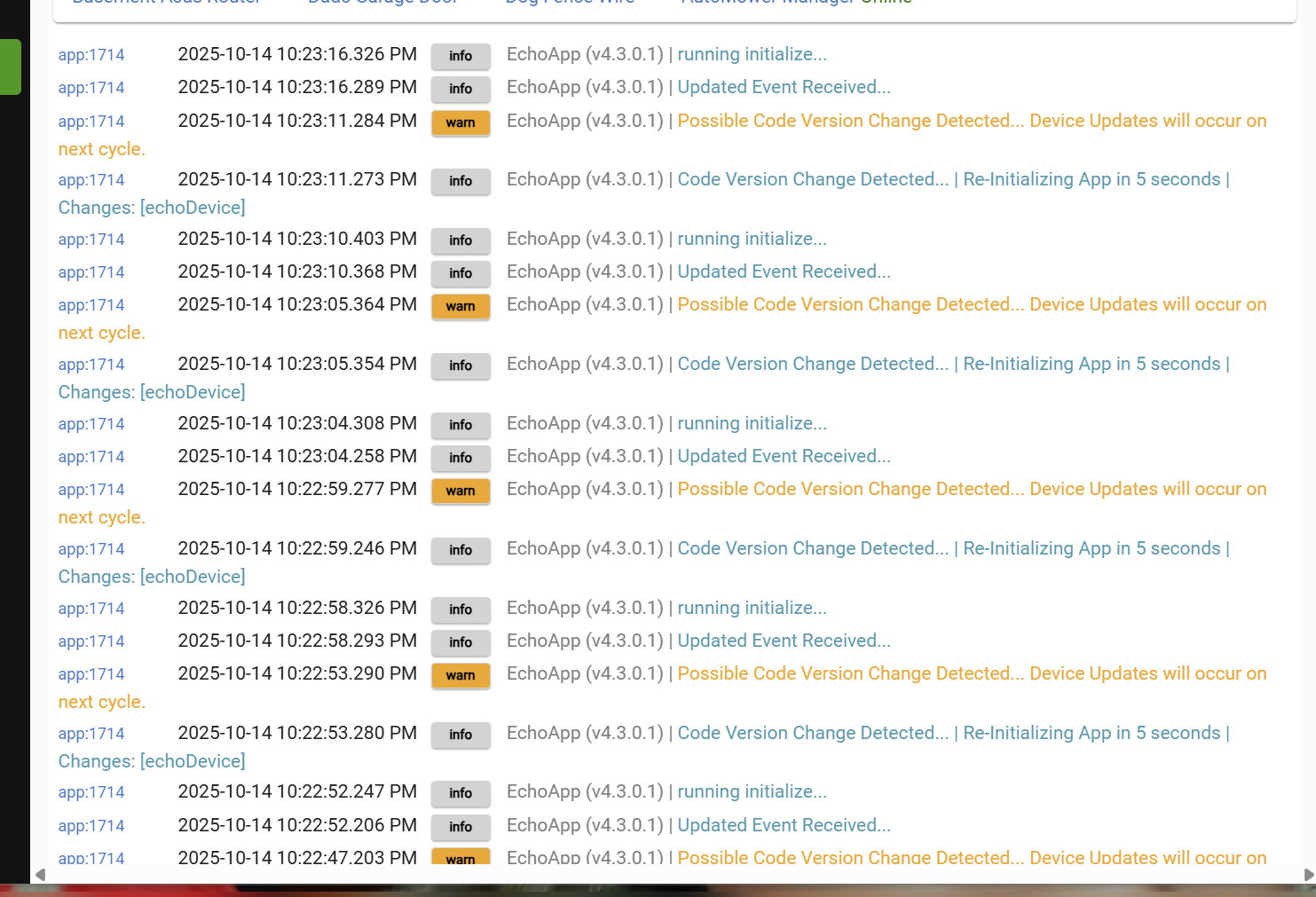

echo speaks suddenly going in endless loop in logs since last fw update

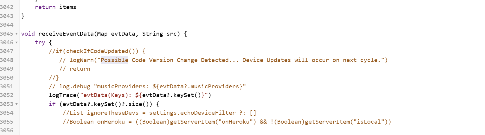

had to comment out the lines

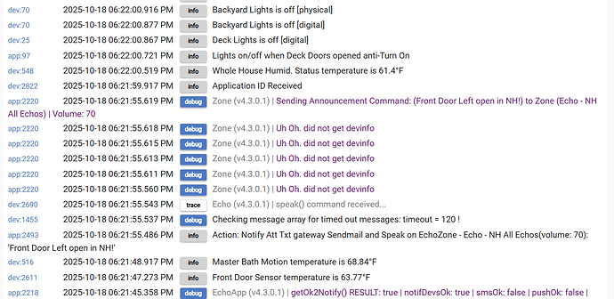

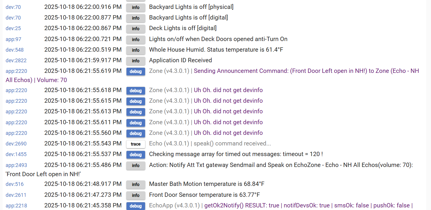

not working anylonger in nh.. just got back home . i can play via the test command or the send message on the device panel but through the hubitat notifications nothing plays and it looks like it is not getting passed to the child devices.. i turn on all logging and all i get is this..
This is the same thing I was seeing a few weeks ago.
Rechecked my echo speaks log and it’s still happening :man_shrugging:.

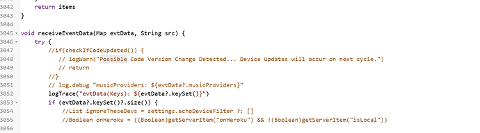

i did get it working again... i had to comment out those lines now on both of my hubs to and reinitialze to stop it..
ie
this now on the second hub i use echo speaks.. so i think the issue is if you make any changes and select done.. unless you comment out those lines it goes in an endless loop..
as for the other issue why nothing was playing.. i think it is not liking some devices disabled.

it may not be helpfull to you but it is to me and others as otherwis4e when init. is run the app goes in an endless loop.. test it.
