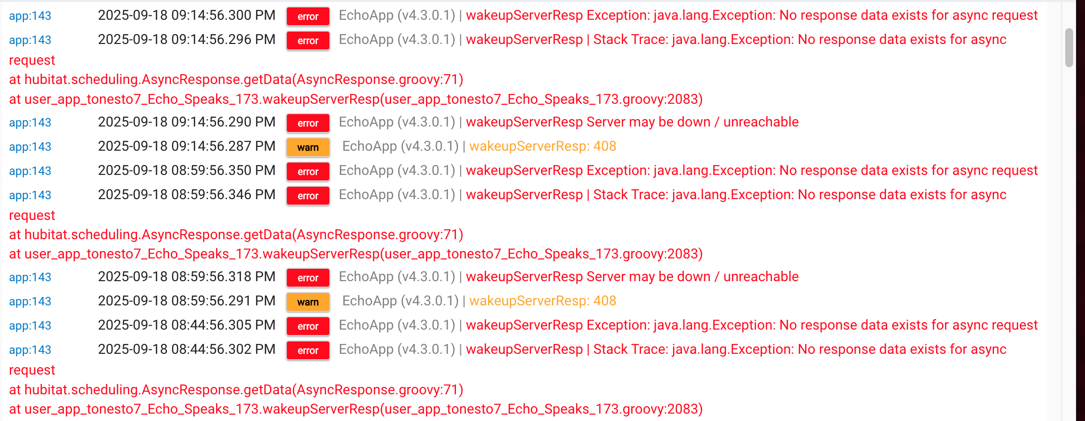

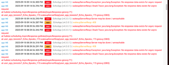

Not sure if this will help you but I had some 408s after updating. I went back in to HPM and checked for updates and it showed ES had updates still. I updated again opened ES and that seemed to have stopped the errors.
I'm fully updated thanks.
Are you seeing this on multiple devices? If yes is it specific to a certain echo device model?
It doesn't seem to be tied to a specific device. My Echo devices themselves do not show any warnings in the logs. What I see is from the app.
All of my Echo devices show online in the app.
I have a mix of Echo Dots, an Echo Spot and an Echo Show.
I only noticed these 408 errors after updating to the latest version.
The 408 warnings may have stopped after my last hub update and reboot.
I’ll post back if they start up again.

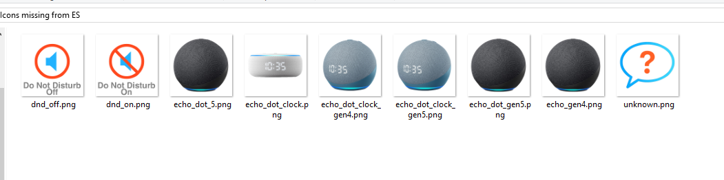

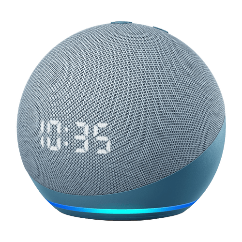

I'm happy to see ES get some love. It feels like it's been a long time. I forked this app and began cleaning somethings for myself - I've switched it back to see if the inbound fixes improve my environment.

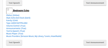

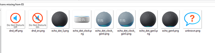

I had fixed the playback, icons and playlist stuff - here are the icons I made or use in case they are helpful
Here are a few more _ comm only lets you upload 5 images at a swipe.

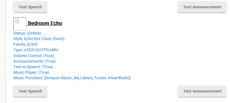

I get errors on my dashboards for missing icons - and in the app:
I'm happy to zip them and make them avail - they are also on my Git.
I noticed the names get changed on the copy paste - here's the exact names they need:

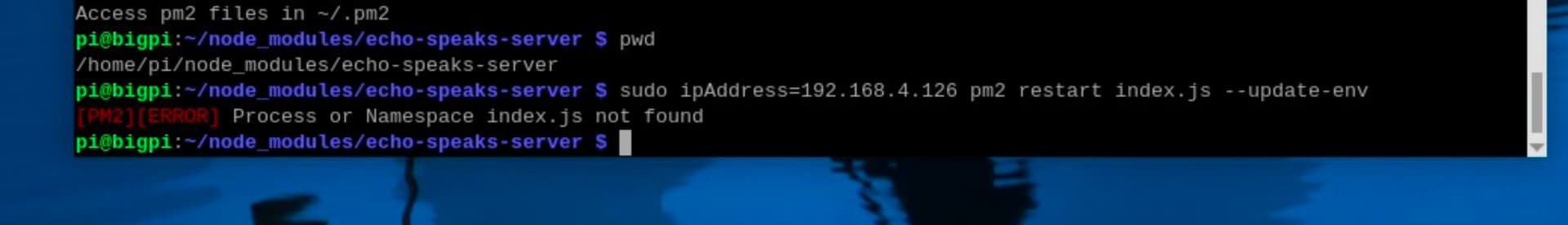

My cookie server has lost its brain again and is showing the wrong IP address. The fix a few years ago was to run a pm2 command and it fixed it. Now I get an error. And I admit I have no idea what any of this does so I'm at a loss to troubleshoot.
Any hints would be gratefully accepted. I really wonder if there's an easier what that this stupid cookie server on my Raspberry pi... Thanks!
I’m using docker so not really sure but maybe this will help you:
You need to do a pm2 list to get the name of the process in pm2, it is saying it doesn't know what index.js is, so maybe it is named something else.
