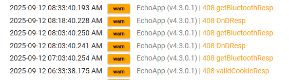

I am seeing this in my logs after updating to the latest version:
Hub is connected to the Internet as are all of my Echo devices. No issues on that end.

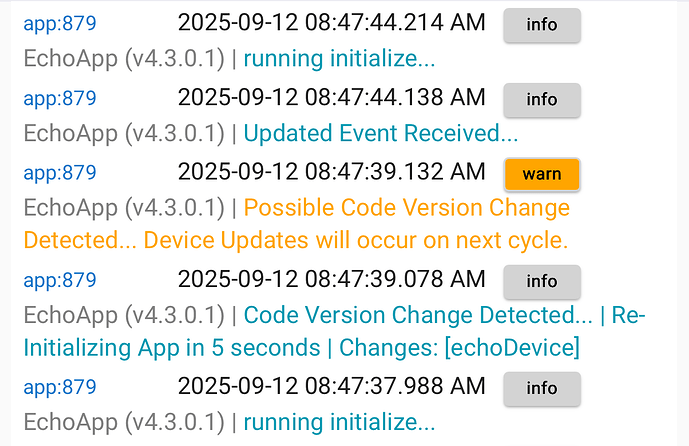

I’m seeing this sequence of info/warn log entries that repeat frequently.
Have you opened the app since it was updated? With the two apps from this dev I have found it good to open the app after updating, click done. Then open again and click done. This seems to get everything to sync up.
Opening it will force all the child apps and devices to run initialize() and report there version back to the main app. It will eventually run it on it's own with the healthcheck
I know this wasn't in response to me, but yes I have.
My other warnings seem to have cleared, but I still see this one @tonesto7

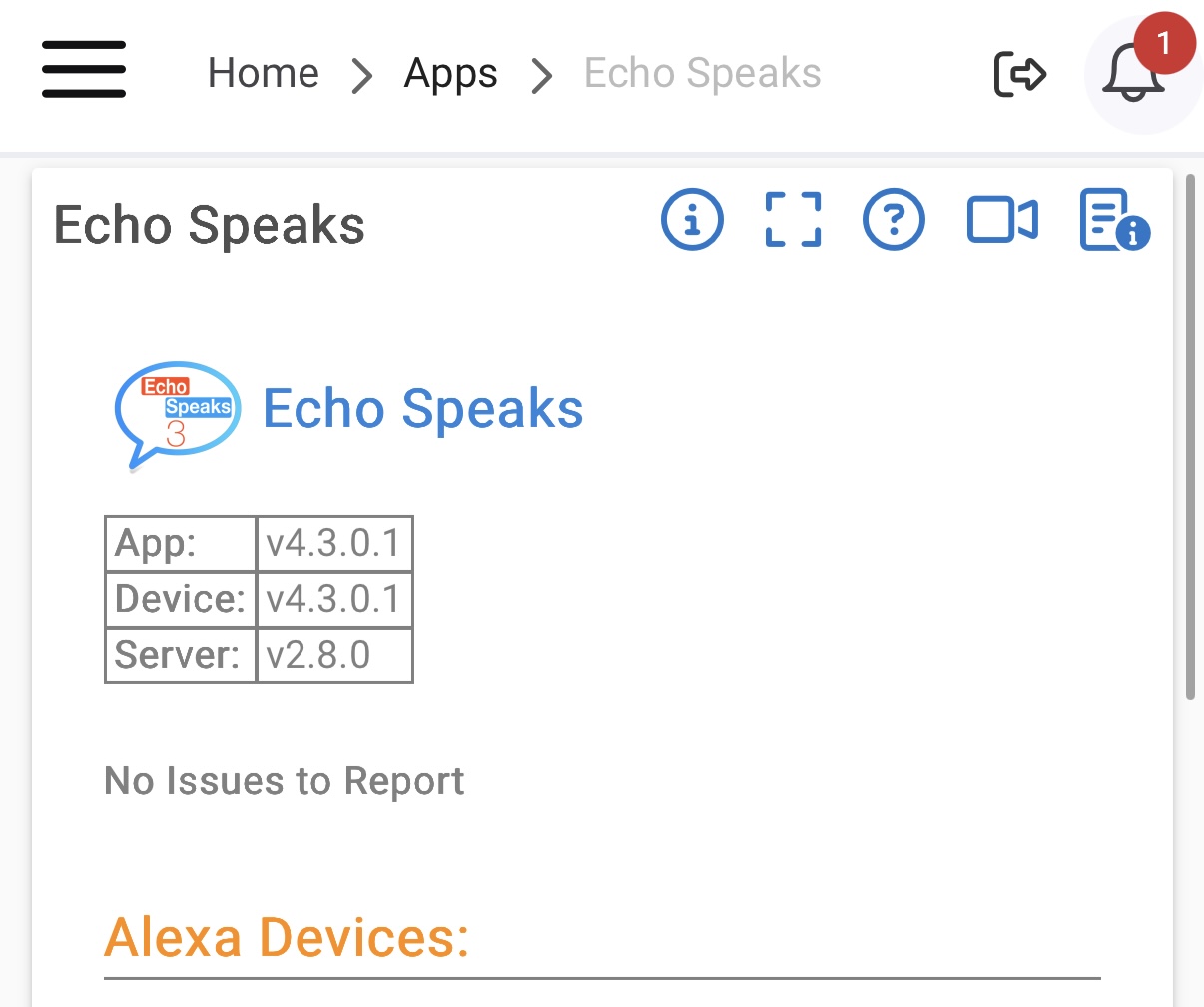

Make sure the device driver code actually updated
I didn't make any changes to those areas of the code... I feel like that warning has existed for years. I will investigate it when i get some time. I really need to look at the latest apis available and update the app and devices
I appreciate the response @tonesto7 .
I've been running Echo Speaks for ages and am very aware of logs, etc. I have never seen these 408 errors at any time previously. Internet connectivity across the board is 100% OK in my environment.
Tried it one time, after noticing the log entries. Still occurring. Tried again like you mentioned, no change.

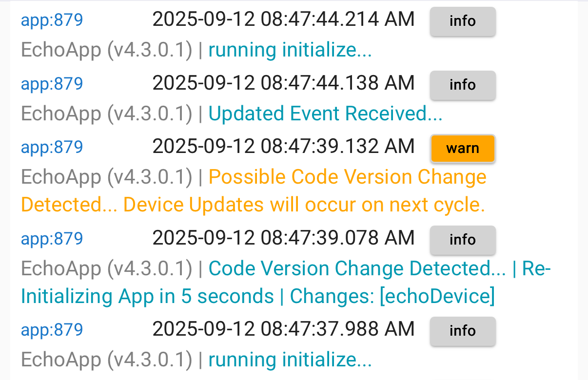

Think so?
I was wrong, other warnings seem to be coming back:
