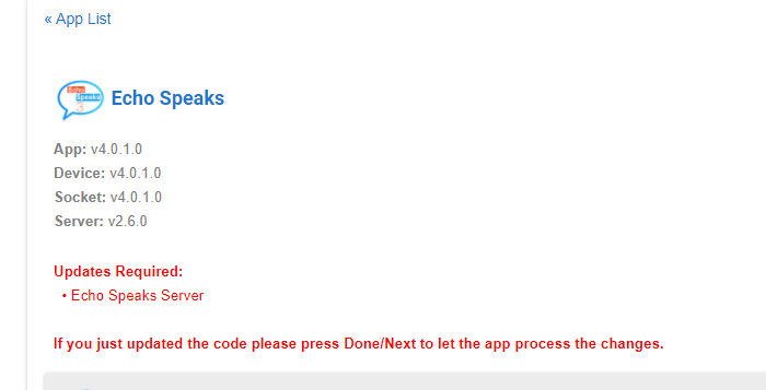

How do I update the server?
tonesto7.github.io
Install Options - Echo SpeaksDocumentation
Go to Updates, down to Server, follow the instructions.

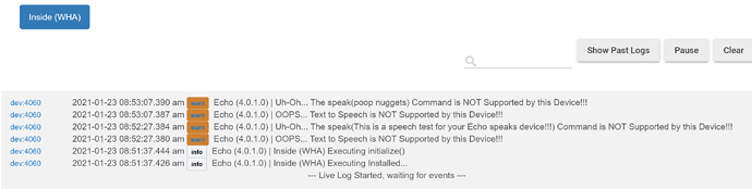

Any chance of getting Echo groups to work? The WHA devices are created, Echo Speaks sees them...
Having 6 Echos, I'm trying to avoid the popcorn affect with announcements or is there another way?
Amazon doesn't allow sending speech/announcements to WHA groups.
Well that's a bummer, any way to avoid the popcorn affect?

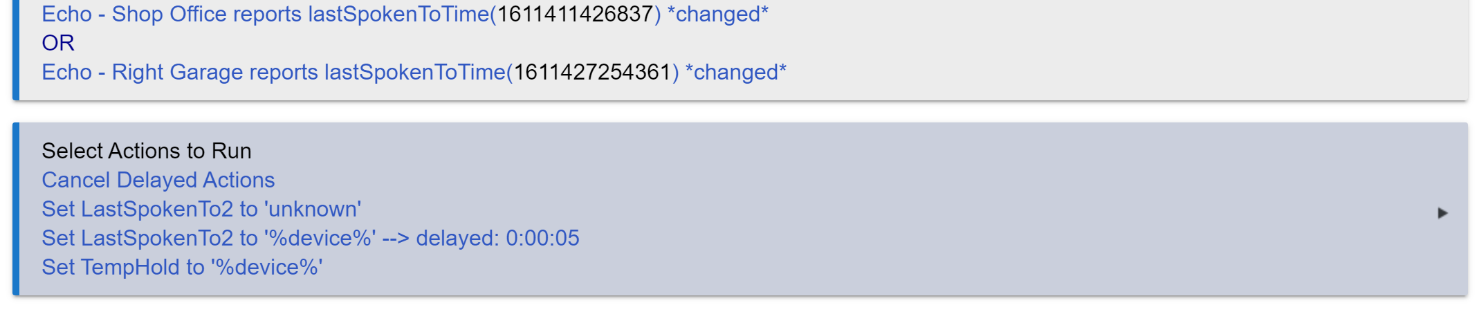

I have a rule that triggers off of device attribute lastspokenToTime and it no longer seems to work.
I used it to trigger a rule, indicating that was the last device spoken to and then saved that device into a global. Has been working great, now it will not trigger.

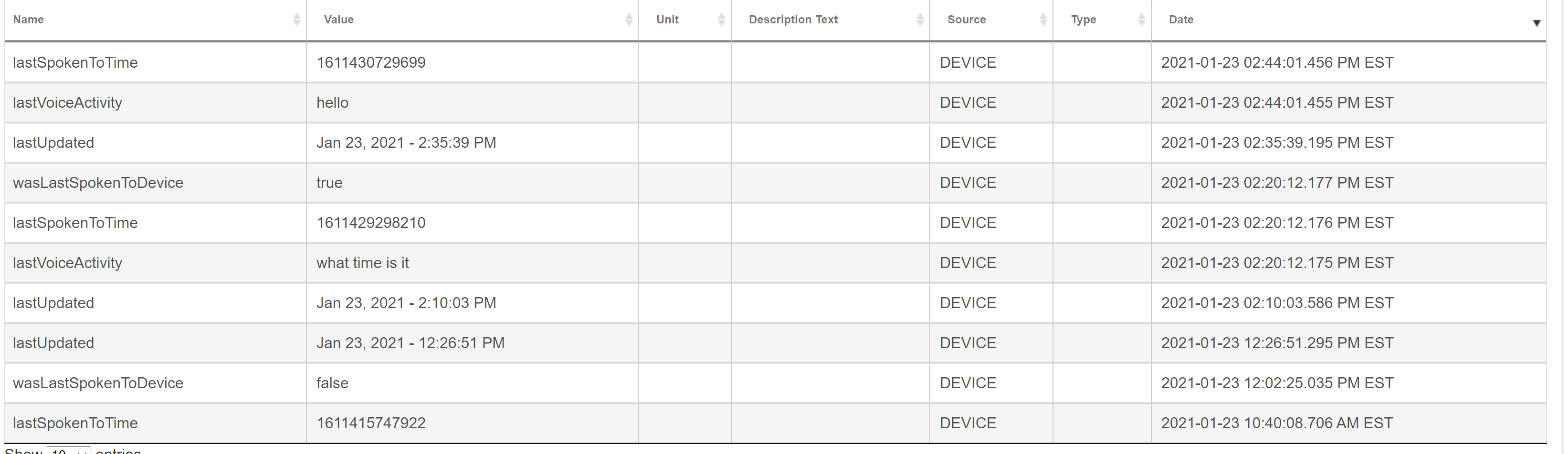

Just enabled the logs and asked the Echo in my office the time and said Hello. From the events page of the device you can see each action. There is nothing, however, on HE logs from the device
So I tried again because I realized I did not have on logging turned on in my RM rule. Then nothing happened. I got nothing in events or logs.
I then did a refresh after a minute or two of waiting and trying different phases. After the refresh the data updated for the device.
I then asked the echo the time again, and again nothing updated until I after I did a refresh.

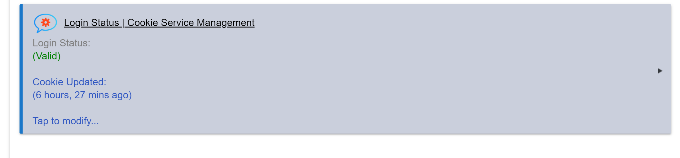

This says it is valid?
try clearing your auth and re-login again to see if it fixes it
I think that did it, I am getting tons for messages for the websocket now. Let me play a bit and we will see if everything is back to normal
