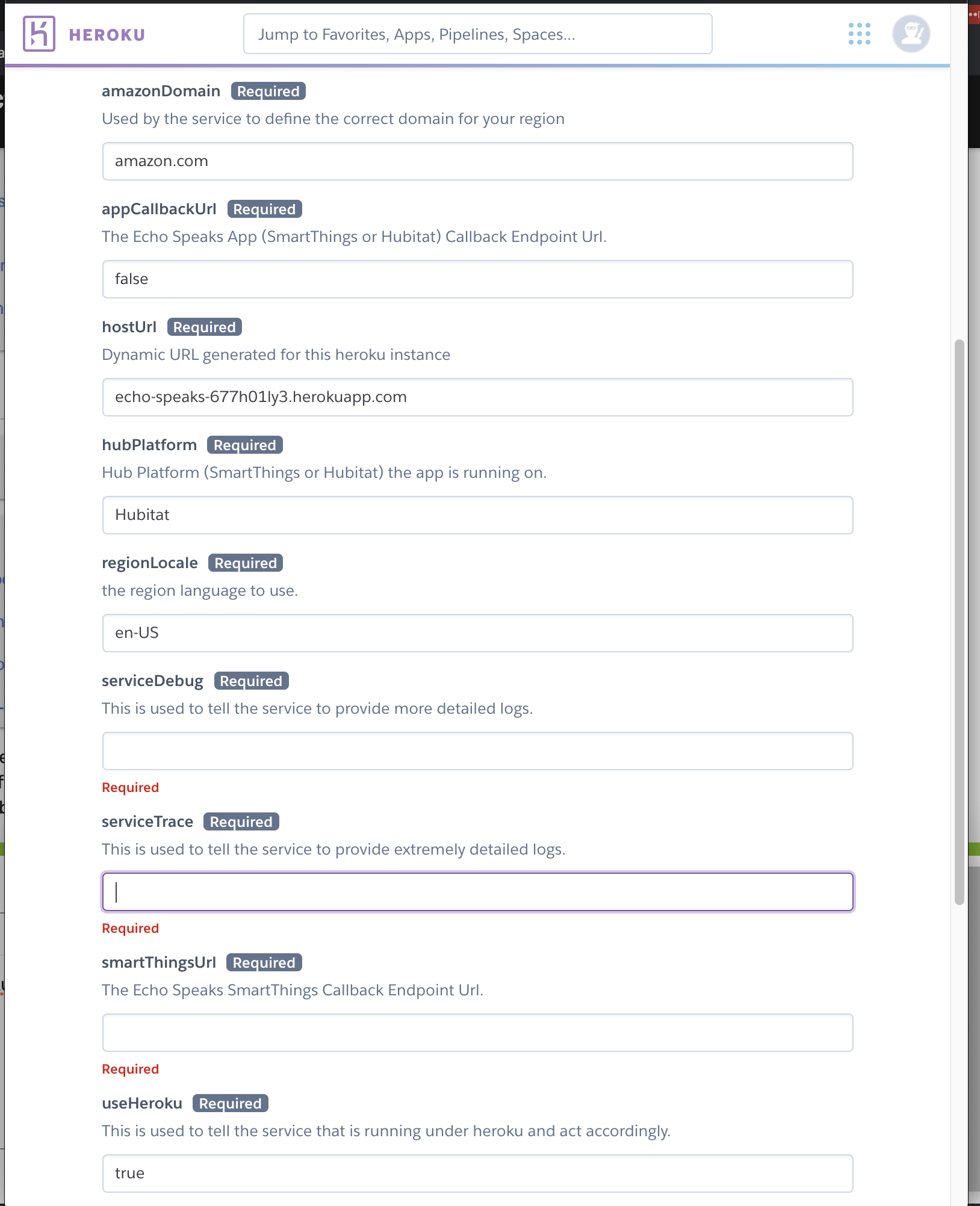

I'm trying to set this up on a new hub and when I try to create the app on Heroku its asking for information that I dont have. Any advice?
