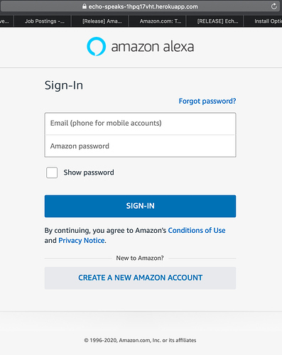

When I tried to link my Alexa account to HerokuApp I've got a page that looks exactly like Alexa's login page, but that was not the original page (see image). I've got worried, since I'd provide my Alexa's credentials for a third party. Why use a look alike page? Why not ask clearly for the credentials not impersonating Amazon's page? Should I not be worried? Well ... I'm. I'd like very much use this app, but ... no, I'll not.
It is the Alexa page. This is the OATH authentication between the Alexa servers and the Heroku servers. The Heroku servers do not get the Alexa login information just an expiring token. The token is renewed every 10 days (not sure of the time period).

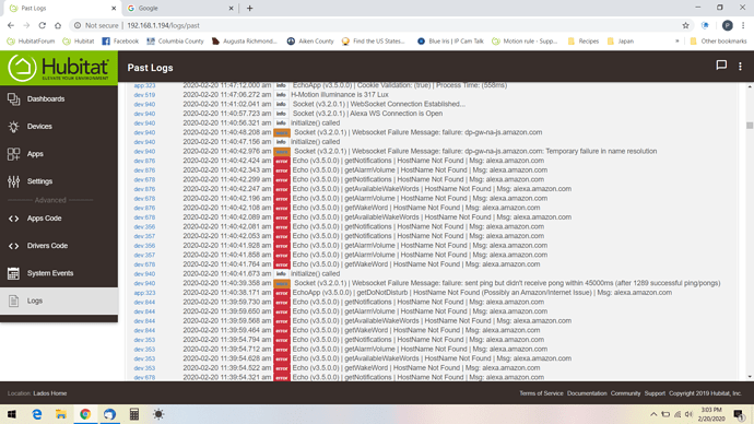

@lados I am getting the same "Hostname Not Found" | Msg: alexa.amazon.com continuously. I'm not sure what that's about. I do have ONE echo device Offline, one of about 9. Rebooting my hub to see if it makes it stop.
EDIT: adding more detail:
Rebooted hub, starts out like this (like 10 times)
Echo (v3.3.0.1) | getDeviceActivity | Status: (400) | Message: Bad Request | Data: [message:Rate exceeded]
Then:
Echo (v3.3.0.1) | getPlaybackState | HostName Not Found | Msg: alexa.amazon.com
Echo (v3.3.0.1) | getDeviceActivity | HostName Not Found | Msg: alexa.amazon.com
Echo (v3.3.0.1) | getPlaylists | HostName Not Found | Msg: alexa.amazon.com
nearly continuously... It really brings my hub to its knees.

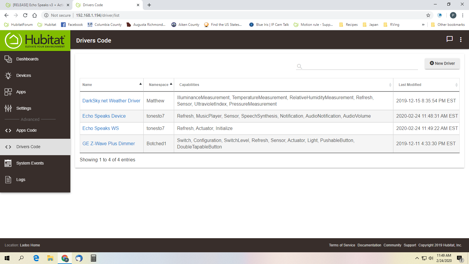

I have not been able to duplicate this :frowning:

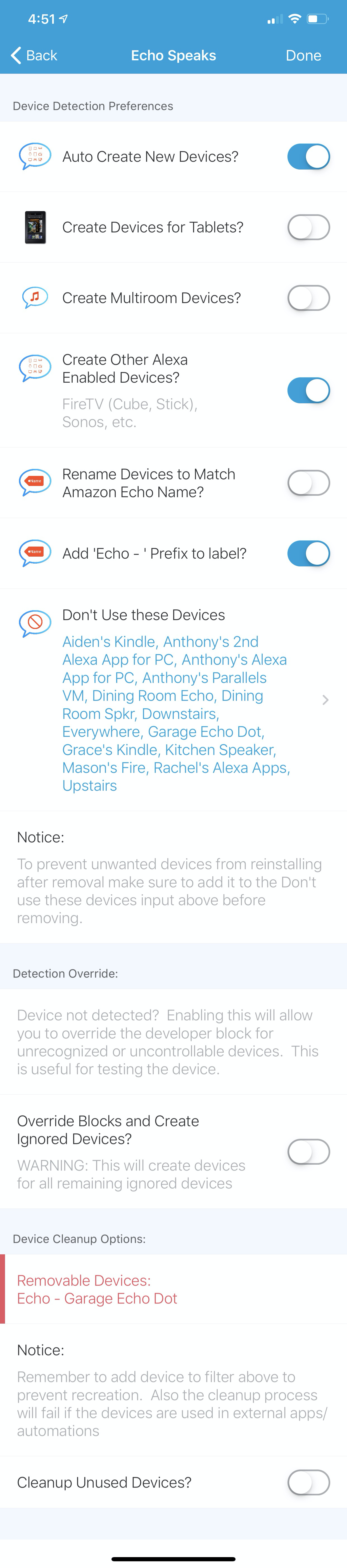

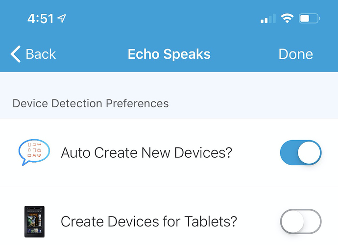

What are your device detection settings like?

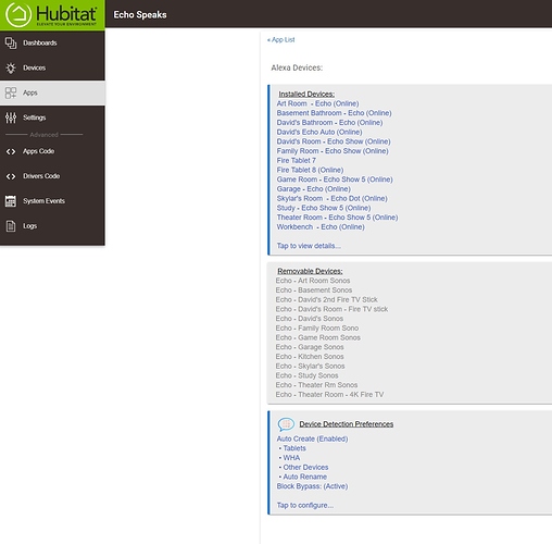

Can you send me a screenshot of the entire device detection prefs page?
Here is mine:

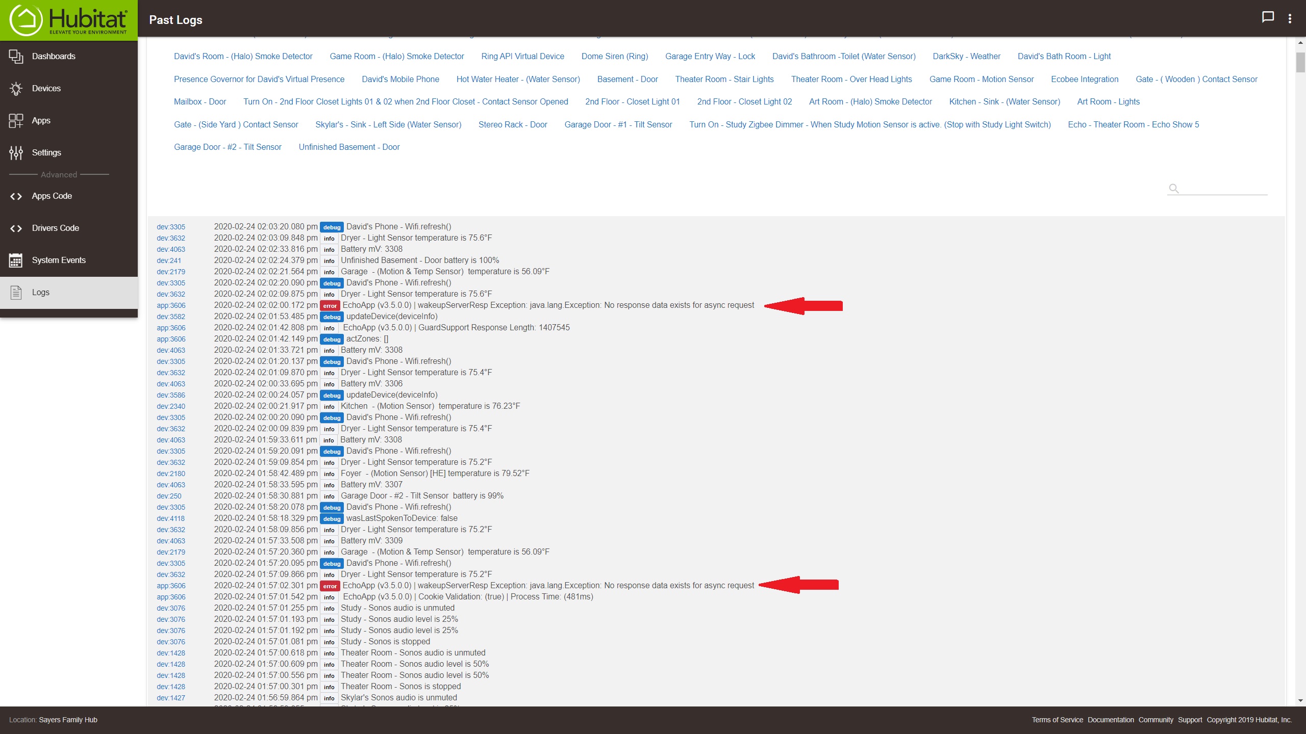

...and presto- new errors. Anyone else having similar errors? I'm pretty sure its effecting hub performance.

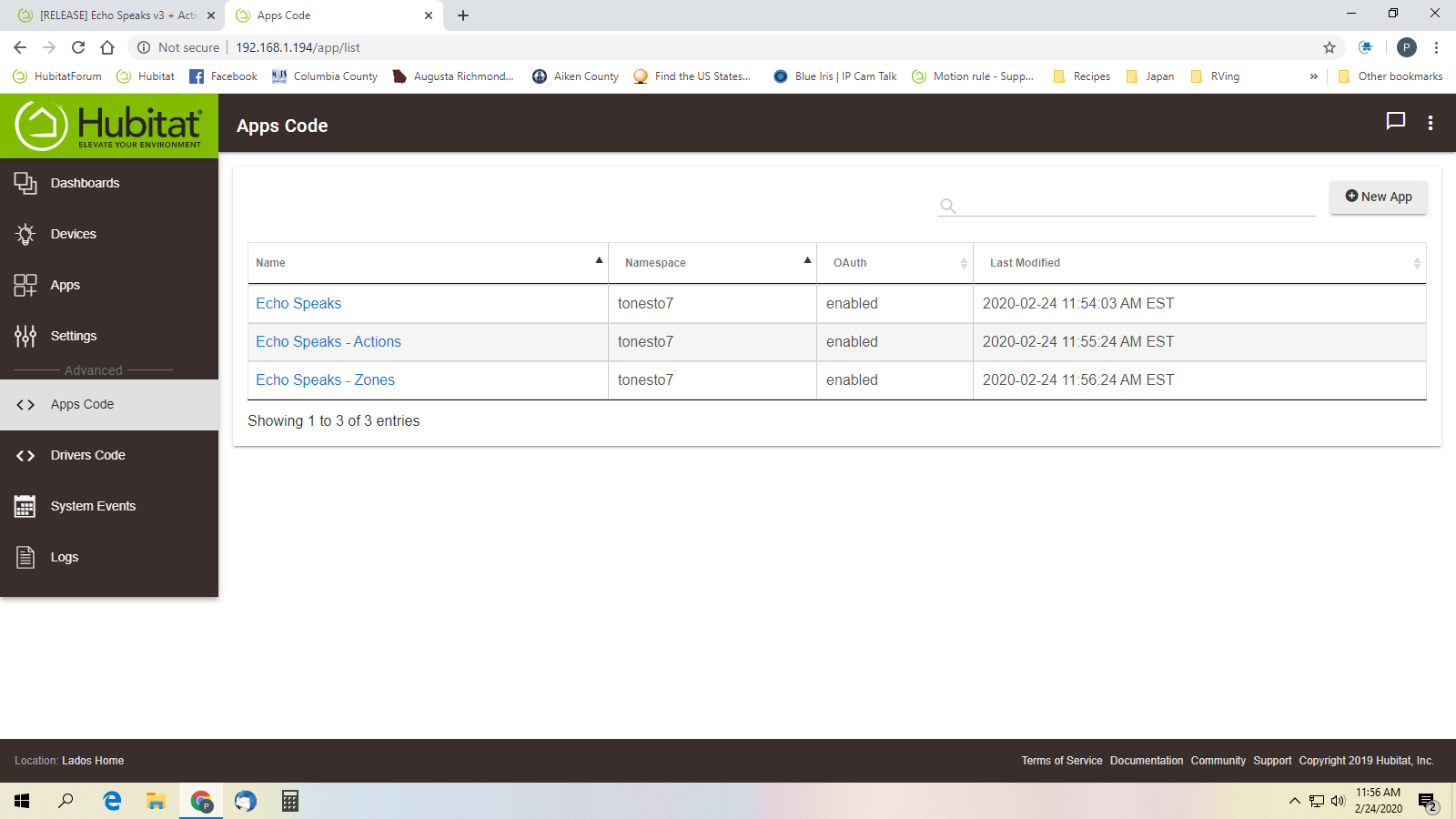

Make sure you are running the latest code.
I’m not sure how this weird loop only happens on Hubitat.
I’ve been trying to track it down on my side but can’t get it to happen on my 3 hubs

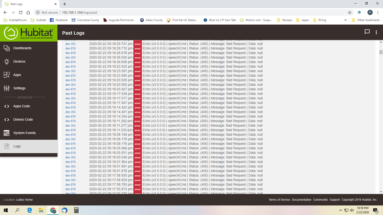

Continuing to get errors so I went back and reinstalled the ES device(s) and apps. Also reinstalled the Hubitat app. I'm going to reboot all the Alexa devices, network components and HE hub. ll monitor and update status. Thanks for trying to help- It is much appreciated.
No such luck... Still full of errors:

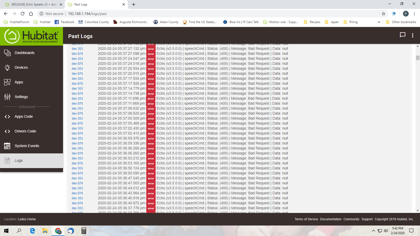

I installed the latest update (3.5.0.0) when it came out, and now we went down to only having one error about every 3 minutes (I believe).
A lot better then it was before!
I tried disabling several of my "echo devices" just to see if too many devices is the culprit. No impact- Anytime HE "speaks" through Echo Speaks, I get errors. I'm worse now than I ever been.
