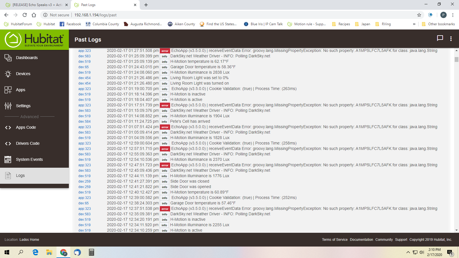

I've been getting this error.
I'm not sure why have attempted to research but haven't found anything yet.

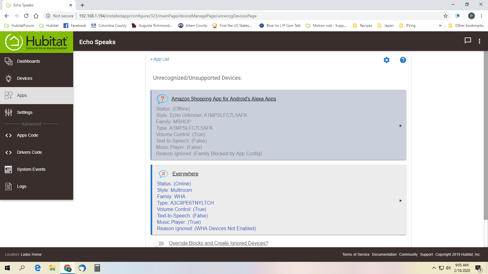

Yup, can confirm I am getting the same errors as @jsarcone
2020-02-16 03:35:53.802 pm [error] EchoApp (v3.5.0.0) | receiveEventData Error: groovy.lang.MissingPropertyException: No such property: AFF5OAL5E3DIU for class: java.lang.String
2020-02-16 03:35:35.100 pm [error] EchoApp (v3.5.0.0) | receiveEventData Error: groovy.lang.MissingPropertyException: No such property: AFF5OAL5E3DIU for class: java.lang.String
2020-02-16 03:35:32.132 pm [info] EchoApp (v3.5.0.0) | Cookie Validation: (true) | Process Time: (318ms)
Yep, I am getting them too. Ton's of them.
Does it reference any line numbers?
Nope. Error is exactly as it is shown.
Have been errors for the last week or so... Running latest versions of ES.
This is the most current errors:
The below errors seems to have stopped, at least for now:

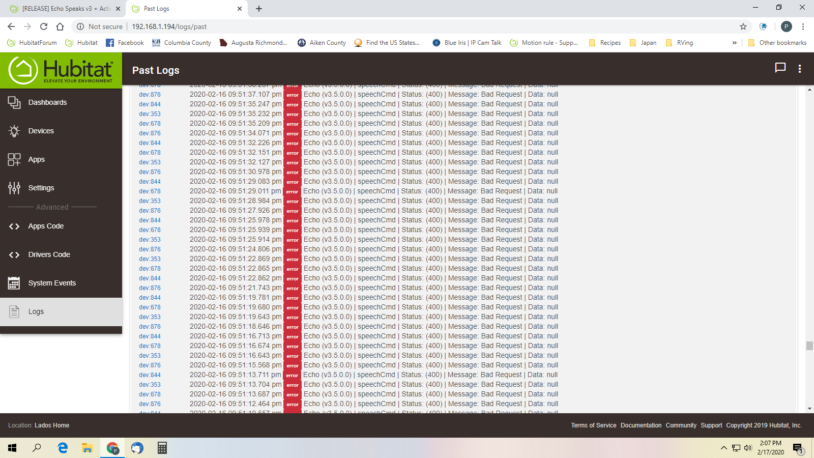

The receiveEventData error is strange because it's acting like it doesn't have an entry in the state data for the device type id. (I will see if I can duplicate this error)
I'm not even sure how that's speech command is firing like that. It's stuck in some sort of loop.
It's like the speech queue failed (I haven't been able to find a scenario to cause that to happen in almost 2 years)
