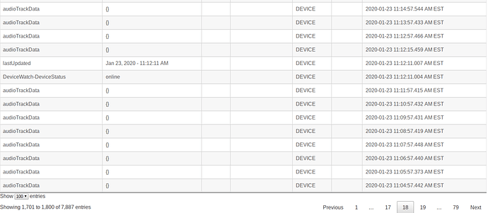

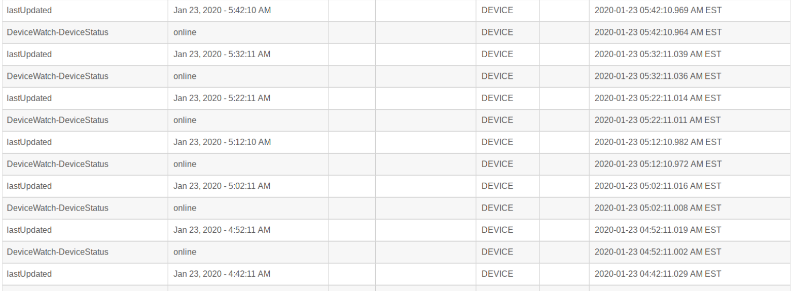

Me too. Something strange in the event logs as well. They usually look like this when the dot is not in use:

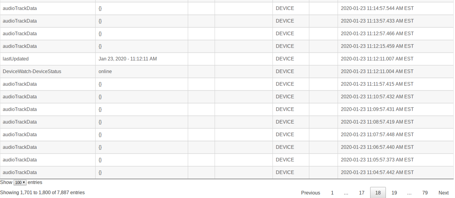

Then around 11:00am yesterday, all of my dots (just 3) started showing "audioTrackData" every 60 seconds and have been since:
I have no idea what it means or if it has anything to do with it but it does appear they've changed something.
I changed my rule to use the dots as a "music device" instead of "speech device". That appeared to get rid of the strange message. I only checked it once as I had to run out but we'll see when I get home today.
