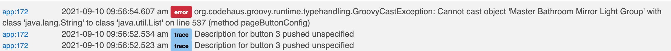

Log when trying to add dim up preference.
Ok Im guessing it doesnt work with a light group?
Nope, just a bug.
(It was trying to let you know your devices don't support startLevelChange() and stopLevelChange(), which isn't an issue if you don't use the "dim/brighten while held" option that depends on these commands; Hubitat group devices do not currently support this.)
I've uploaded v3.0.1 with a fix. Also fixed an unrelated issue I saw with HPM that might affect anyone doing a repair or re-install of v2 (now deprecated, but it would still let you do it). Thanks for the report!

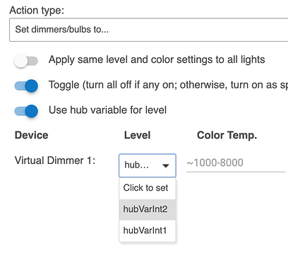

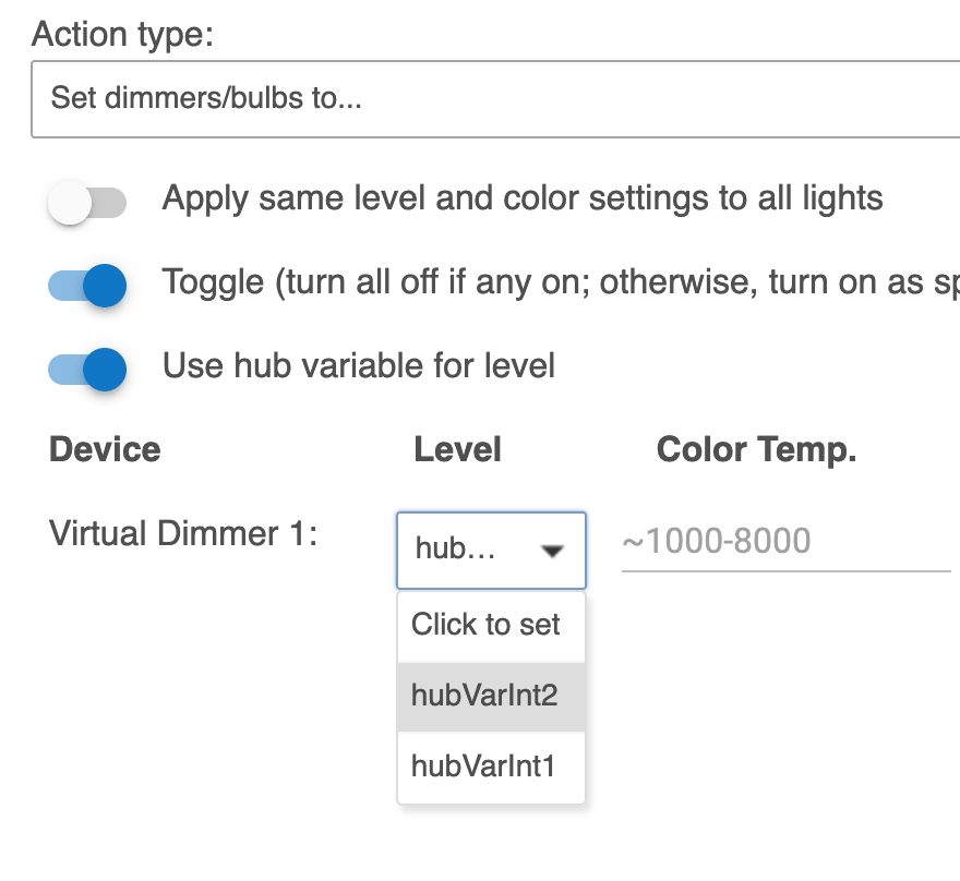

Great App, thank you for developing this. It works much better than the other. I have one request... is it possible to allow a variable for the device "Level"? I have a variable for level that is based on illuminance. I would like the action to set to the level of the variable,
Probably! Maybe something like this for the UI? (Just started experimenting and came up with this...doesn't do anything yet.
Looks perfect. Thank you!
I've released Dimmer Button Controller 3.1 with these changes:
- new option to use hub variable for level (as discussed above)

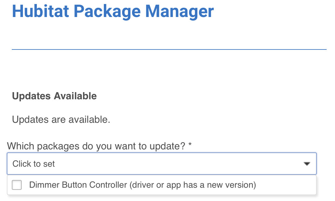

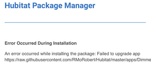

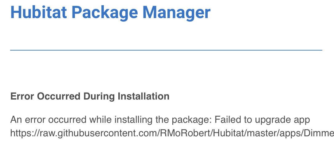

Iām getting an error in HPM when trying to update this app:
Any idea what would cause this? Am I the only one seeing this?
I tried both a new install and a repair (don't have anything that I could update, exactly) and both worked fine for me. If you're upgrading 3.x to 3.1, you can just grab the code manually from GitHub as a workaround for now and overwrite the old code. If you're updating from 2.x or newer, I'd suggest adding it as new app code, and you'll also need to update the parent app (in place).
Thanks! I did a repair instead and it worked. I was on 3.X, repair added 3.1. Maybe that was the issue, but it seems to work now!
