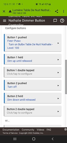

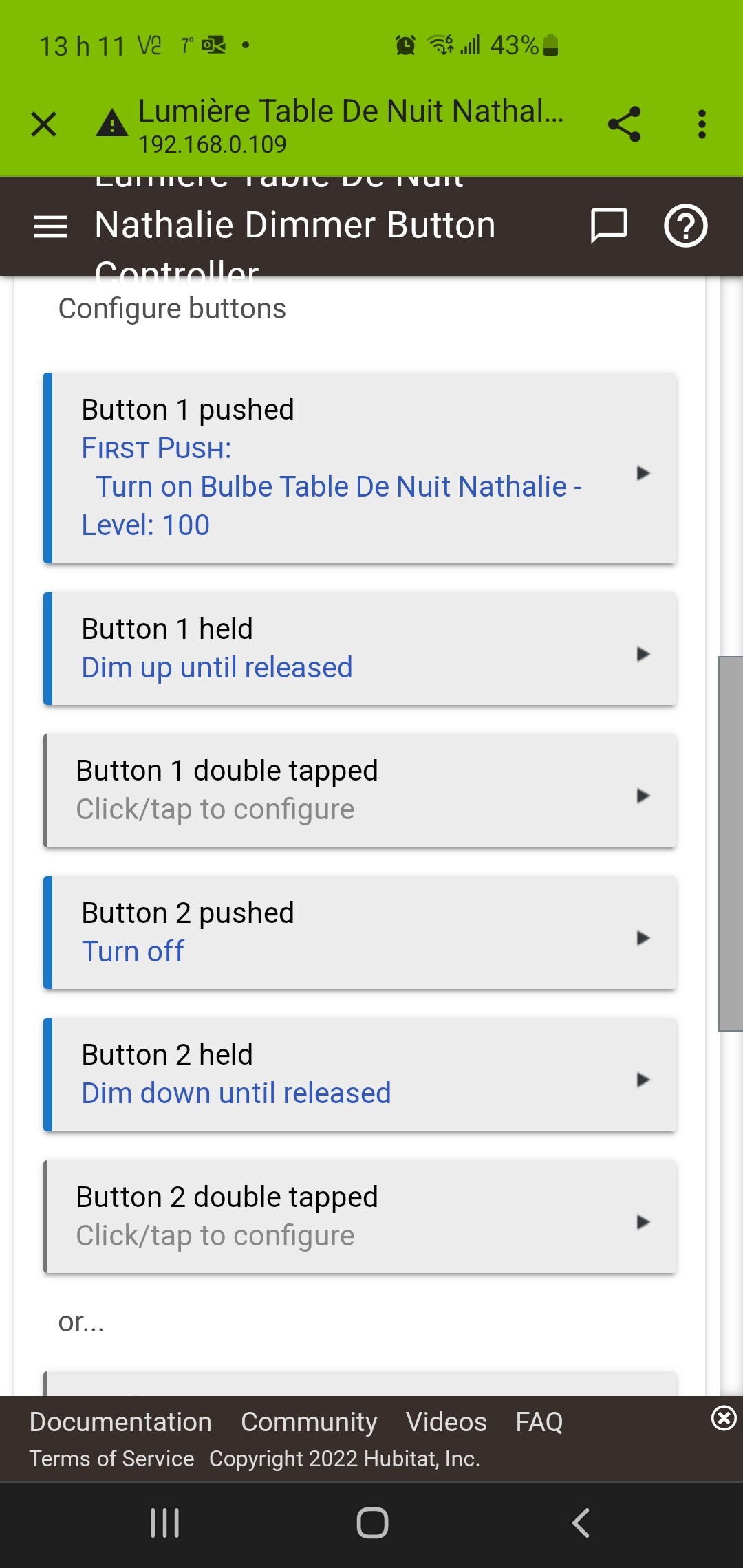

Hello, I have a C7 with firmware 2.3.1.142 and I want control Inovelli bulb LZW42 with a Zooz button Zen34.
I can turn on/off the bulb when I press the buttom but I can't dim up/down when I hold the button. When I hold the button, the bulb go on or off instantly without dimming.
I try also with "Button Controler" app and the same things happen when I hold the button...
Thanks for your help.
Sounds like an issue with the device, then, not the app. To test:
  1. Navigate to the device detail page for this device (Devices > your device).
  2. Run the "Start Level Change" command by choosing either "up" or "down" (depending on which direction you want to go), then clicking the button to actually run the command.
  3. Be prepared to click the "Stop Level Change" button very quickly afterwards (to stop dimming, i.e., what should be done when you release the button as you've configured it in my app).
If the light does the same thing there, then you've ruled out the app as a problem. But I'm not sure what to suggest for the bulb, then. There is a "dimming speed" parameter, but I think that only affects "Set Level," not these commands. You can still experiment with whatever options your driver offers to see if anything changes. If you're using Hubitat's built-in driver, Inovelli also has a custom driver you could try.
You re right! I try on the device (bulb) and the "start level change" is instantanous on or off. I will check with Inovelli support.
