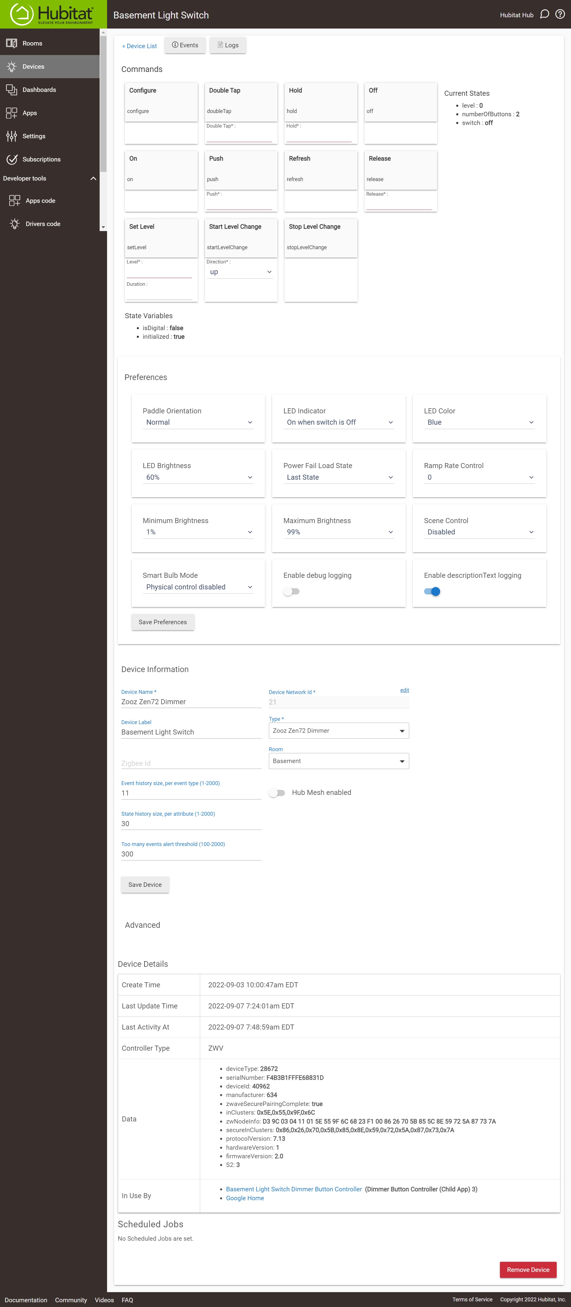

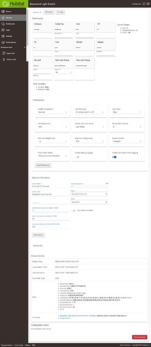

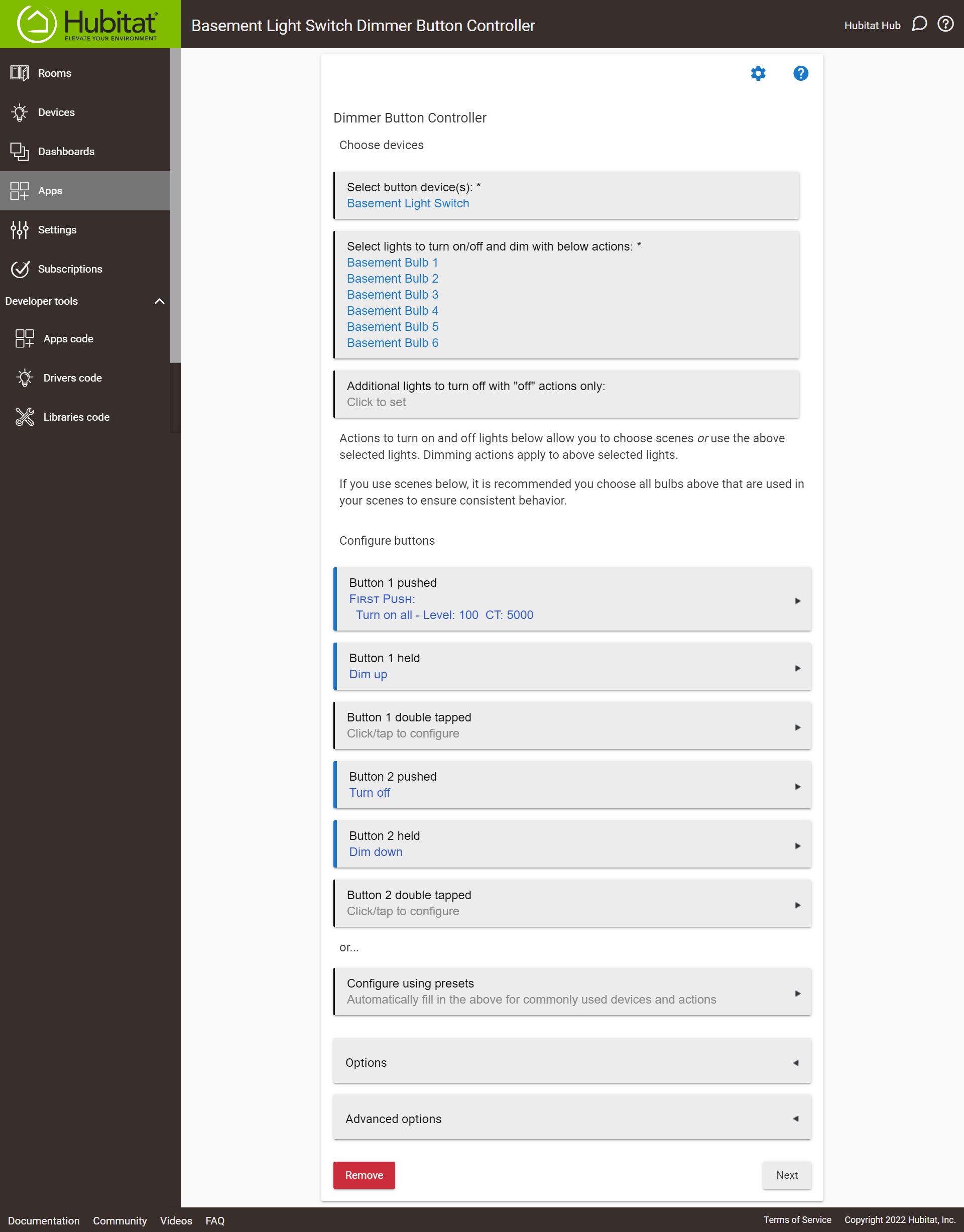

@bertabcd1234 wondering if you can help, i'm at a loss for why this isn't working. I have 6 Lightify bulbs, they all work individually but I'm trying to set it up so that my Zooz72 dimmer controls them. Pics below:
That configuration looks OK to me, so the only thing I can think of is that turning on 6 bulbs at the same time without group broadcasting, especially older Sylvania/Osram/Lightify bulbs, might be too much. There are well known problems with some Zigbee bulbs, mostly older ones, on "mixed" (bulb and non-bulb) networks; I'm not sure if you're aware of that, but that's another topic, and perhaps yours aren't really subject to this problem.
My first suggestion would be to create a group or Room Lighting instance (this can/will effectively replace Groups and Scenes, besides being usable to automate the lights themselves) and enable Zigbee group broadcasting, then use the group or activator device in this app instead of the individual bulbs, to see if that helps.
The usual advice of looking for errors, etc. in the logs would also apply. Make sure you hit "Done" in the DBC app as well to actually save your settings before testing.
it's so odd, the group behaves fine, but as soon as I try and link it to the zooz switch it fails
