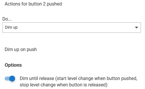

I might try manually changing the settings for that button event to "Dim up until released" (or down) instead of relying on the presets to see if that helps; it's possible they missed something. They will likely be going away in the next major release now that app cloning is available, though existing setups will continue to work; but this will require some re-thinking of the app's internal settings.
You'd see something like this on the configuration page:
Dim up until release configuration screenshot

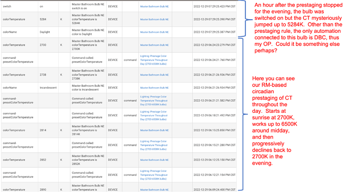

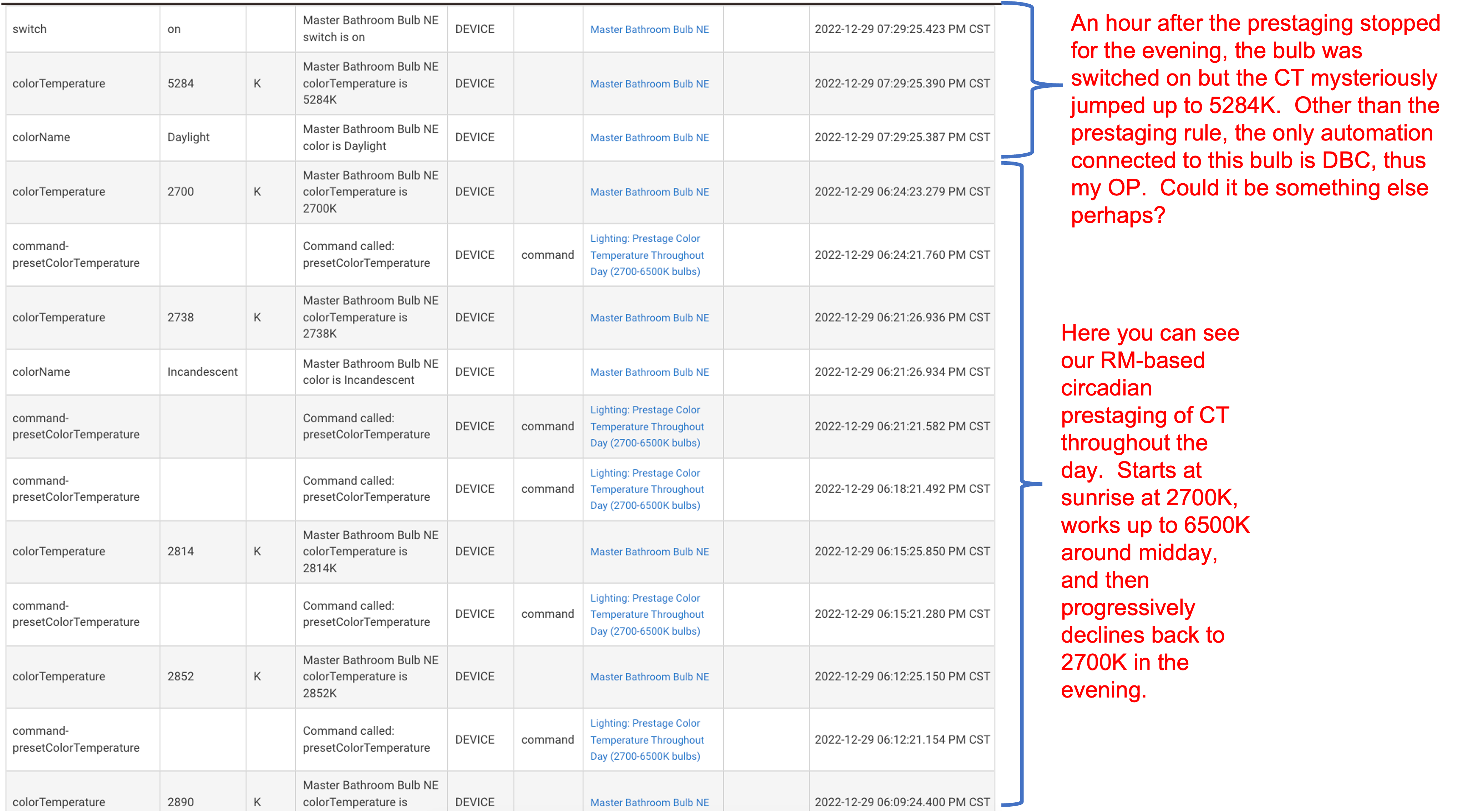

This was regarding adding an option to set color temp with a variable. I’m NOT raising this as a nag, but because I’m wondering, in the current version of DBC, what CT level is used when DBC turns on a bulb but CT is blank in the app parms?
I’m asking because I have separate automation that presets CT based on a specific circadian rhythm in our home, but I noticed the rhythm is interrupted by a mid-range CT every time the bulb is activated by DBC. Odd behavior I’m trying to chase down.
Any ideas? Logs available upon request.
Very honestly no idea and I'm (still) thinking about reworking all this anyway..,but if you turn on as much logging as you can and point me to where the lights actually get turned on, I should be able to dig to the right spot of the code and find the answer. :slight_smile:
Off the top of my head there shouldn't be any "defaults" here, so it's probably something the device is reporting and the driver might be doing, but I can't say for sure.
Robert, the logging below isn't super granular w.r.t DBC, but I'm hoping it helps narrow it down some. Thanks in advance for the help
Those are device events, not logs, though FWIW I don't see any commands sent by DBC in those. I would need output from the app in the Logs page of the UI.
@bertabcd1234, appreciate you pushing me to look deeper into the logs --> mystery solved and from a source that was the last place I looked.
In case anyone has the same kind of problem, here's what I learned. It turns out that group devices (as in, a virtual device created by the Groups and Scenes built-in app) does not inherit prestaged CTs from its member devices, even when the group device is of a bulb device type. Sure enough, there is no prestage command (legacy or current) available to a group bulb device. And if you try to add such a device to a presetColorTemperature command in RM, the action will convert to a broken action immediately. I don't know if the same problem exists with preset-level, but I suspect that's the case too.
So when DBC was activating a group (without the preset CT), it was interrupting the circadian rhythm that we otherwise manage centrally for our home across all light bulbs.
Eye-opener for me -- hopefully others can avoid the painful lesson I went through.
