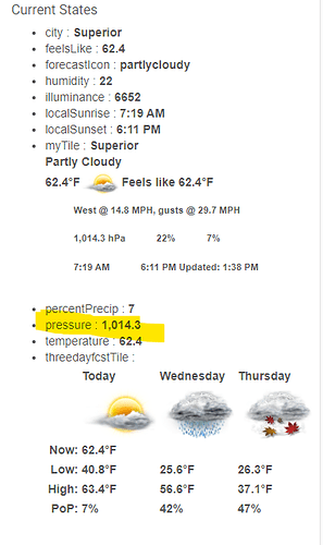

I am having trouble polling the pressure data. I keep getting null no matter how many times I try to put the pressure data into a global variable.
Could I be doing something wrong? Is it a format issue perhaps?
I'd appreciate your thoughts on this.
Thank you.

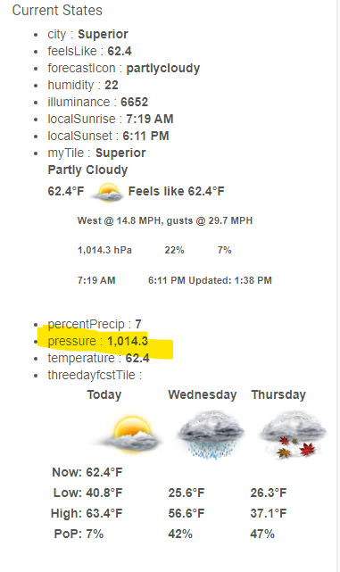

Does the device show a value in the 'Current States"?
It is formatted as a string value in the code. Depending on your 'Units' selection is could be:
hPa or MBAR: String.format("%,4.1f", getDataValue("pressure").toBigDecimal())
inHg: String.format("%2.2f", getDataValue("pressure").toBigDecimal())
If you need it to be a number you would have to convert it.
Yes, it does. (unfortunately I am not able to post imagens here yet)
I don't need this as a number, having it as a string is enough to me. My problem is that when I try to set a global variable to pressure value, it returns "null" and I don't know why. Have you tried to use pressure data into a global variable successfully?

@alphaville21a14 pointed out an error in the data type for 'pressure'
  • Corrected 'pressure' to be a number (it was a string with formatting).
  • Added 'pressured' to replace the formatted pressure for those that want the formatted string.
