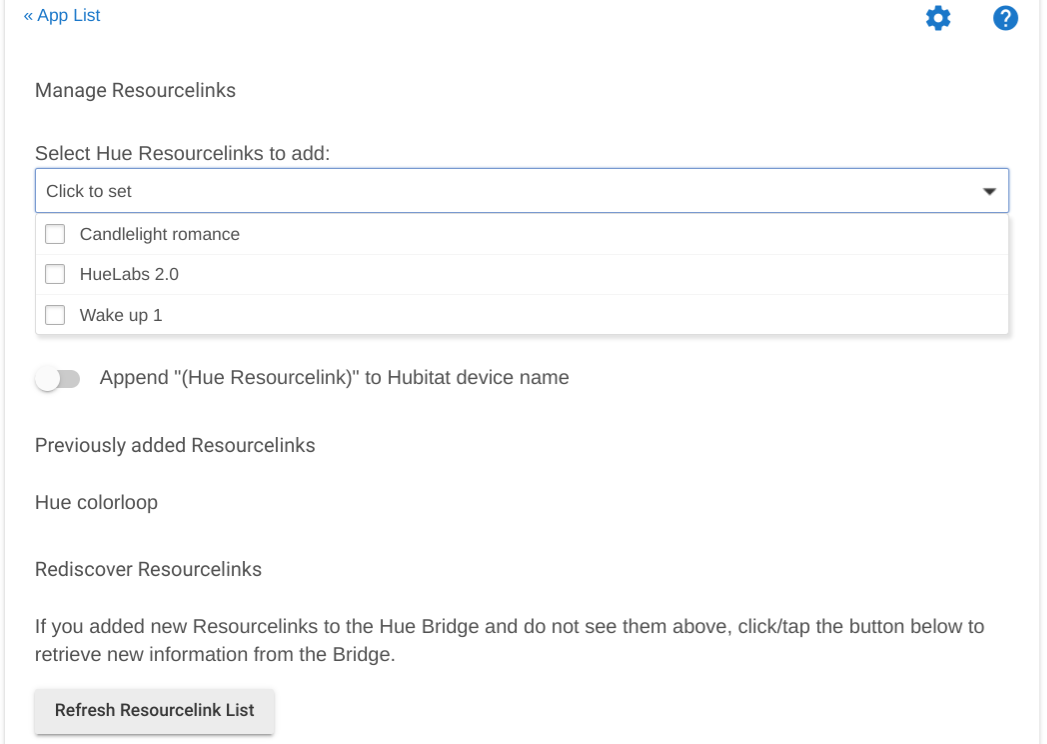

Well, after lots of Googling it seems Labs that have a 'virtual switch' can be accessed via Resourcelinks and then Sensors. This blog has gotten my attention!
@bertabcd1234, looks like the on/off plug driver would need to be modified or another driver created to make this work. I think it needs to receive a state instead of an on/off.
OK, so I just experimented with adding one Hue Lab to my Bridge, the "Candlelight Romance" lab. It did indeed add an entry to ResouceLinks named what I expected based on my name in Hue Labs, and under its links array there does indeed seem to be a sensor entry whose ID matches something under Sensors, and it looks like PUTting a {"status": 1} to /api/<username>/sensors/<id>/state works to start that effect (or {"status": 0} to turn it off). However, I'm not sure this is consistent between different Hue Labs formulas, and I'm not sure what it does if you choose "real" device like a Hue Tap to activate the scene (I chose a virtual device, the webpage control panel).
I'll definitely play around with some of these a bit more, and thanks for figuring out how they are implemented! I'm still a bit hesitant to go too far down this path because I'm not aware of any Labs that actually document how they are done (this is just what I saw for this one), and many of these just seem like Philips' playground where some become actual features later that are much better documented, but for at least a subset of these there does appear to be some way to make them able to be activated from CoCoHue.

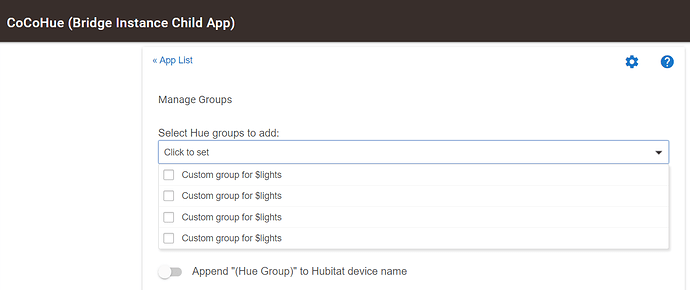

I'm not using Hub Connect but I recently added a number of additional bulbs to my Hue Bridge. I also noticed that when I'm in the "Manage Groups" portion of the Bridge Instance Child App setup I seem to have some strange entries that populate. Is the app pulling this info from the Hubitat DB or from the Hue Bridge? Is it possible there are orphaned entries in Hue?
CoCoHue is just pulling that from the Hue Bridge. Casual Googling suggests that these names may have been created by Hue Labs formulas you've tried in the past: "custom group for $lights" - Configuration - Home Assistant Community (I've been trying to tell people how mysterious these are )
Normally what you'll see under "Groups" are Rooms and Zones you've configured in the latest version of the Hue app. Third-party apps may let you do different things here (as apparently does Hue Labs), so I can't vouch for the typical behavior there.
