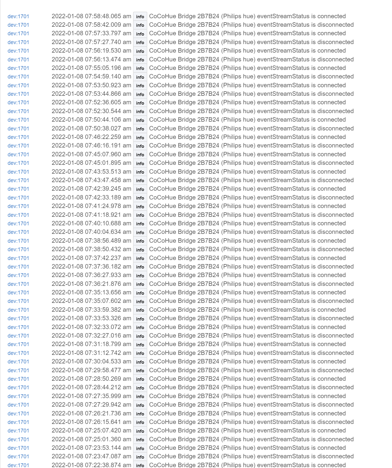

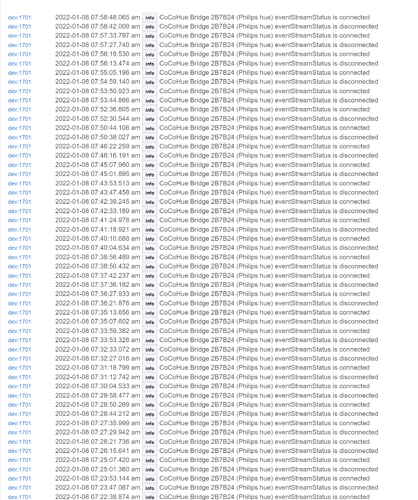

this is constant in my logs, I read the previous posts and the consensus is that this is fine right?
Yes that log spam appears to be normal at the moment. I found that if you go to the actual Bridge DEVICE (the device using the CoCoHue Bridge driver) and disable the info logging, that makes it stop logging it at least.
