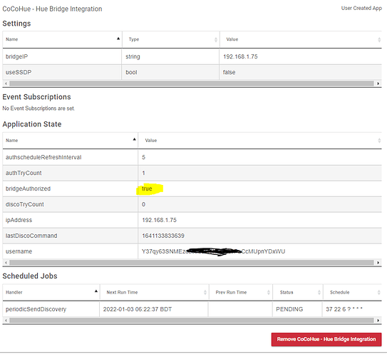

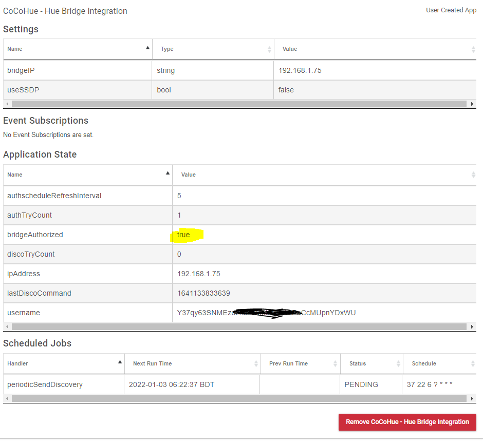

I think that bit worked but still stuck on that page.
Hue hub on latest firmware
Unifi networking - same subnet no vLANs - I dont know if this is a SSDP issue but it shows as off below

I did and that's how I got this far with a username being picked up after pressing the Hue hub button and with the above screenshots showing that username and bridge/authorised true
Thanks for the information! I think I found and fixed the bug that prevented the bridge authorization pages from updating. This in version 4.0.1, which is now available via the usual installation methods (HPM, manual, or — new for v4 — the bundle ZIP).

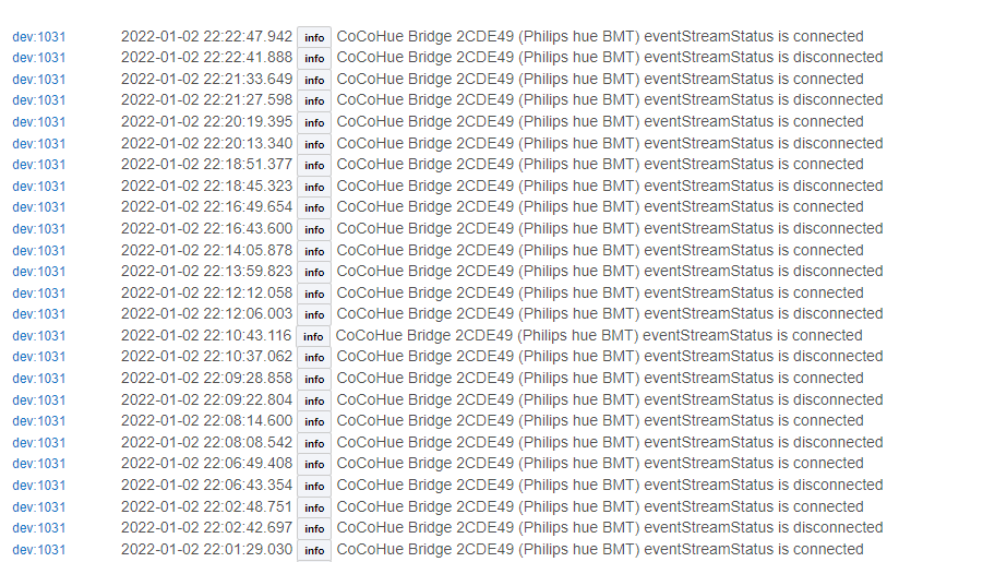

How much is normal? I have three Hue bridges and this is just one of them.
I’m seeing around eighty to one hundred events per hour on each of my two bridges.
EDIT: I should have also mentioned that I have not seen any ill effects from this behavior in the several months I’ve been using the beta (and prebeta).
It shouldn't happen at all unless your Hue Bridge truly disconnects, so I'm not sure what to say for what is "normal." :slight_smile: On the two Bridges and three hubs I've tested this on, sometimes I see it a few times a minute but other times not for hours at a time. I wouldn't be worried about something that only happens every minute or few. But this is just the Eventstream information coming into the Bridge driver from Hubitat, so it appears either something is odd about Hue's implementation or the library Hubitat is using to receive this stream.
I'm hoping this will get sorted out as the API matures if it is indeed a Hue oddity; in the meantime, it hasn't actually caused any problems for me (but the driver does resort to some "old" behavior if the status is reported as disconnected so you don't have to wait for a poll to get an update for changes made from Hubitat, for example).

The connect/disconnect thing has been constant for me (every ~2 minutes in the logs) since updating over the weekend, but I haven't noticed any ill effect. Last night, I disabled polling altogether, and so far so good.
