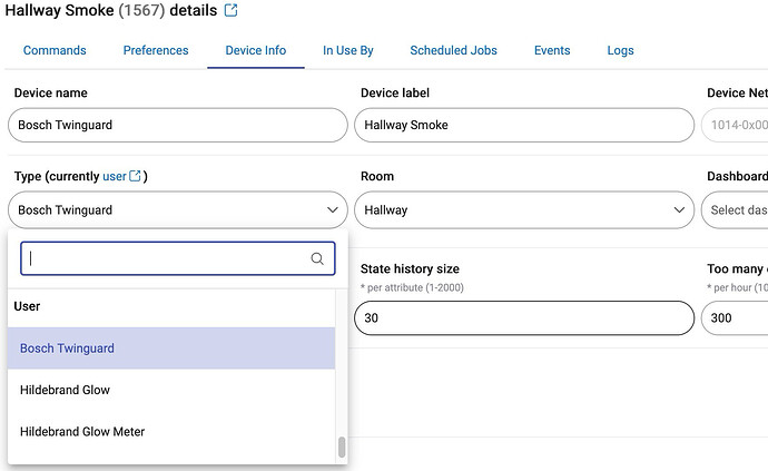

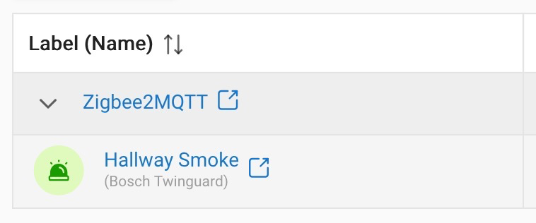

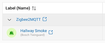

Once the driver is installed, you'll need to tell the device created by Zigbee2MQTT Routing to use it, otherwise it'll just sit there being a generic "Zigbee2MQTT Device". Click on the arrow to show your Zigbee2MQTT child devices, then click on your Twinguard.
Go to the Device Info tab and change the Type to the matching Bosch driver.
Click Save, then hop back over to the Commands tab and press Configure to set everything up. If you forget to do this it'll sort itself out as soon as the next message is received, so don't fret if you forget.

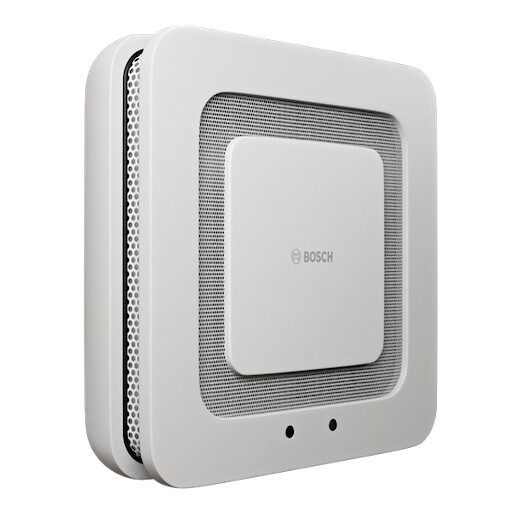

Bosch Twinguard
All smoke and air quality features are working, including the Burglar Alarm function. Due to the way the Alarm capability works in Hubitat I've implemented the three alarm modes using the mandatory commands "Siren", "Strobe", and "Both".
  • Siren = Fire Alarm (continuing series of three long, full volume beeps)
  • Strobe = Burglar Alarm (continuing series of three rapid, full volume beeps)
  • Both = Pre-Alarm (continuous single beeps at half volume)
