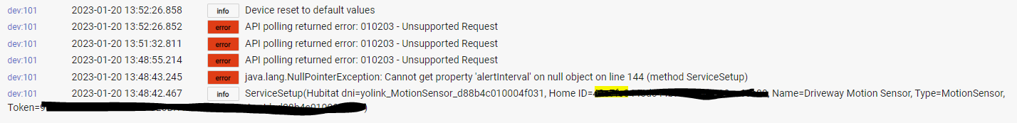

anyone else having this issue? Can't seem to get my outdoor motion sensor to show any kind of states.

Hello, I just released numerous updates to the app and drivers. Please update them using the Hubitat Package Manager 'Update' option. Then run the "YoLink Device Service" app, deselect the outdoor motion sensor and run the app to completion. Then rerun the app and select the outdoor motion sensor and run the app to completion. Also, check the device on the YoLink Mobile app and insure the device's firmware is at the latest level. Thanks.

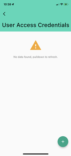

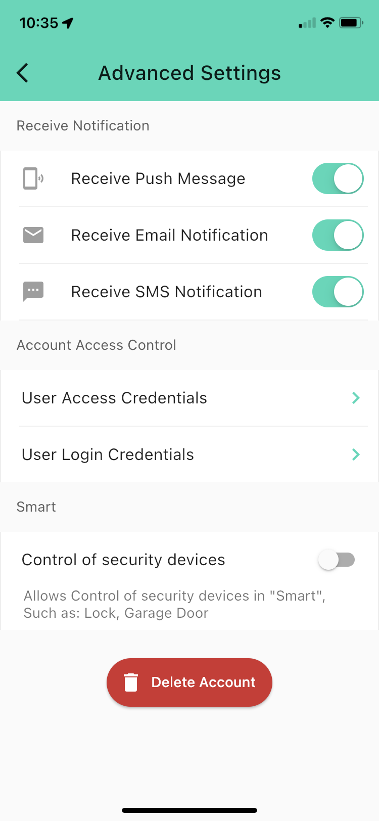

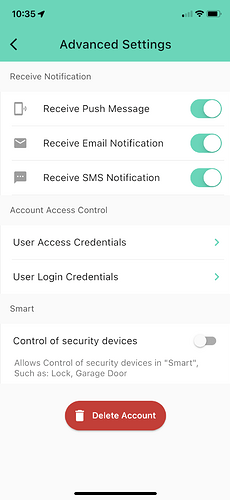

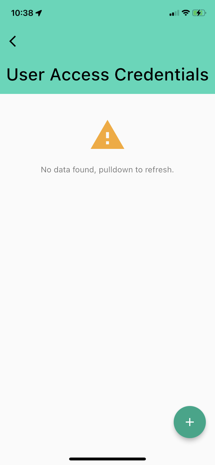

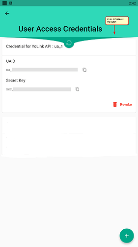

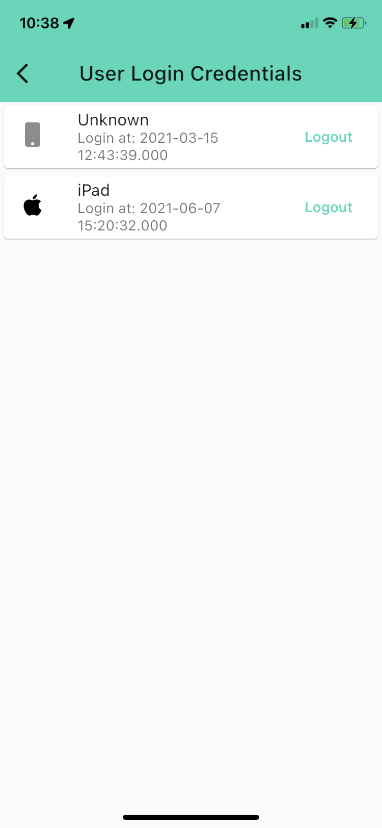

@SteveBarcus, when I try to get the credential data from the YoLink app I see a different display under Account Access Control:
If I go to Access Credentials I see:
If I look at User Login Credentials I see"
I can't open either of these further. Any suggestions?

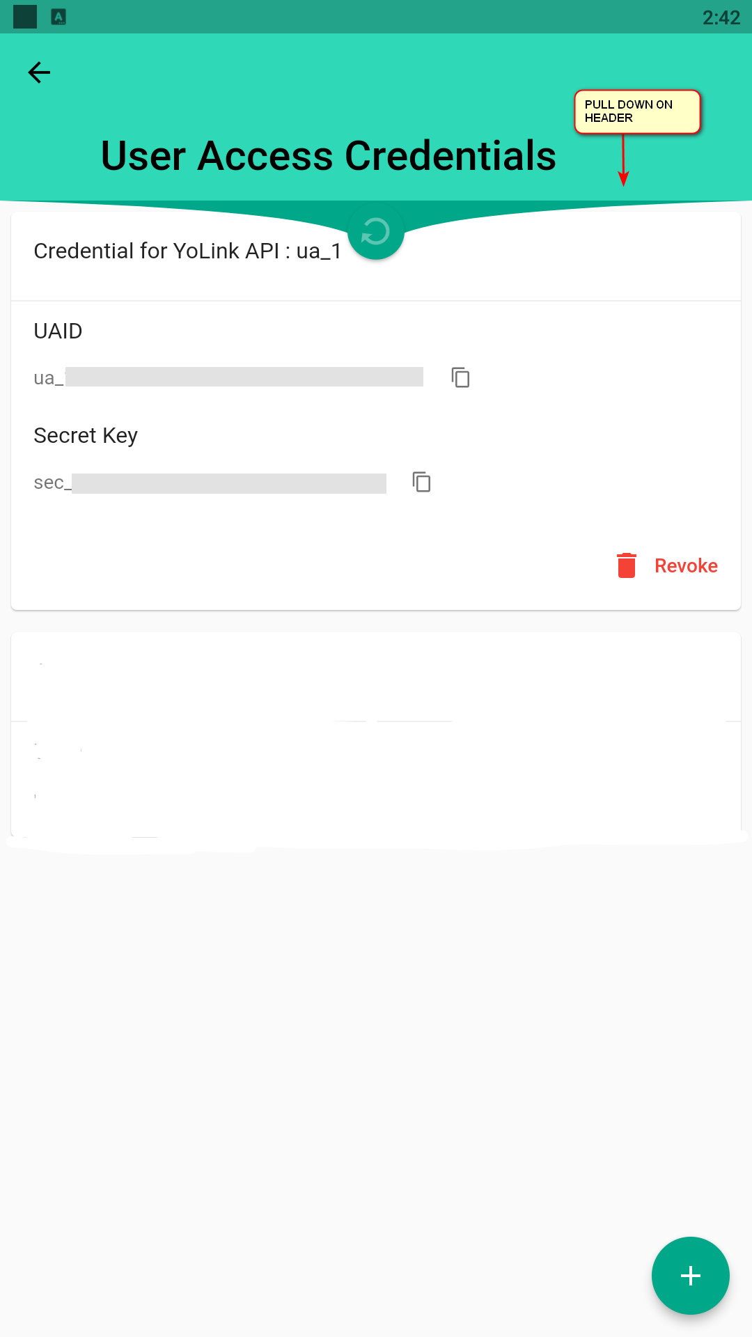

On the "User Access Credentials" page, click on the "+" to request a new set of credentials.
You can also try a refresh by pulling down on the header:
Thanks!
