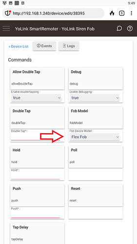

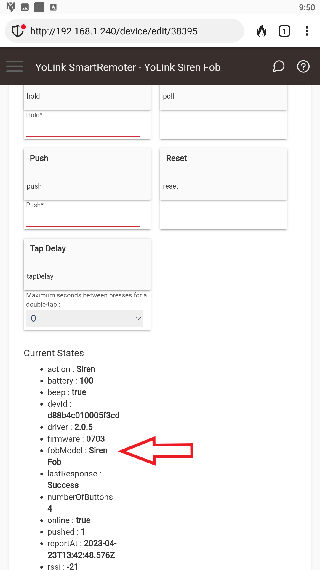

======== IMPORTANT ========
The driver has no way of automatically identifying the type of Fob you are installing. It assumes that the Fob is a "Flex Fob". If it's a different type of Fob, then you must edit the Device on Hubitat and select the proper Fob type or it will not function correctly:
Siren Fob Example:

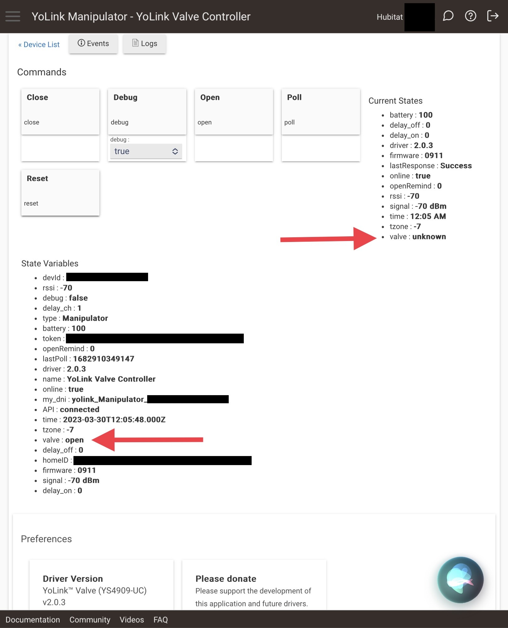

I am experiencing a problem with my Hubitat Dashboard tile showing the correct state of a YoLink valve manipulator. I am using the template “valve” for the tile. The tile shows the valve status as “unknown” even when the valve state is “open”.
The device page indicates that the current valve state is “unknown” (which is reflected in my tile) while the State Variables shows the valve status is “open” (the valve is physically open and the YoLink App shows the correct state of the valve as “open”). When I press the Poll button on the Device Page, I get no update on the Current Status and it remains as “unknown”. The polling interval in your YoLink Device Service app is set at the recommended setting of 5 minutes, but as previously stated, manually polling does not seem to update the Current Status.
@moh
Driver is fixed. Use HPM 'Update' to get it. Thanks.
Thank you so much. I will try it. And again, can’t emphasize too greatly my appreciation for your quick response and for all you do for our Hubitat community!
@SteveBarcus, Installed update and everything is working. Thanks again!
