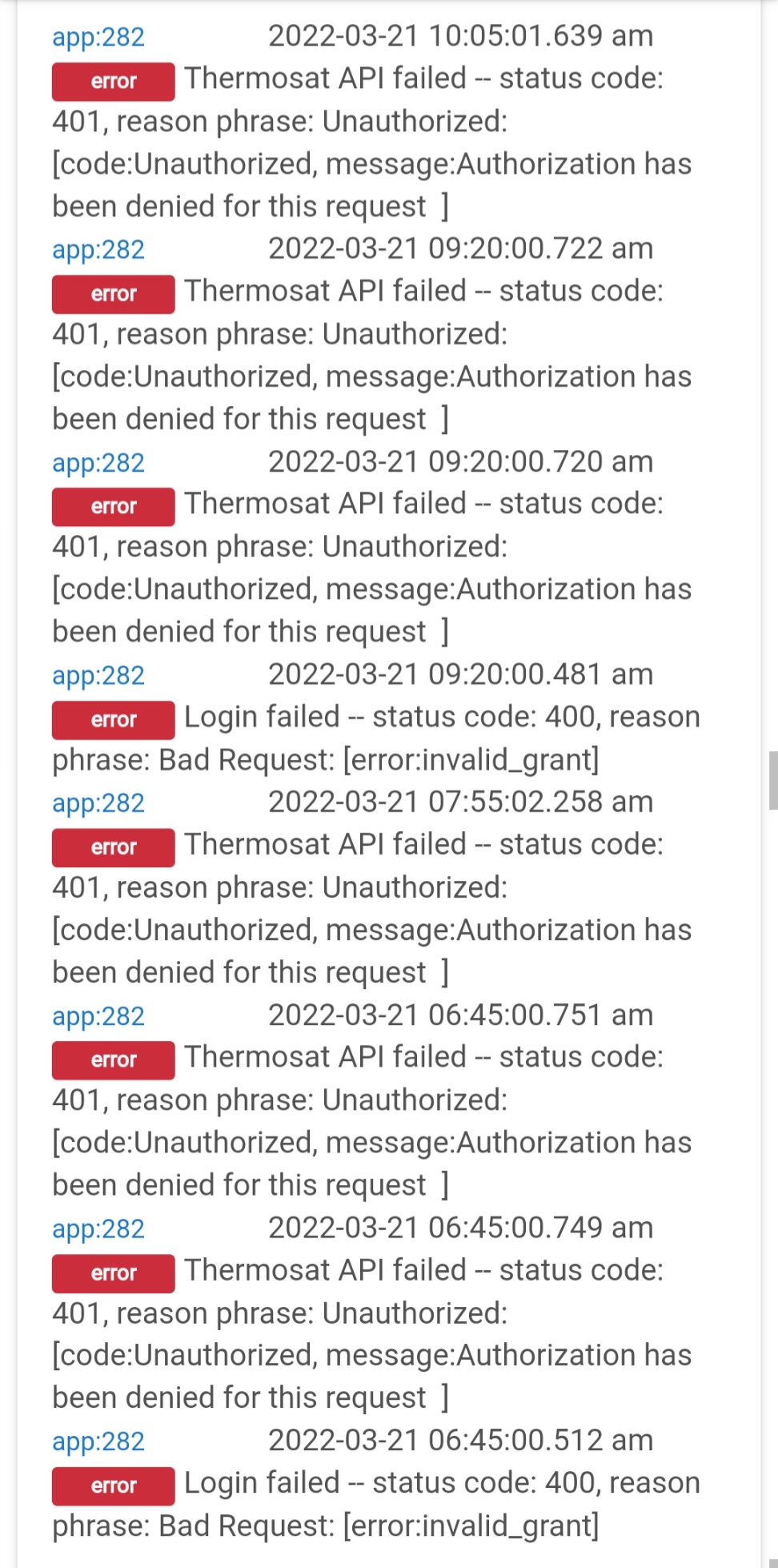

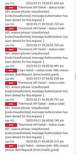

I've been getting more frequent errors. Same type of stuff as before just more often. Majority of the time, however, it seems to work ok afterwards.
It's like the errors are false. Very odd. Frustrating too, honestly since about a third of the time I have to go in and reauthorize.
I still suspect this is something on Honeywell side. Nonetheless, I wanted to share it incase there is some tweaking that can be done.
Same issue here . Every week or i need to reauthirize
The errors are quite real and I get then as well. I also believe that the issue is on Honeywell's side.
The way that this works is that the driver requests a token from the server. That token is only good for a certain number of minutes and it is used to to do things like change settings or get values (temperature, for example). The driver is responsible for refreshing the token before it expires by requesting a new token.
What is happening when you see these errors is that the driver is using a token that should still be good to make a request and the Honeywell server is rejecting the token as expired. When the driver gets this expired error, it will get a new token and retry whatever it was trying to do.
The fact that these errors happen randomly makes me think that it is the Honeywell servers at fault. Some days I have no errors and some days I have a lot of errors. Occasionally I also lose authorization and have to go through reauthorizing. There is no way that I know of to automatically reauthorize - it is a manual process that requires you to log into the Honeywell site. So working around these seemingly flakey Honeywell servers doesn't seem to be possible. Very frustrating.
