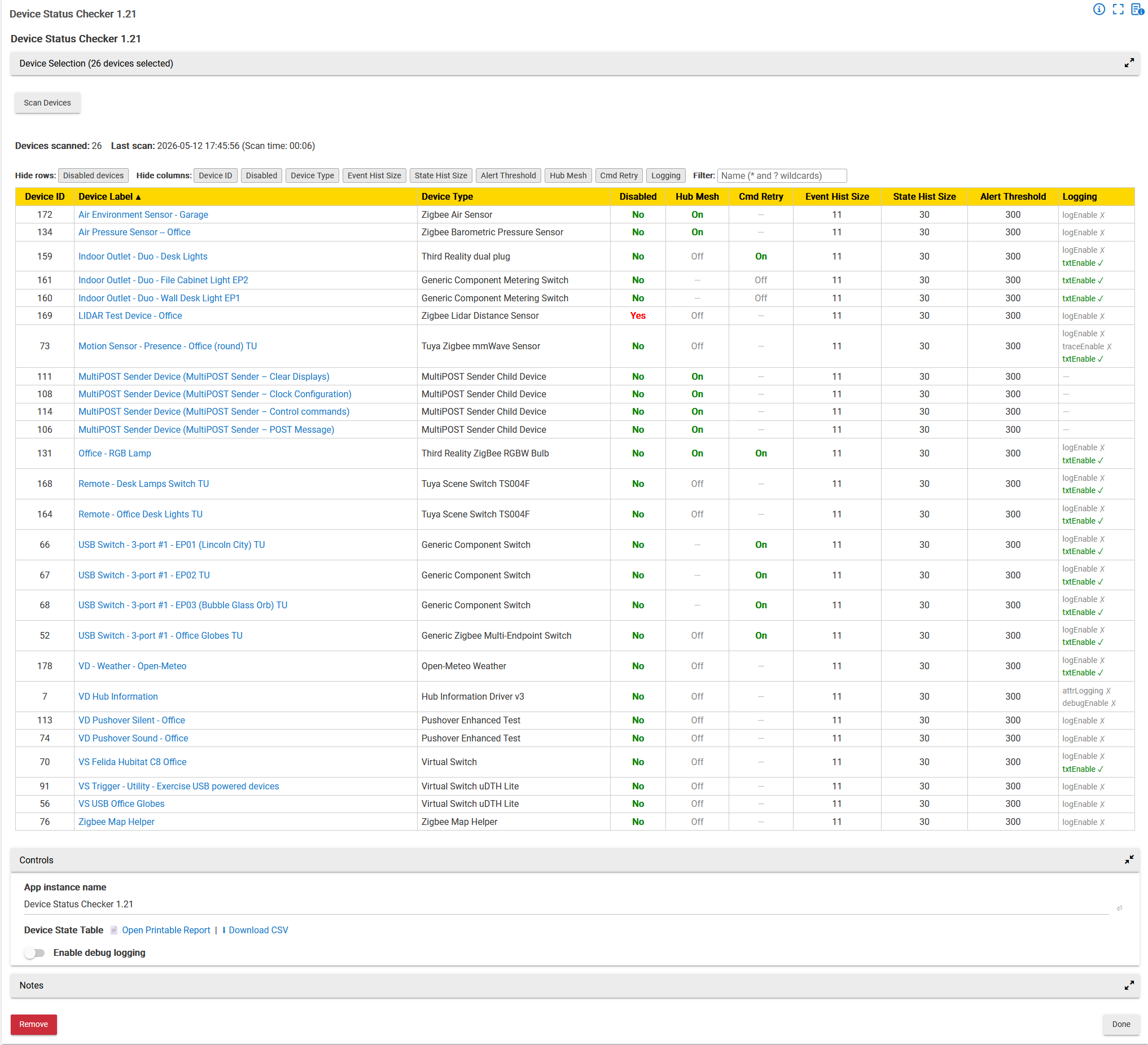

This app will give you some info on device logging status; it will not set/reset logging levels though.
