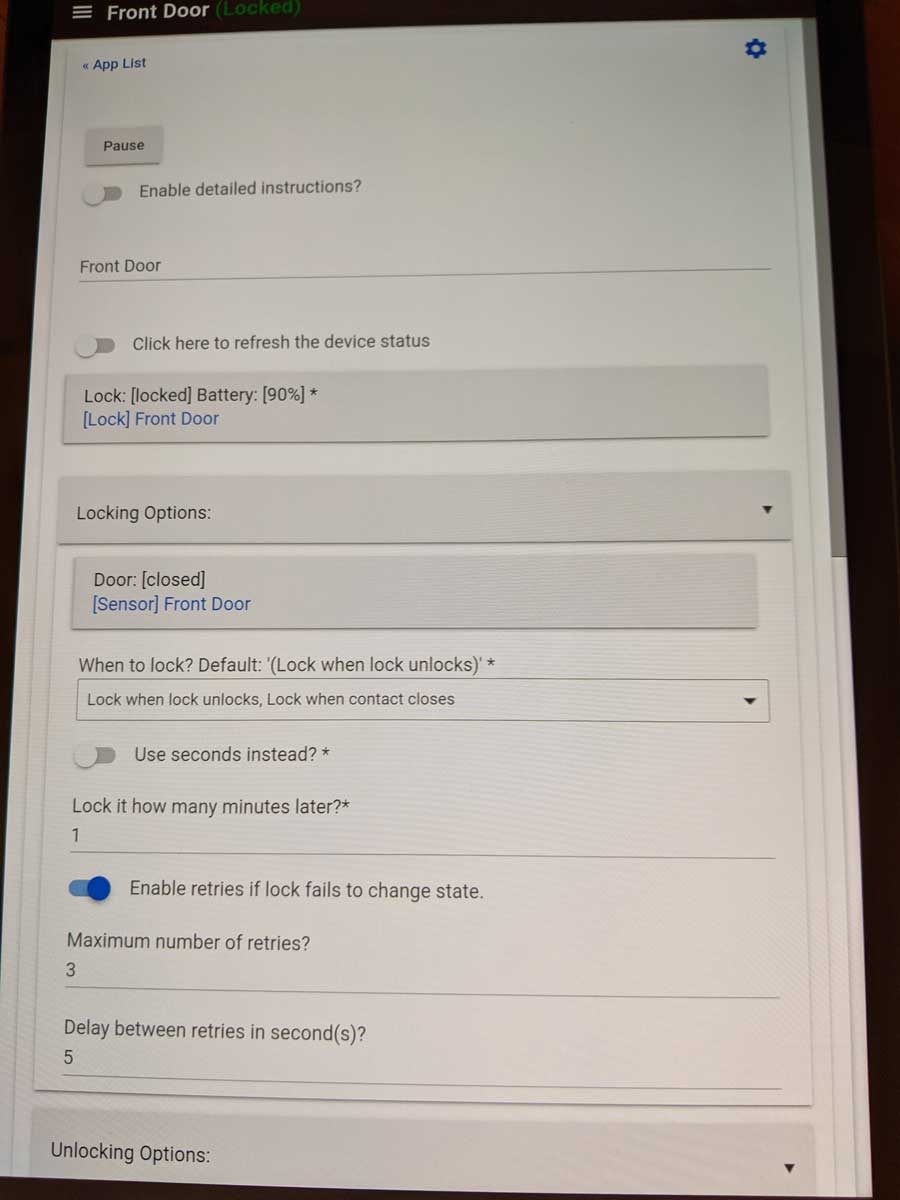

I have a Visonic contact sensor on my front door, and it reports battery (shows in the device page) but hasn't shown battery in the app yet. I re-installed the app yeseterday when we were troubleshooting things, so the app has been running overnight.
Device page shows current battery:
And the last time It reported battery was early this AM:
Not a big deal to me, just an FYI that Visonics don't appear to cooperate w/the app. It's using the Generic Zigbee Contact Sensor driver.
I use evt.value when it comes in
otherwise it tries device.currentValue("battery")
if still nothing it tries device.latestValue("battery")
if still nothing it puts in a space.
