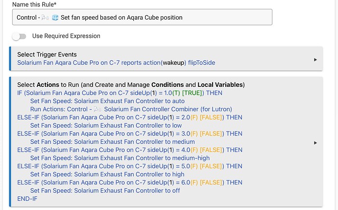

Right now, I have it control a fan by either making it automated (will turn on / change speed depending on temperature, CO2 level, etc.) or setting its speed.
What I've noticed is that the Shake works regardless of where I am in the house but for the other function like Rotate, FlipToSide, etc., I need to be closed to the hub in order for it to respond
Also, both this cube and the wireless button seem to go to sleep and require action in order to wake it up first. Any way of having them wake up automatically or stay awake at all times?

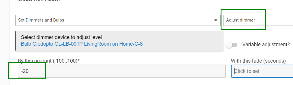

I tried to set rotate left and right to adjust the brightness of my room light but I don't have an option to lower or raise the brightness. Instead, I have the option to set the brightness at a percentage level. Where would I find the options that are shown in your example under the Button Controller?
The options for ramping the brightness up/down may be available or not, depending on whether the bulbs support this feature and also depending on the driver used.
