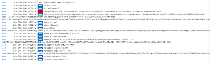

Hi there, I am also unable to Discover any devices. Is anyone able to confirm the exact process to overcome this as alluded to above?
I had my Conexis L1 working perfectly for some time using a Z-Wave module connected directly to Hubitat and have had to install a wifi module and wifi bridge due to the update they made.
I've installed the new module and also have the bridge installed.
I then installed the August Home app and created an email account with Yale.
I open the app and choose email as the authentication method, I then add my email address and password for my email account and press the Login button, a moment later I get an email from August with a code which I copy into the bottom box and click the verify button. I doesnt do anything the first click but on the second that part of the screen disappears and I am just left with the top half which asks for my email/password and has a login button (which if I press restarts the process to ask for a code).
I've tried pressing the Done button and also not pressing it, going back to the main apps screen and loading the August app again. But each time I choose the discover button no devices appear.

I am trying this app and driver now.
I enter the user & password and it asks for verification code.
I get it from August via email and enter it.
However, at that point I see this error log:
connectToAugust failed -- status code: 409, reason phrase: Conflict: [code:InvalidArgument, message:Invalid code]
what might be wrong ?
Even after that, I tried "discover" button.
It brought home name and listed some others in the log.
But these info is not relevant. My app shows "home" as the name of house, but the logs show "ilker's home"
