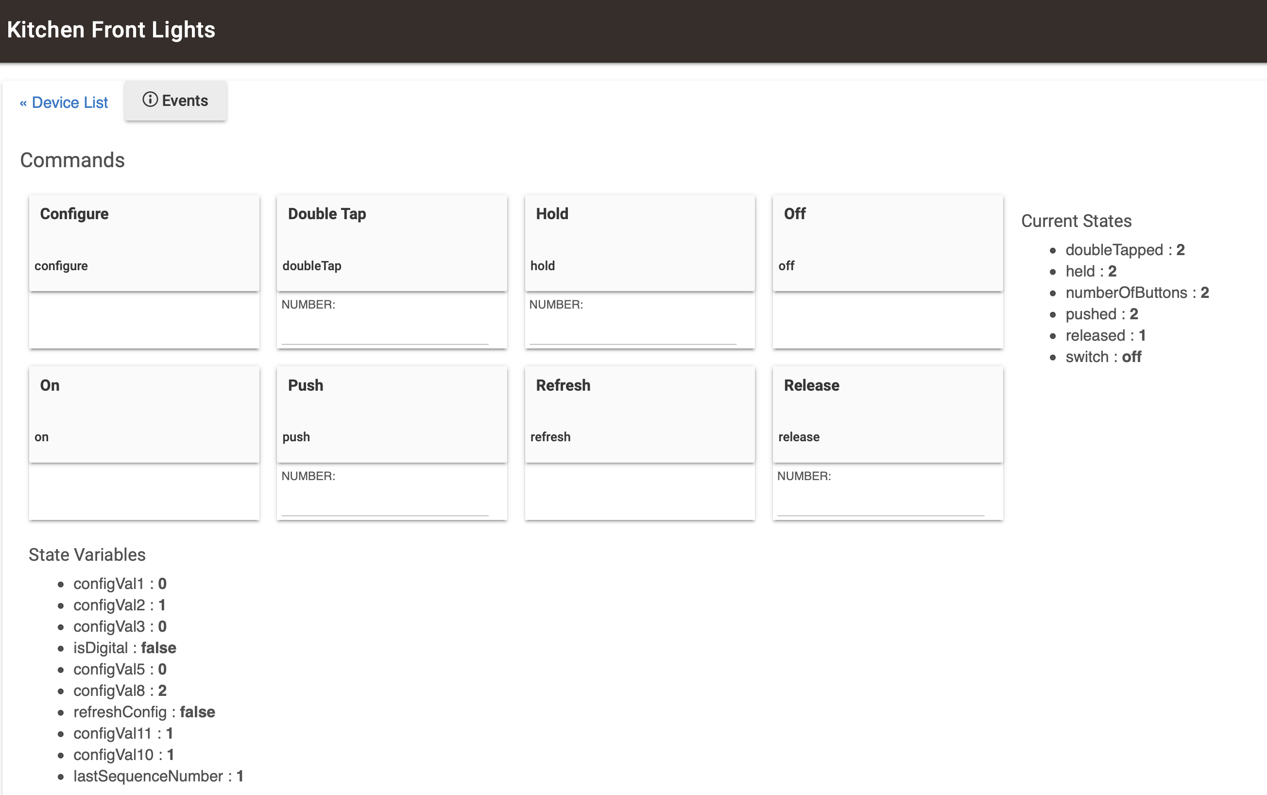

Thanks Brian, but I think you are referring to the ZEN27 Dimmer. Your right that the dimmer doesn't have the press and hold scene control because that is reserved for the dimming functionality but on the ZEN26 Switch it has the capability for press and hold/release. Maybe this just needs to be added to the driver?
The built-in driver has the capability (emulated I'm sure) because the device does not send hold and release on central scene commands
Interesting okay thanks!
Not sure if this helps but here are the logs using the built in driver for each type of button press on the switch:

Here is what comes out with your driver using the same order of button presses:

If you notice in the log it’s just keyattribute and scenenumber.. Which according to zooz docs maps to:
Upper Paddle:
1 x tap: load on to last / custom brightness; Scene 1, attribute 00 (button 1)
2 x tap: on to full / max brightness; Scene 1, attribute 03 (button 3)
3 x tap: enter inclusion (pairing) mode; Scene 1, attribute 04 (button 5)
4 x tap: Scene 1, attribute 05 (button 7)
Lower Paddle:
1 x tap: load off; Scene 2, attribute 00 (button 2)
2 x tap: Scene 2, attribute 03 (button 4)
3 x tap: enter exclusion (unpairing) mode; Scene 2, attribute 04 (button 6)
4 x tap: Scene 2, attribute 05 (button 8)
How does this driver differ from the stock driver?
It offers all the config options, follows the zooz docs for central scene functionality all the features of the latest firmware versions
Oh okay. That’s interesting that the double tap maps to “full brightness” event though it’s a switch with only on/off. Thanks for explaining.
