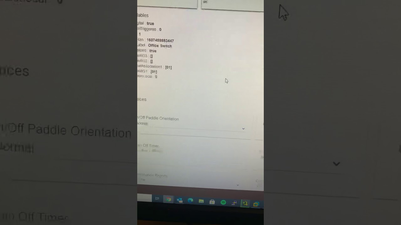

Are you saying that there is a difference between a physical tap on the switch vs digitally through the driver? I think you are saying when you press the switch you are hearing a 'click' but not with a digital change. Also you are seeing that the fade time is longer with a digital change (this is called the ramp rate). Please confirm I am understanding you correctly.
Here is a video that I took explaining the issue:
Yes there is a difference between a physical tap vs digitally.
Let me know how I can help.
