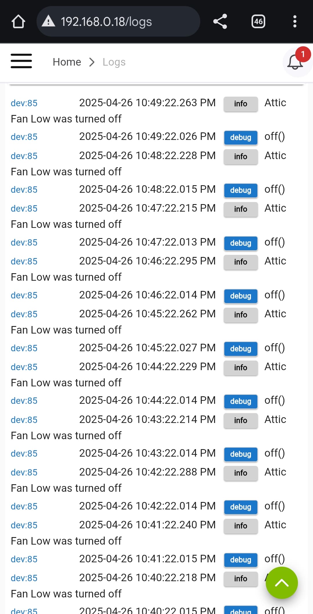

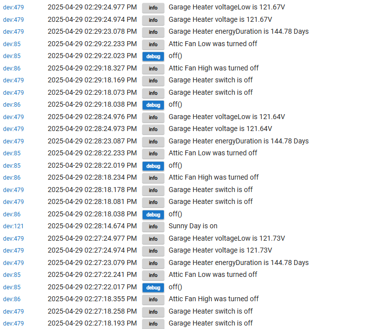

I have been trying to use this app but my log is flooded with off requests for the switch. I was having some network sluggishness recently and I think it's related to two of these virtual thermostats constantly sending off requests to the linked switch. Is this the expected activity?
I have been using this for years without any issue. Have not seen multiple off requests.
Are you able to manually turn off the switches?
The switch is physically off, but log shows Off every minute or so. Not sure if it's sending radio commands or just logging status? Seem very chatty.
It does seem chatty. Are you able to see corresponding events in the thermostat app? I assume this switch did not have any issues before? Are there other automation that are using this switch?
I suggest to go through all connections on this switch and understand if the noise is coming from many interactions.
Since I installed this thermostat I can't even use this switch manually. As soon as I turn it on manually within a minute it gets shut off. I thought that was coming from the thermostat.

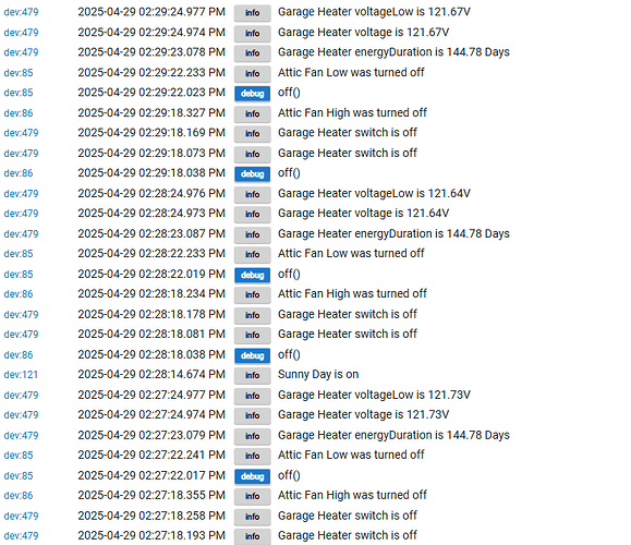

Here is current log - all three of these are V Thermostats. Every minute it fires off an off or on event depending on state. These thermostats are all set to off at present and still do this.

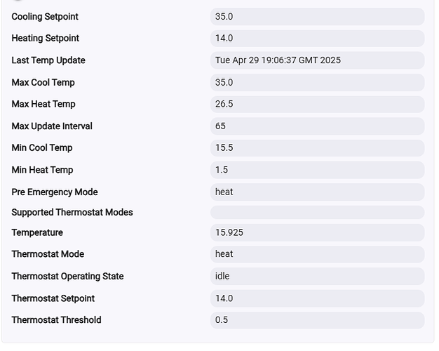

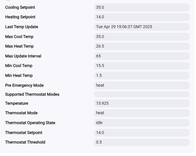

How are you controlling the vThermostat and what are your settings? I see you are using this for a fan, so I expect cooling, but at what setpoints?

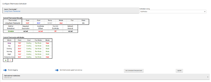

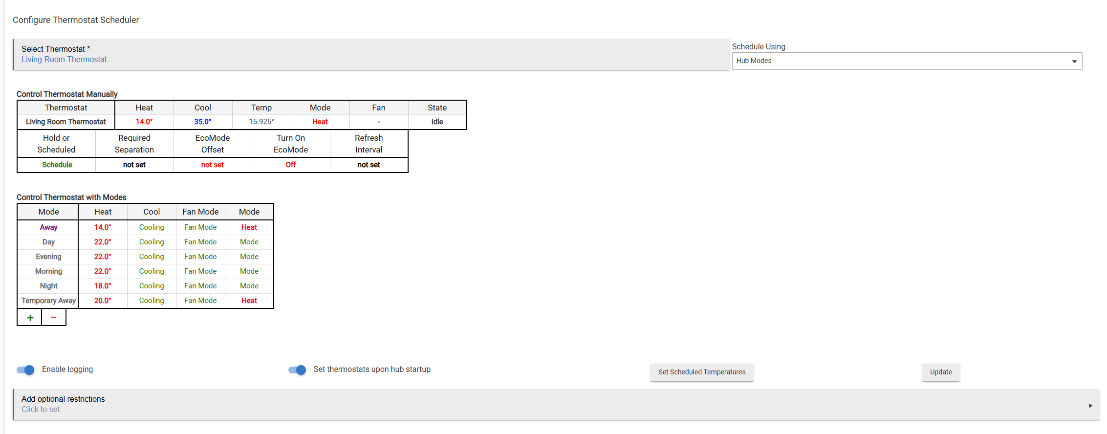

I have my setup in my vacation home and have it currently set at 14°c, when I plan to arrive, I set the mode to home and use the app Thermostat Scheduler to set the setpoints:
This is my vThermostat:
This is the scheduler
Well this is how it was planned from the start since this is a mission critical off, you don't want it to stay on because a zigbee or zwave command was not received correctly and this happens in real life believe me, I've seen some outlets where you send an off command, it stays on, yet it reports that it's off. So because of the potential of a fire hazard, I decided from the start that the off command would always be sent every time the thermostats checks temperature reporting for safety measures.
Sending commands every minute is not really chatty and will not bring the hub resources down believe me. Install an app like the holiday flashing light apps out there, and you will see what a chatty app is :wink:
