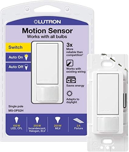

If you put the sensor pointing into the room, rather than towards the door, that will eliminate the false triggering when motion occurs outside the room. Another possibility for small rooms like that is to replace the light switch with a presense type of switch. It will be outside of your other automations, but they are stupid reliable. As long as you have power, they work. This is what I have used in some bathrooms and utility room.
Also, you can adjust the amount of time before they turn off.
