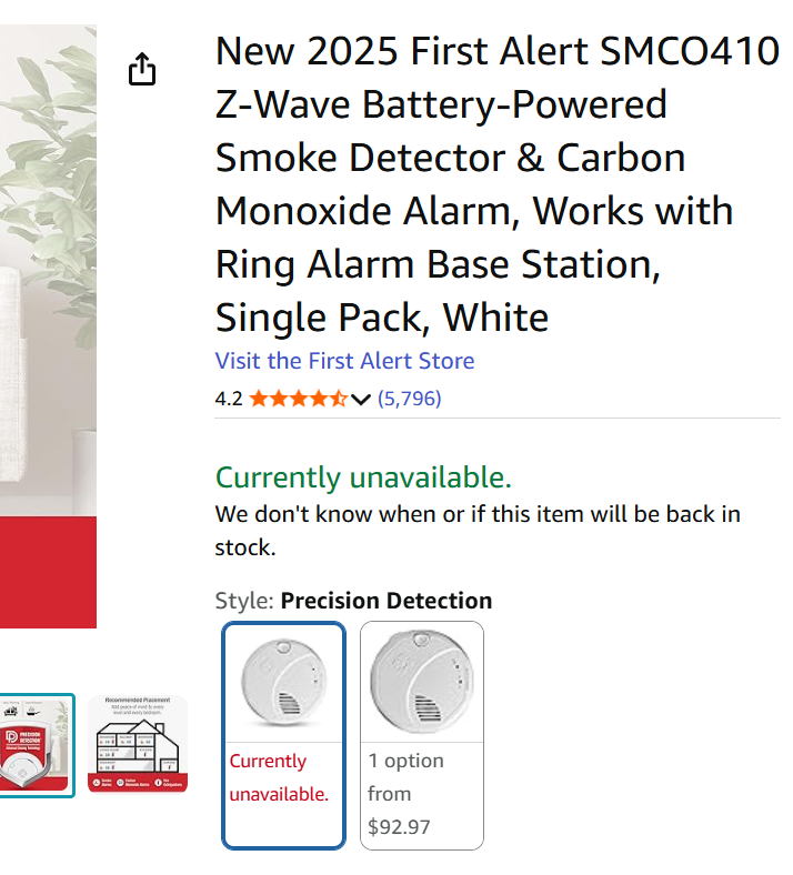

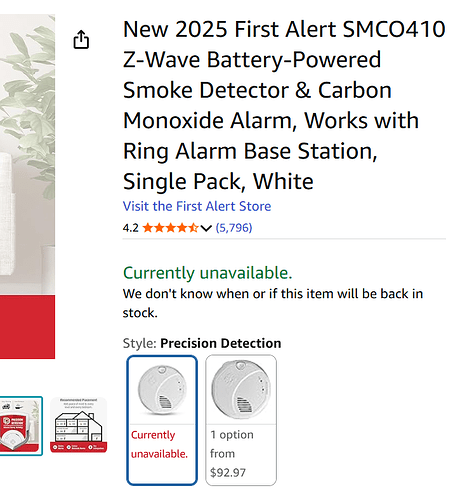

My Z-Wave First Alert detector from 2017 is doing the 5 chirp end of life every couple minutes, so the batterys have been pulled. Looking at the Amazon order it was $44 back then. Today they want $75 for the next available model.
Searching reviews it looks to work with Hubitat. Anyone have an alternative they like? Otherwise I just get this one. Needs to be battery powered.
It's out of stock, but Lowe's (the only other approved retailer I see on their site) has/had it for $60. It would still be my pick if I could find it. They don't note it as discontinued, so I'm assuming it will be back eventually. The Amazon price, which I don't see anymore either with it being totally out of stock there now, might have been inflated due to low stock.

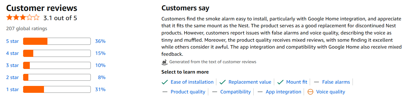

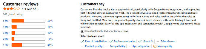

Quick check on Amazon - it does not look pretty. Dings on Product Quality, Compatibility, App Integration, and Voice Quality. Amazon reviewers not noted for high quality themselves, but not a good first look.
Also finding similar bad news on Reddit, particularly false alarms, bad voice, not happy w/remote silencing.
Family LOVES the Protects, esp wife...sigh. I do have a while to make my plans, just looked up my dates on my Protects and they don't expire until late 2030. Hopefully FA will have their replacement working well by then, or other appealing options appear.
I fact checked you. I pulled a FA hardwired product and it has 4.6 stars with 27 thousand plus reviews.
