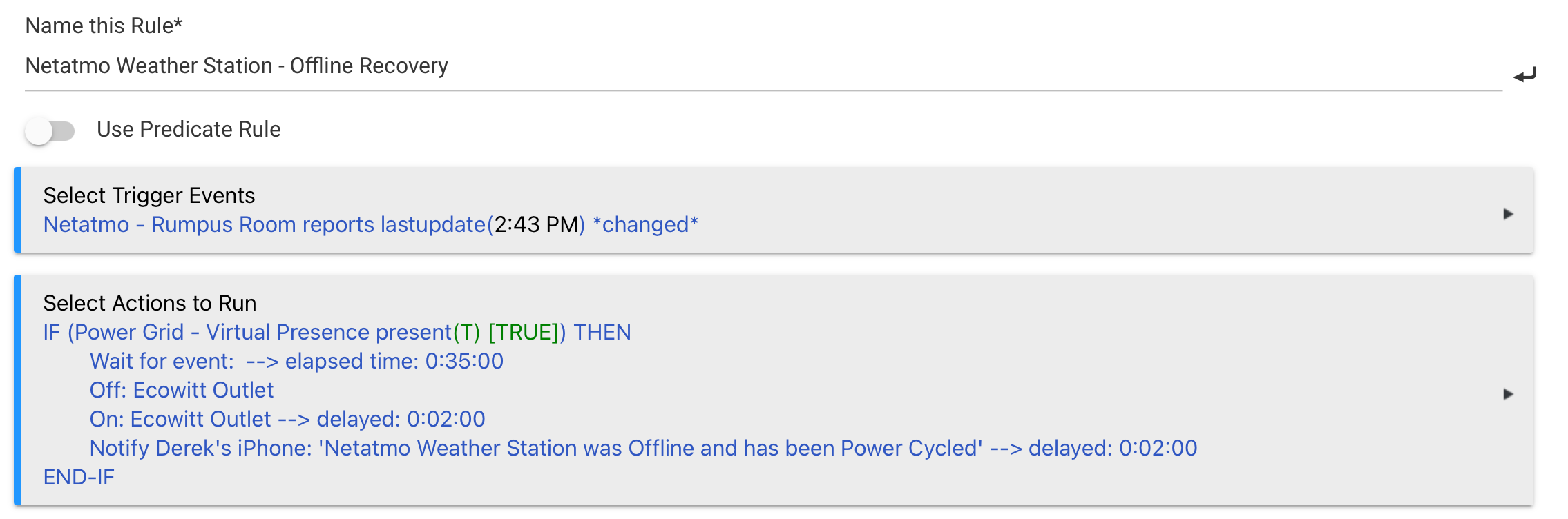

An outage is possible. I monitor my Netatmo's for a temp change. If there hasn't been a change in 3 or 4 hours, I restart the unit. It restarted yesterday and alerted me about it
There's a better option - monitor the "last update" field on the main unit:
My rule is on Github if you want to use it - if the Netamo goes offline, it power cycles it via a smart outlet (ignore the name, I need to change it).
https://raw.githubusercontent.com/dJOS1475/Hubitat_Netatmo/refs/heads/main/Netatmo%20Weather%20Station%20-%20Offline%20Recovery.json

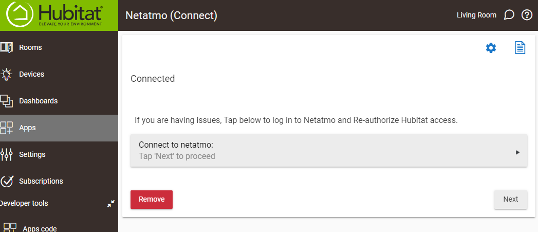

I've had this running smoothly for a few years until a few days ago when my Netamo devices stopped updating (Saturday at 7:55P CT).

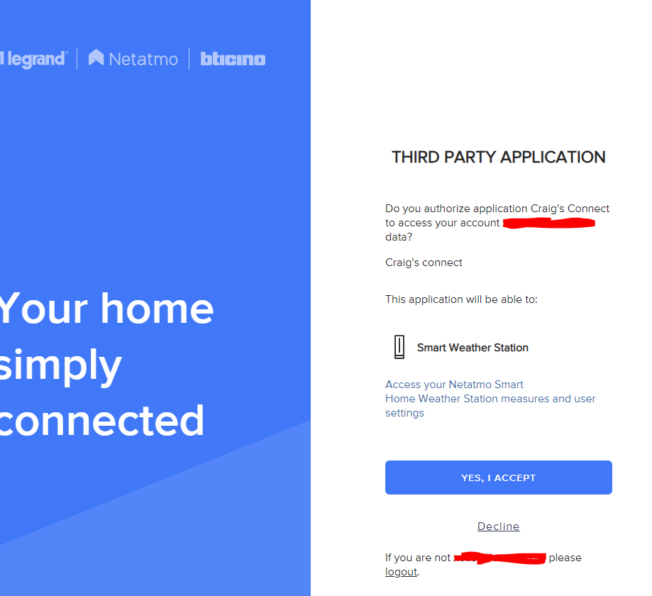

When I go into the App and hit "Connect to netatmo" to "reauthorize", I am taken to the correct "dev.netatmo.com" page. However, when I click "Yes, I accept" I'm taken to a 'cloud.hubitat.com' page which appears to be linked to my hub and my Netatmo app, but I get a 400 error.
Has anyone encountered this or have a workaround?
I've tried reinstalling the app, and initially get to a successful connection page on 'cloud.hubitat.com' but then the Netatmo devices are not created. When I go back into the app and click "Connect to netatmo" I go into the same loop described above resulting in a 400 error at cloud.hubitat.com.

Netatmo connect page, where I hit "Yes, I accept"
cloud.hubitat.com page which loads after "Yes, I accept" from the prior "Netatmo" page, resulting in a 400 error.

EDIT: updating to note that I have upgraded my C8 to build 2.3.9.197 (this was also happening on 2.3.9.196) and have rebooted the hub
