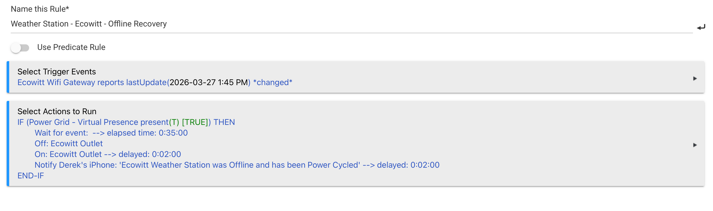

So thinking about this, Lastupdate does what you want - if your Netatmo goes offline, this won't update until it comes back online. I use this myself with a smart outlet to power cycle it when this happens.
You can test this by pressing the capacitive touch button on top of the main unit, and then hitting refresh in the driver.
The ecowitt weather station driver works the same way:
