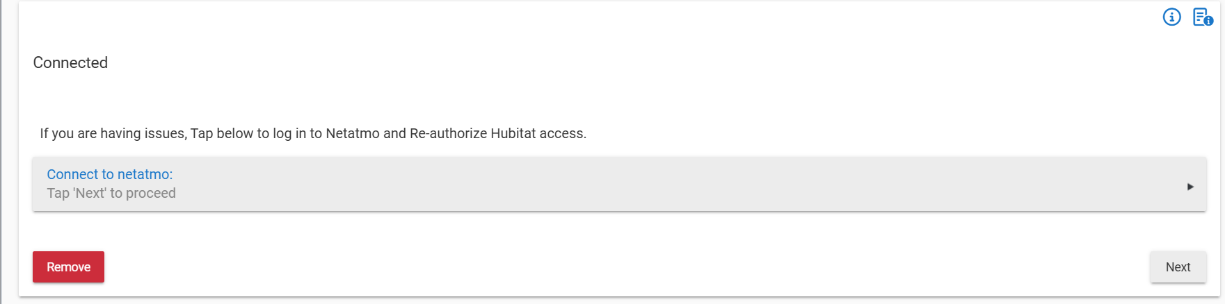

How do i update the hubitat app with the new cloud app details?
this is the only options but its failing
Hmm, you might need to uninstall and try again from scratch if the re-Auth button doesn’t work for you,

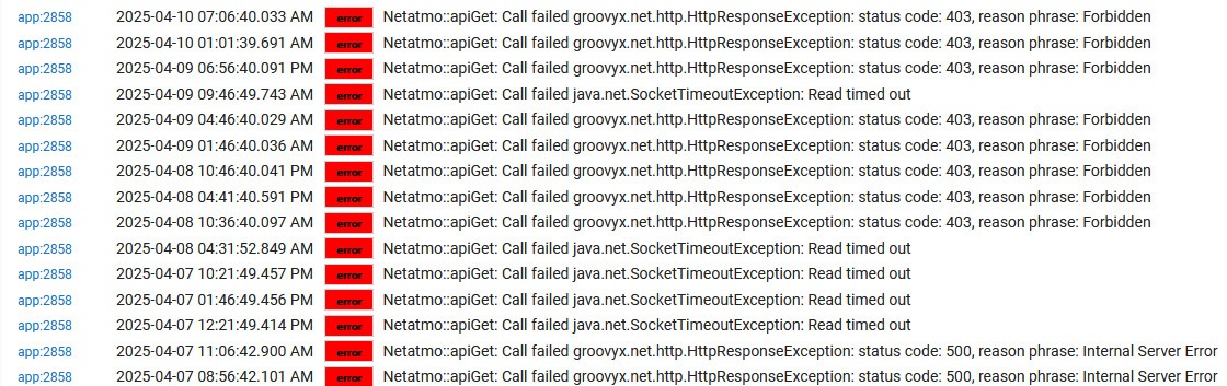

My Netatmo devices appears to be reporting to Hubitat but I just noticed errors in the logs that have been occurring for at least the last month:
These appears to be Netatmo's API timing out or responding with 403 and 500 errors?
Are others seeing the same errors?
I see them occasionally too, it’s just their API having issues.

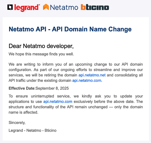

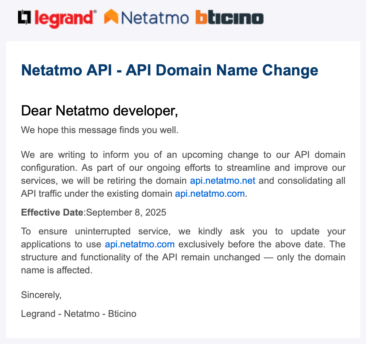

Hi All, if you got this message, dont be concerned, we are already using api.netatmo.com .

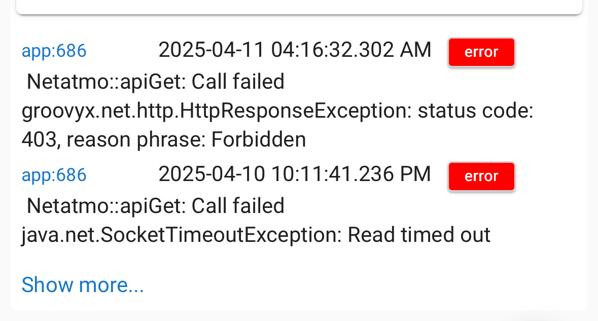

Too bad. I was hoping the change would fix:
and
and
I just enabled debug logging and will post more detailed logs once available.
Netatmo's API is not the most reliable - I just ignore those errors.

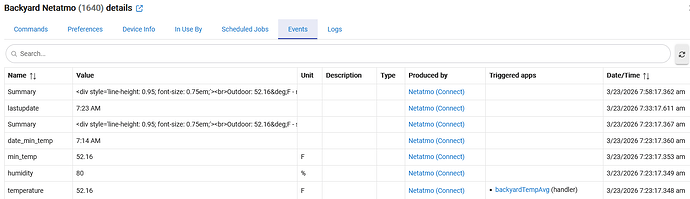

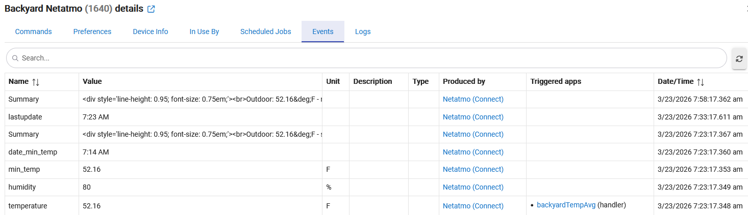

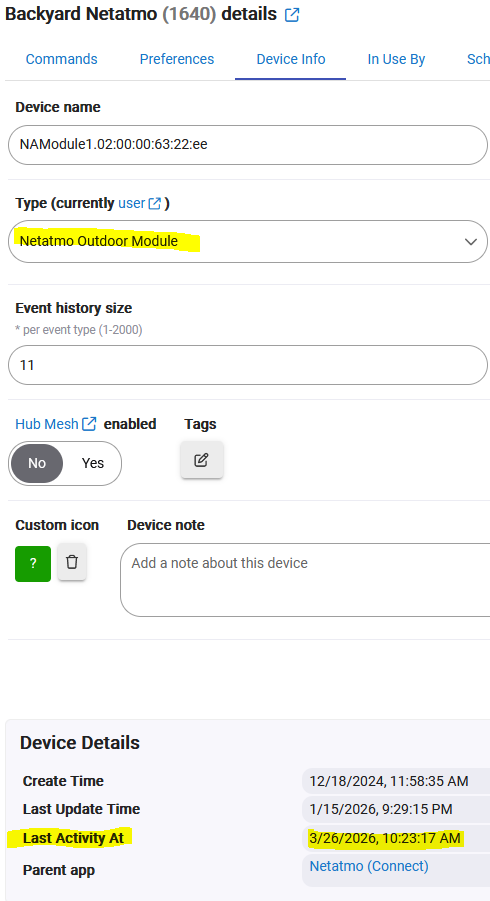

This device has been offline for a few days but it appears the driver is still reporting activity:
Last update is the last time Hubitat got data from Netatmo, not last activity.
