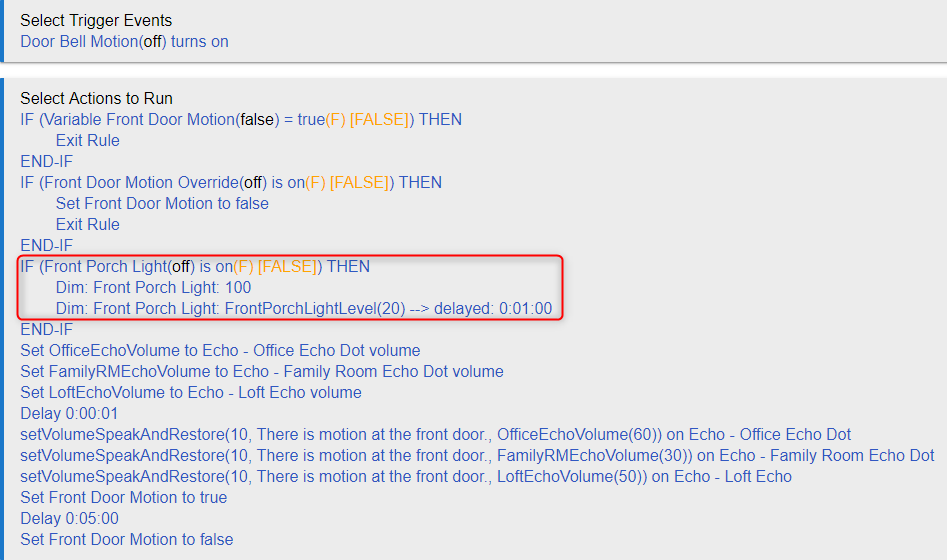

I am just looking into this integration but as others said, just using the Alexa integration with virtual switches you can do this easily. Here is what I do if there is motion at my front door as an example. I only want this to happen once every 5 minutes in this example. For the light, if there is motion I set it to full brightness and then after a minute, I set it back to the previous value.

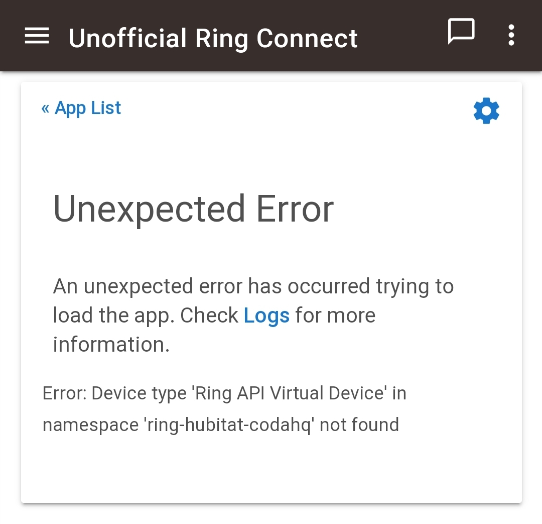

I also had a strange issue in that when I started the app it gave me an error that I was missing the API driver. I thought that was only required for Ring security devices. I added it to see what would happen and then got stuck with no devices to select.

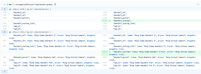

The Doorbell 3 Plus is now known as "scallop", so the discovery entry needs to be added to your code in those two spots (exact location will depend on the version you are on), hopefully @ardichoke can get this pull in officially for the next update so no-one has to manually do this.

I don’t really know Groovey, but I can copy and paste with the best of them. Your detailed notes and picture made it very easy and I was able to connect my Doorbell 3 Plus.

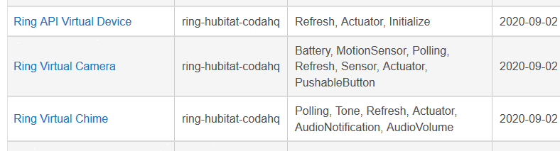

Should I be seeing more than the following exposed from this device?
When I rang my doorbell, there was no event captured and nothing in the logs. Pressing any Commands produced nothing either. I was expecting a button to make the doorbell ring and events that captured physical rings on the doorbell???
I still don’t see my Chime as a discoverable device for some reason. I have installed these 3 drivers:

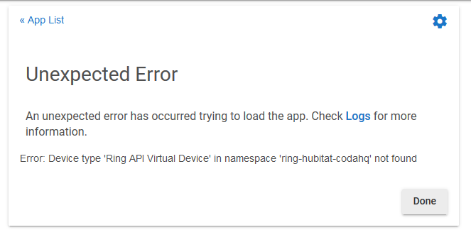

I did purchase the Chime the same time as the doorbell, but I don't think it is a new model. It is just the regular chime (does not include the WiFi extender). I am not sure why that is happening. I also not sure why I get this error after selecting my Location if I don't install the API virtual Device since I did not think I needed that:

Logs show: errorcom.hubitat.app.exception.UnknownDeviceTypeException: Device type 'Ring API Virtual Device' in namespace 'ring-hubitat-codahq' not found on line 1708 (mainPage)

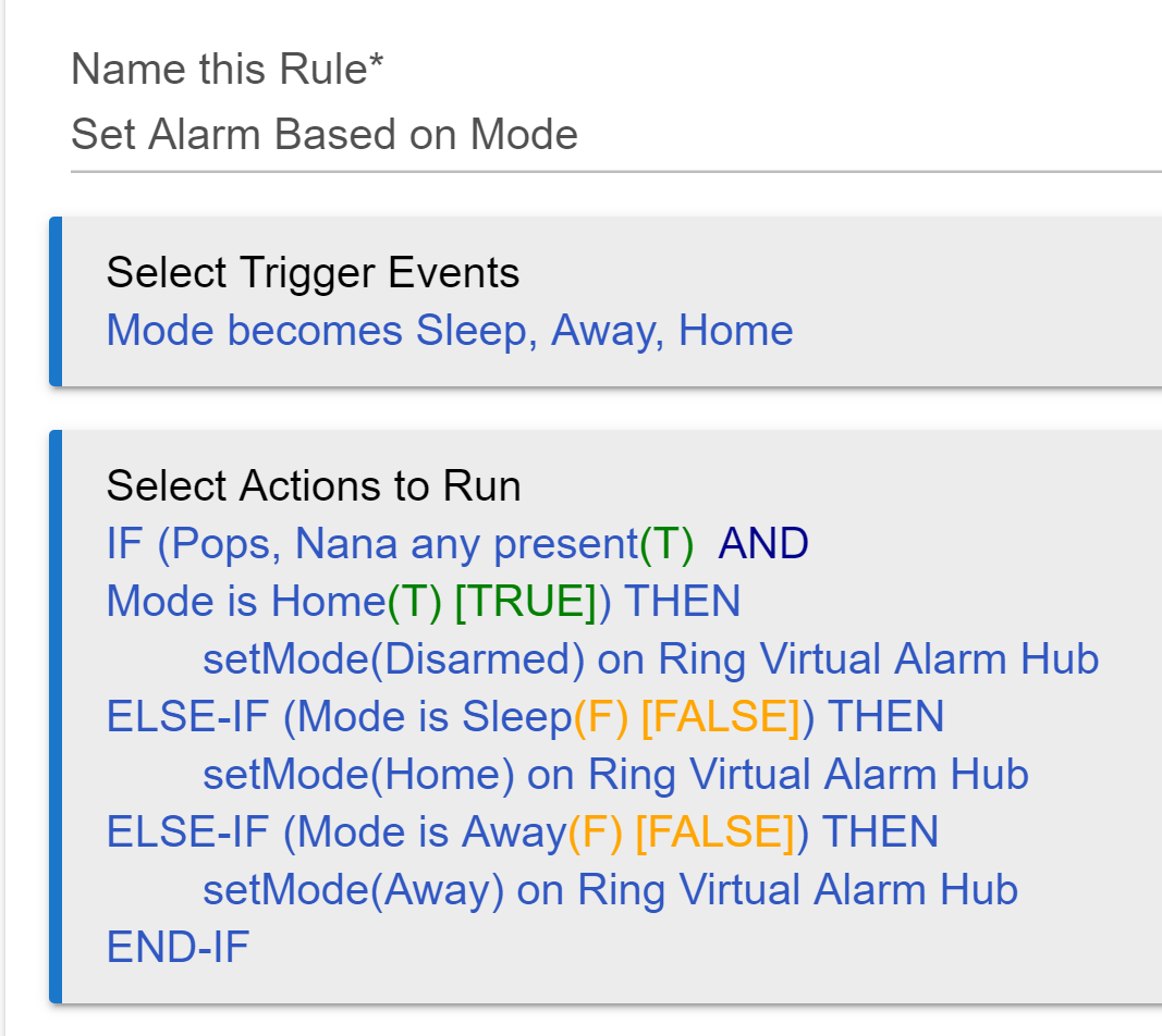

I personally use this integration mostly to lock doors and synchronize my HSM to Ring Alarm. That way, when I Arm HSM, Ring will arm and vice-versa. I also have it disarm HSM with Ring. I have recently setup a rule that will detect if someone tried to arm but was not successful due to an open door sensor. Once the sensor is closed, it will automatically arm.

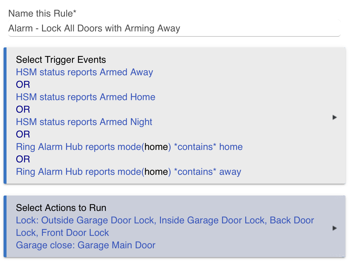

For the door locks, I have it automatically lock doors when the system is armed, and also throughout the day, but only when the door is closed. All things that can unfortunately not be done with Ring or within Alexa routines.

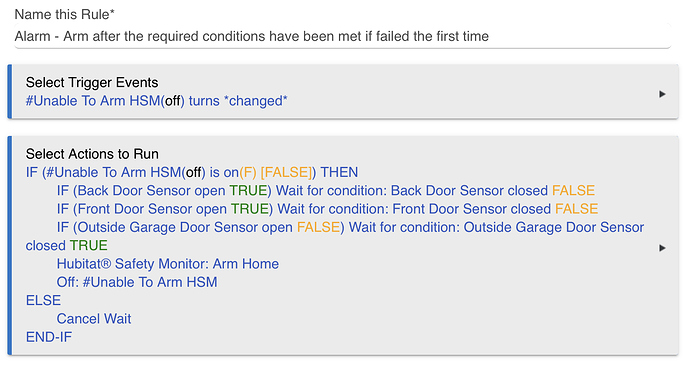

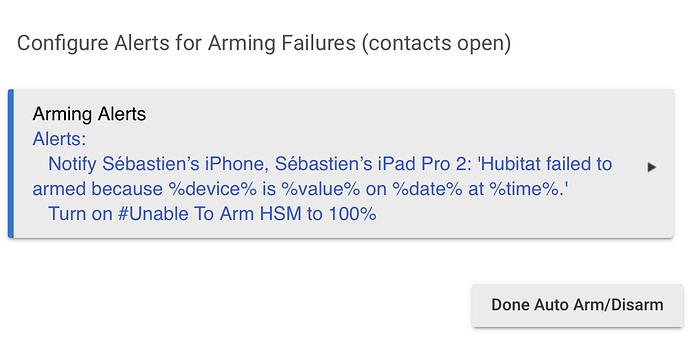

For it to work, I created a virtual switch called “#Unable To Arm HSM”. I then had HSM turn it on when it failed arming, along with a message to my devices:
HSM will automatically turn off the light. If I remember correctly, this happens I think after the system disarms after arming.
I also have the system automatically arm every evening, but it will not work if a door is open. With this code, as soon as all the doors are closed afterwards, it arms automagically! I also have code to arm my alarm system when HSM is armed, which is for me the most important part.
