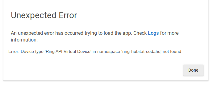

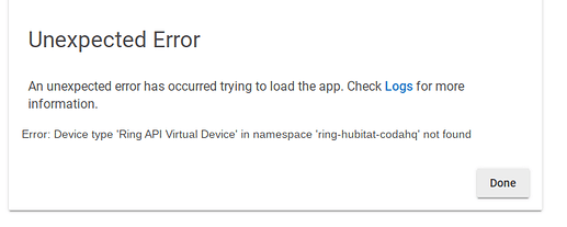

I just switched over to the version in HPM after running an older version for a few months.
Now when I try to get it started up it fails after login with the errors below. I'm able to get the 2FA code back from Ring and enter it and my locations pop up in the drop down. Once I pick my location I get the error in this dialog. The first error in the logs (bottom of list) occurs at this point and the rest after I hit "Done" on that screen.
Seems like I'm logged in, but then the App decides I'm not:
Any ideas to get past this point?
Thanks!
I reported this error a while back as did someone else but it seems to have been completely ignored!
You might want to consider rolling back to the last version (I believe this is the branch), that could help @ardichoke rule out if his merging in of the newer code that include camera thumbnails is the culprit.
Rolled back and all works again.
Yup, that fixed the login issue and errors I reported above. Thanks.
@ardichoke looks like something after the 2/29 change is causing the login issues. If there are newer versions than 2/29 and older than 7/22 that has the issue you would like me to try so you could track this down?
