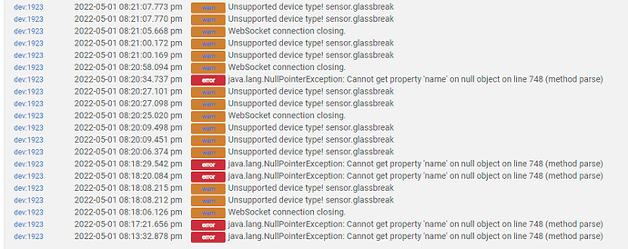

Just tried adding the glass break sensor but integration is throwing the following using the latest versions available through HPM
