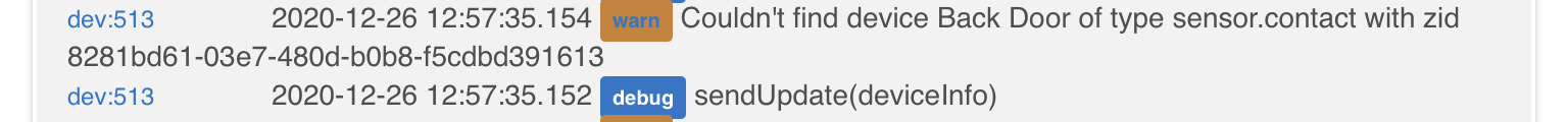

I suspect this log entry is related, but really not sure:
On another hub, a new install of Virtual Alarm hub detects the sensor and recognizes its state changes, so I know it can work.

Note that while I was transitioning, I kept both the old and new sensors on Ring. Until I removed the old sensors, I started seeing errors in my log (“Unsupported device type!”, “Couldn't find device Front Door - Old of type sensor.contact with zid...”, etc.). They all went away after I removed them from Ring. All good now!
