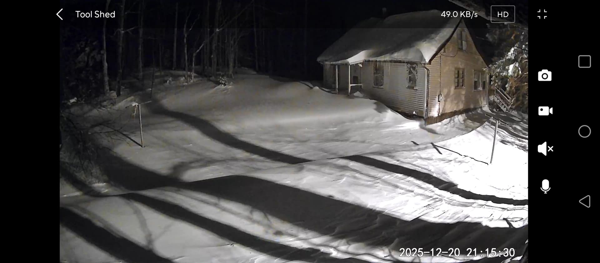

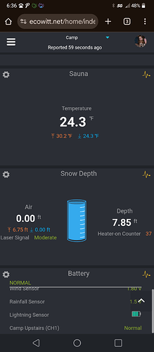

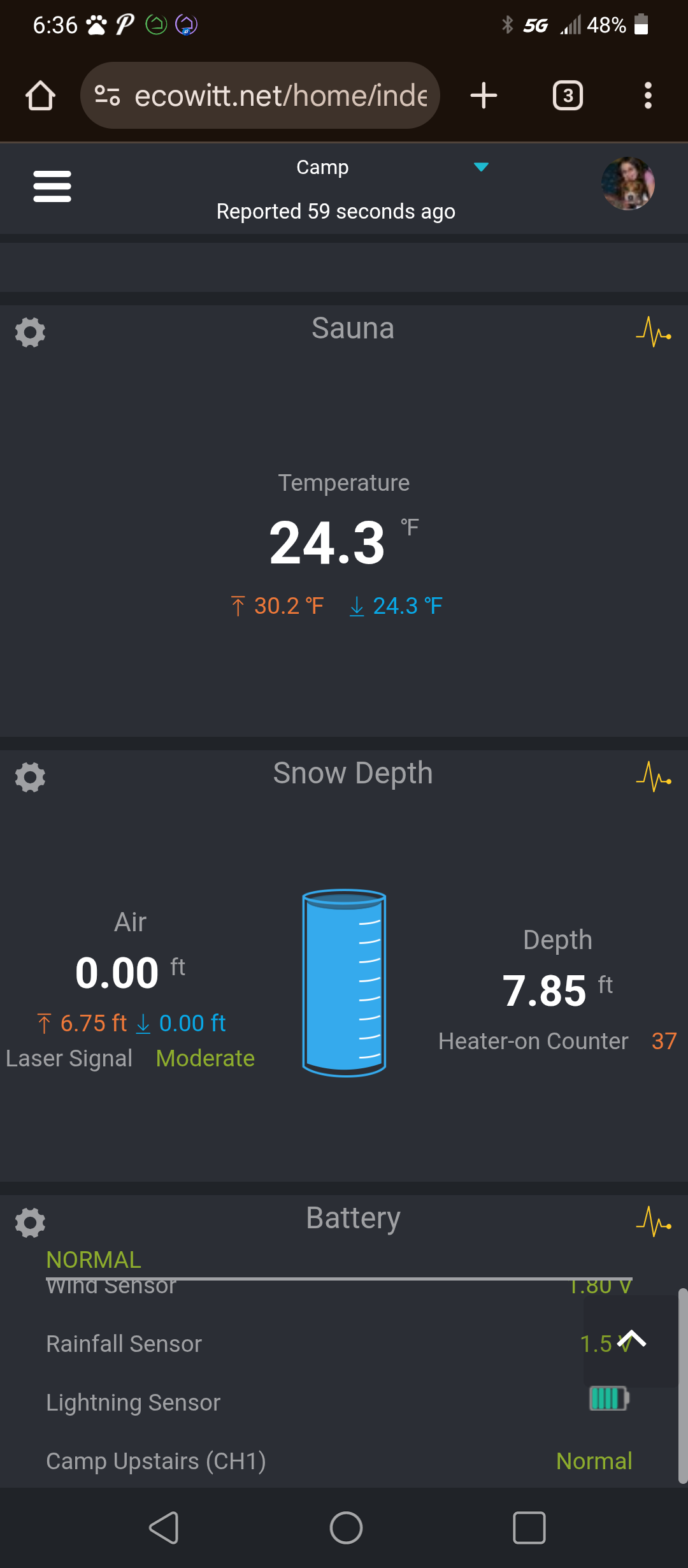

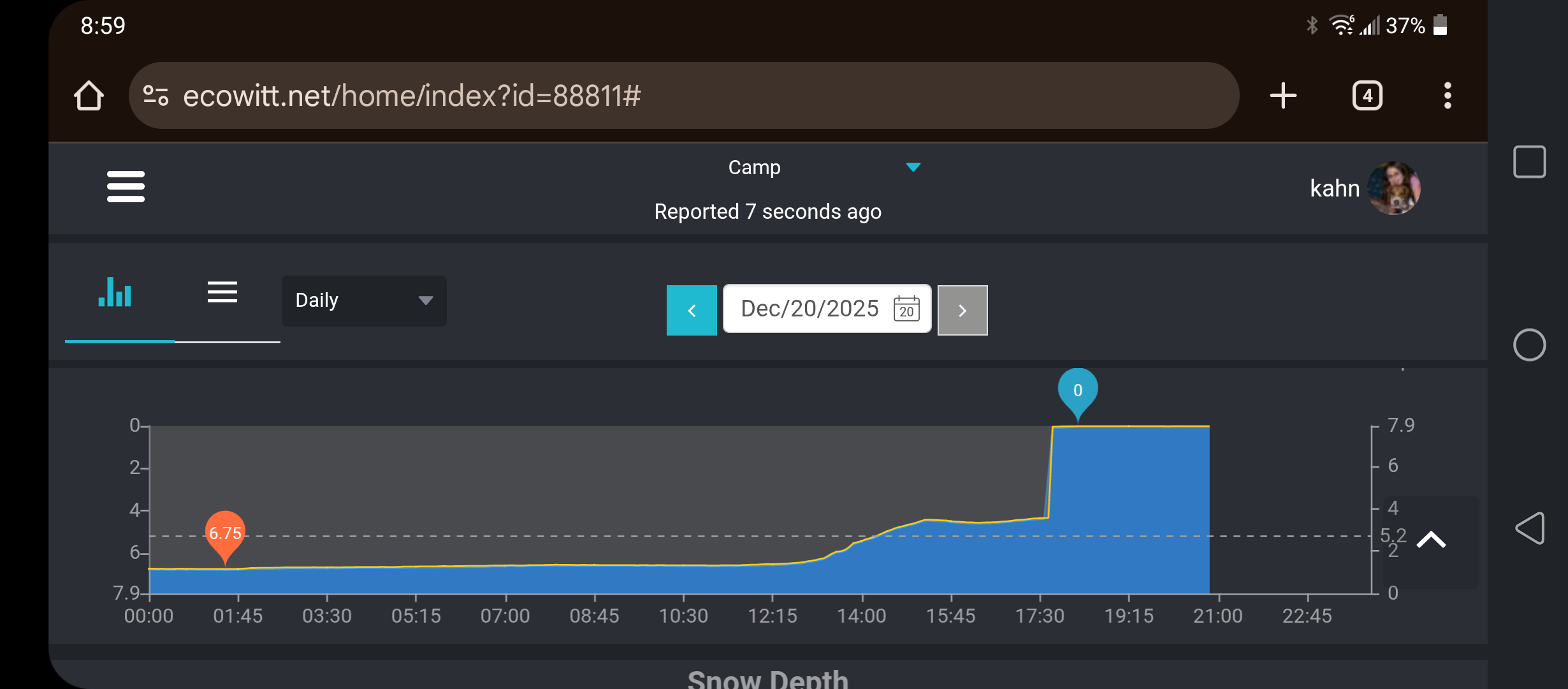

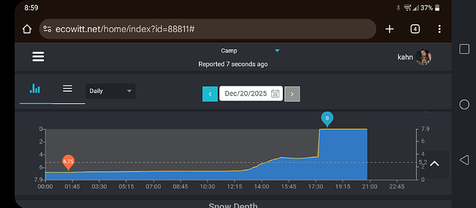

snow was recording normally about 2+ feet in a few hours but then even with heater think the sensor froze over
38mph wind gusts . think u.p. of mich is too harsh climate for the sensor lol
The best laid plans, eh? Nice effort, though!
