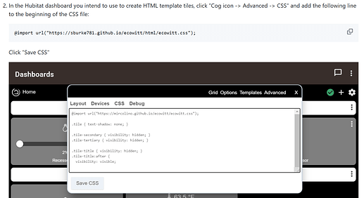

Thanks! I renamed my text file to ecowitt1.css and uploaded it to my File Manager. Easy. But I think there's another step to make the Dashboard tile work.
My pre-existing tile now says "Please Select an Attribute". But there's no longer an HTML option in the dropdown list. Do I need to update the Advanced area of my Dashboard to reflect the new template repository location? This is from the Read Me docs:
I assume it's just looking for the new template in the wrong place? How do I get it to reference the CSS file in my File Manager? (Assuming my guess is correct) Please advise and thanks!!

To answer your questions:
From what I explained above, this file is not the same as the one you downloaded. I would suggest continuing to reference it from the GitHub link, although I would also suggest re-pointing your Dashboard to look at my copy rather than Mirco's. While I don't believe there is any difference at the moment, if I do apply any changes in the future then you would not see these come through if you left this as-is or used a local copy.
So change that line to:
@import url("https://sburke781.github.io/ecowitt/html/ecowitt.css");
While now not relevant for your situation, based on what I just described, for future reference, if you do need to use a local file for any reason in the future, the equivalent link would be:
@import url("http://< he-hub-ip >/local/ecowitt.css");
using the IP address of your HE hub.

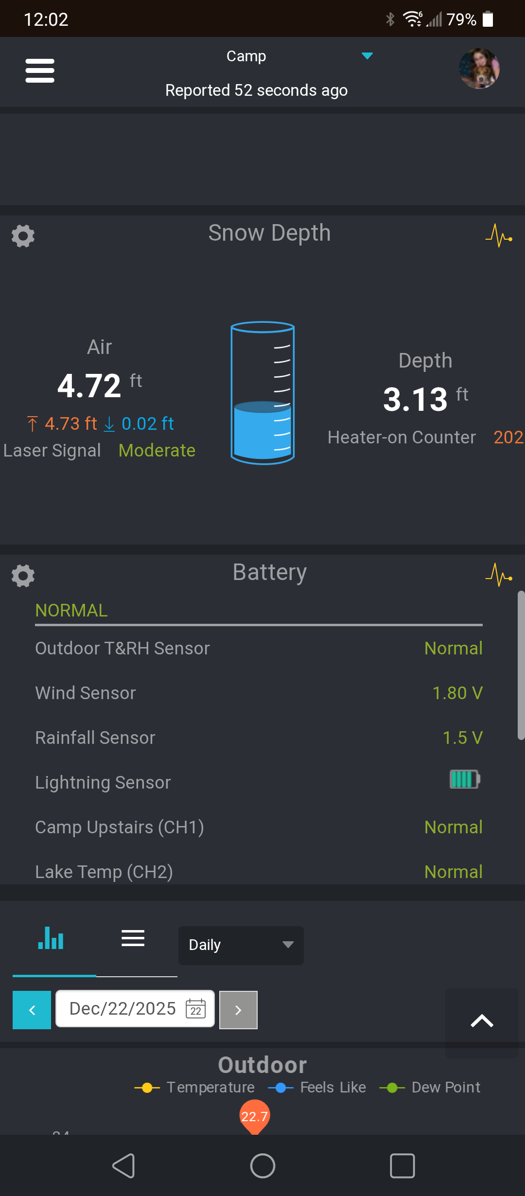

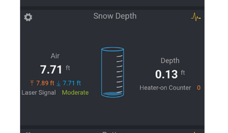

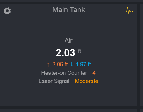

How did you get the ecowitt app depth sensor tile to look like this?
Mine looks like this:
i believe you need to follow the instructions and go into the app and go under the calibration section and put in the measured air depth from tip of sensor to ground in order for the depth be reported and shown.
Can't see in the app. I Probably need to log into the GW3000 hub interface and set it there my next trip.
no its in the app ws view plus or wsview but you need to be local.. so hopefully if you are not at the house you have a vpn or somthing to ge on the local net and run the app.
Found it! Its on the phone app, didn't see it on the PC app. Very cool..

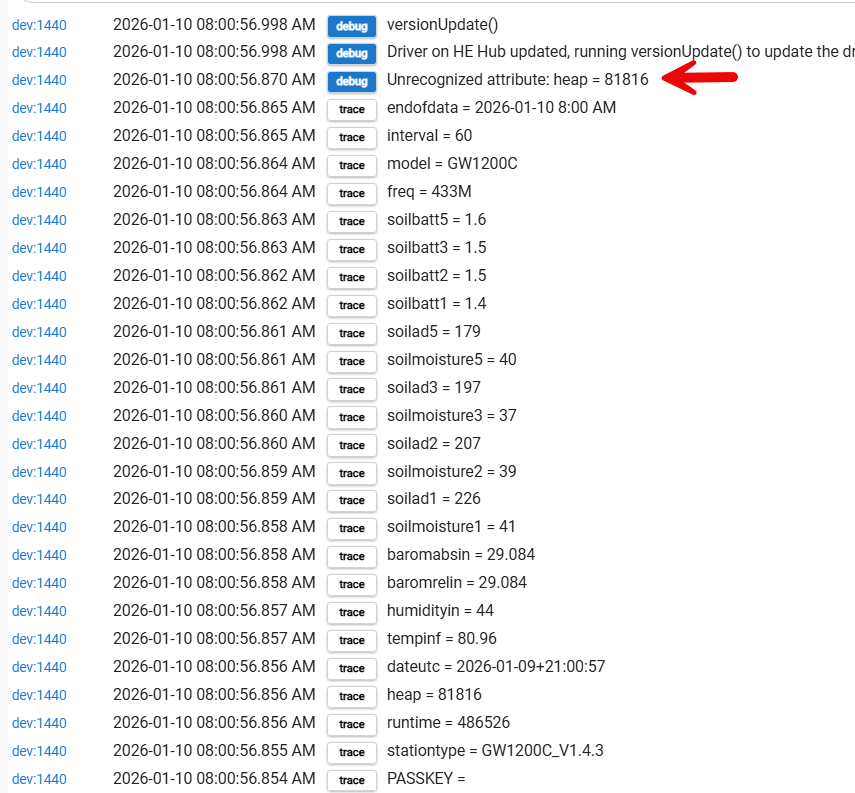

Thanks for offering your suggestion for the sensor signal strength. That is a good suggestion and one that would be nice to add to the driver. Unfortunately, from all I can see coming from my older Gateway, the RF signal strength is not something that is available in the data I receive... if more recent Gateway devices offer this in the data feed, I'd be happy to add it. To see what data is available, open the Gateway device in HE and adjust the Log Verbosity Preference setting to Trace and review the logs.
If anyone else has any thoughts on this, I'd be happy to take a look.... at some point....
Thanks Simon, I set the log verbosity as suggested on the newer gateway (GW1200C) and looks like the RF level of the sensors is not available.
There was only one attribute in the data that was reporting as unrecognizable, extract below in case you havent seen it before or of any interest.

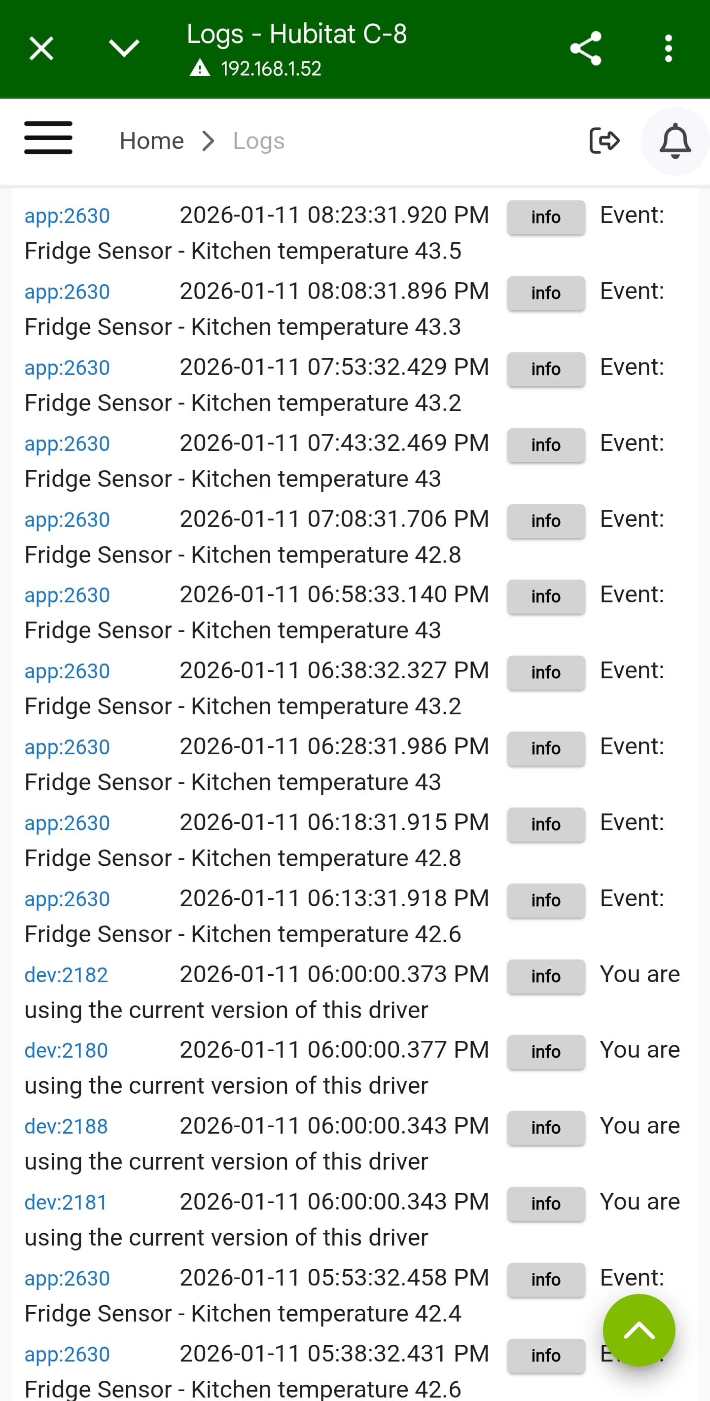

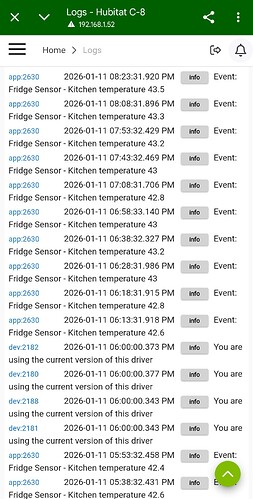

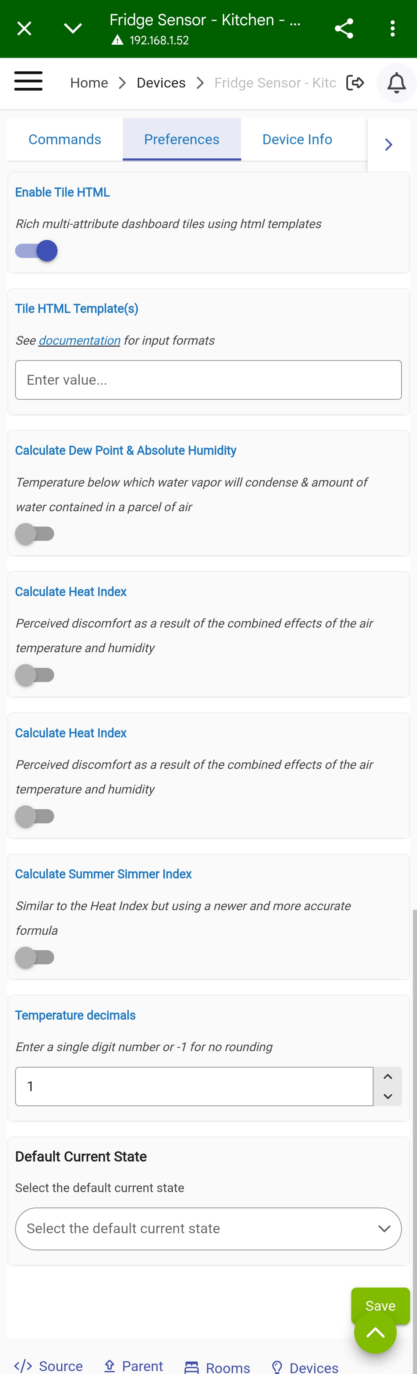

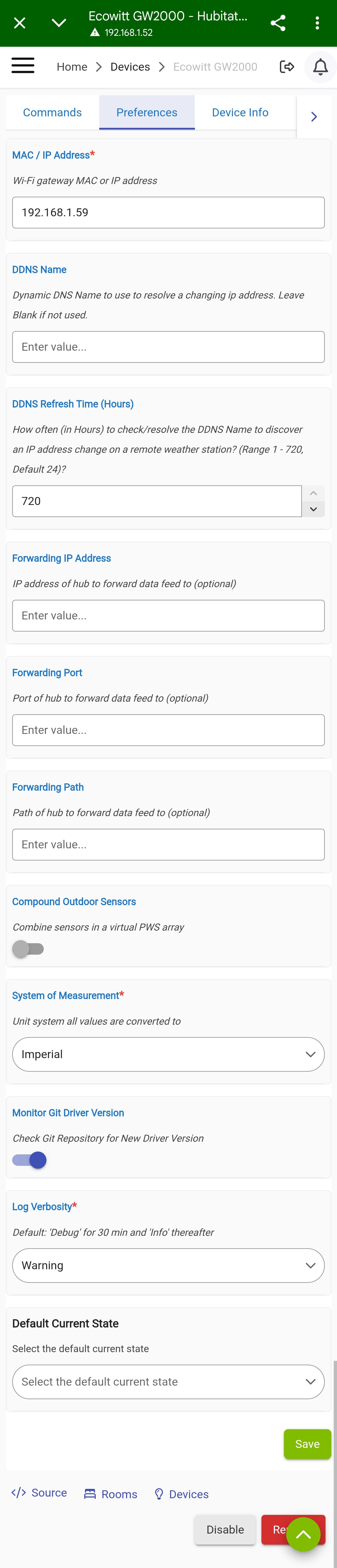

Hello, I've been using this driver for a couple years now with great results but randomly one of my sensors has started reporting a bunch of info logs. No other sensors do it and I have 7 total. Any idea why this might have changed?
Nothing springs to mind. Maybe send me some logs and a screenshot of the preference settings?
Here are some screenshots, the only thing I have messed with was the Log Verbosity setting. It was originally set to Info and I changed it to see if it would get rid of the info spam.
Sorry for the mobile screenshots, I can get some from my PC in the morning if you prefer.
