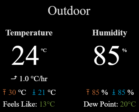

I was curious to see how close I could get to one of these tiles using Tile Builder Grid. This is what I came up with, its 888 bytes.
Are those values fixed (to do the prototype), or are you also calculating the high's and low's?
They are just values pulled from a device.
I don't know whether to be more envious of the great looking, highly functional tile you created, or the fact that you're reporting those temps in Celsius and I'm living through the same values in Fahrenheit. But seriously, nice work. Very similar to what one gets directly from the Ecowitt app, which I really like.
