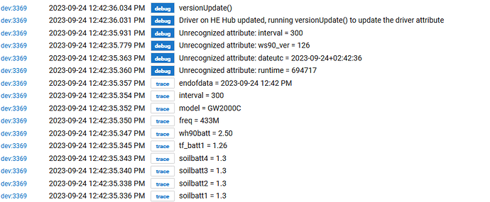

1.34.09 - Unrecognized Attributes - Runtime, DateUTC and gain30_piezo
When turning on Debug or Trace logging, for a long time now entries would appear in the HE logs indicating unrecognized attributes were found in the data feed. These are now being dealt with.
  • Runtime - A new attribute will appear on the Gateway HE device to indicate the number of seconds the gateway has been continuously running. Powering off the gateway and turning it back on will cause this value to be reset.
  • DateUTC - this is the current date and time according to the gateway, in UTC. This will be stored in a state variable for now.
  • gain30_piezo - This is an additional attribute that is returned by the Wittboy weather station. I have included code to detect that it comes through, but do not store the value at the moment.

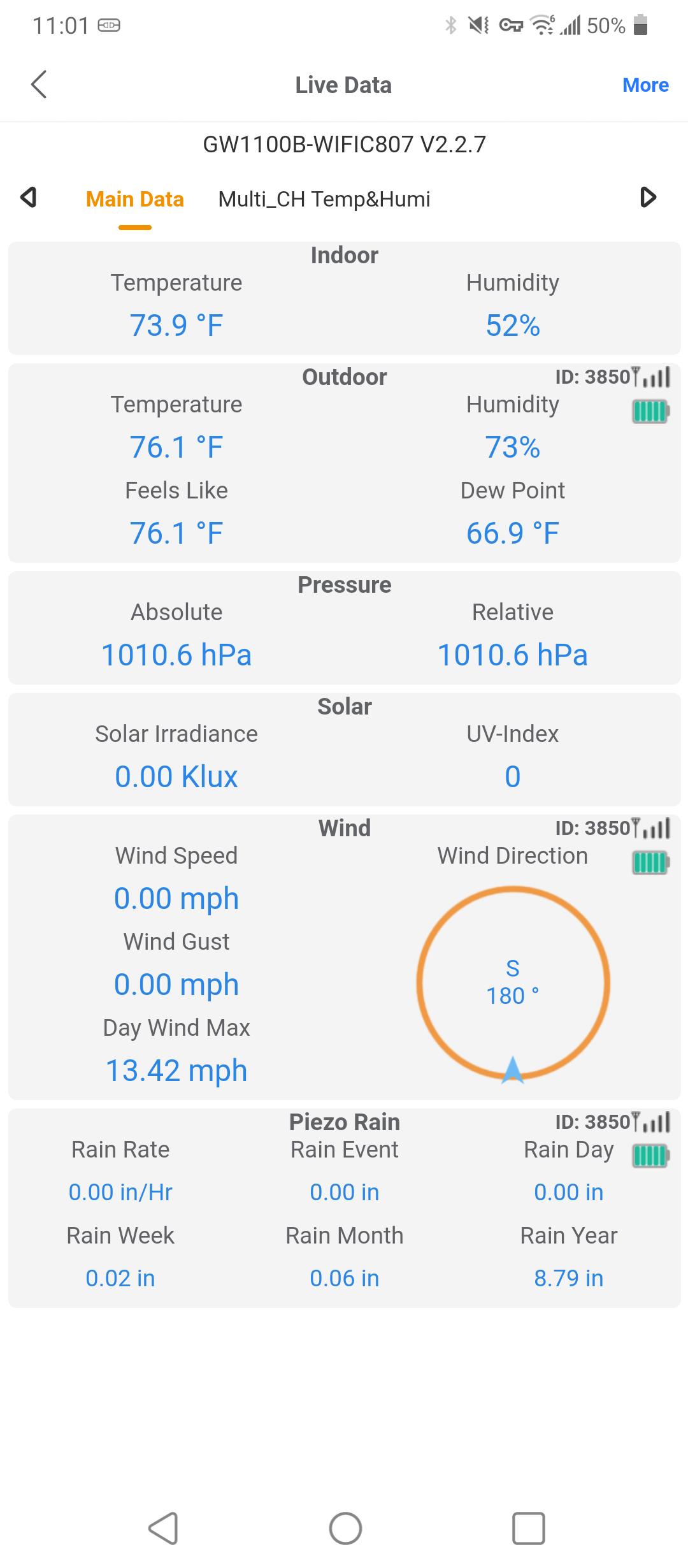

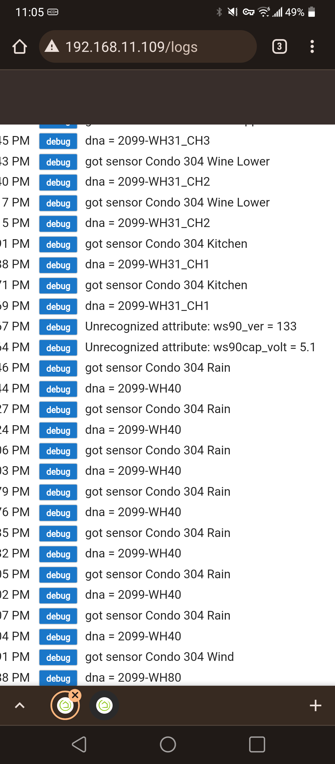

My Ecowitt GW2000 updated to GW2000B_V3.0.7 last night. I can look under the app and Live Data and see the sensors. But the sensors are not reporting on Hubitat. I just update the driver to the new version in HPM, but that doesn't seem to have helped.
So the sensors were reporting to Hubitat prior to the firmware update on the gateway? Try turning on Trace / Debug logging on the gateway device in HE, then monitor the logs in HE.
Also, confirm the data feed is still configured in the EcoWitt app on your phone / tablet.
Feeling stupid but I don't see where to turn on Trace/Debug logging in HE.
The router appears to be still configured in the app on my phone.
No worries, I probably should start referring to it as the Log Verbosity. It's in the Preference Settings of the Gateway device.

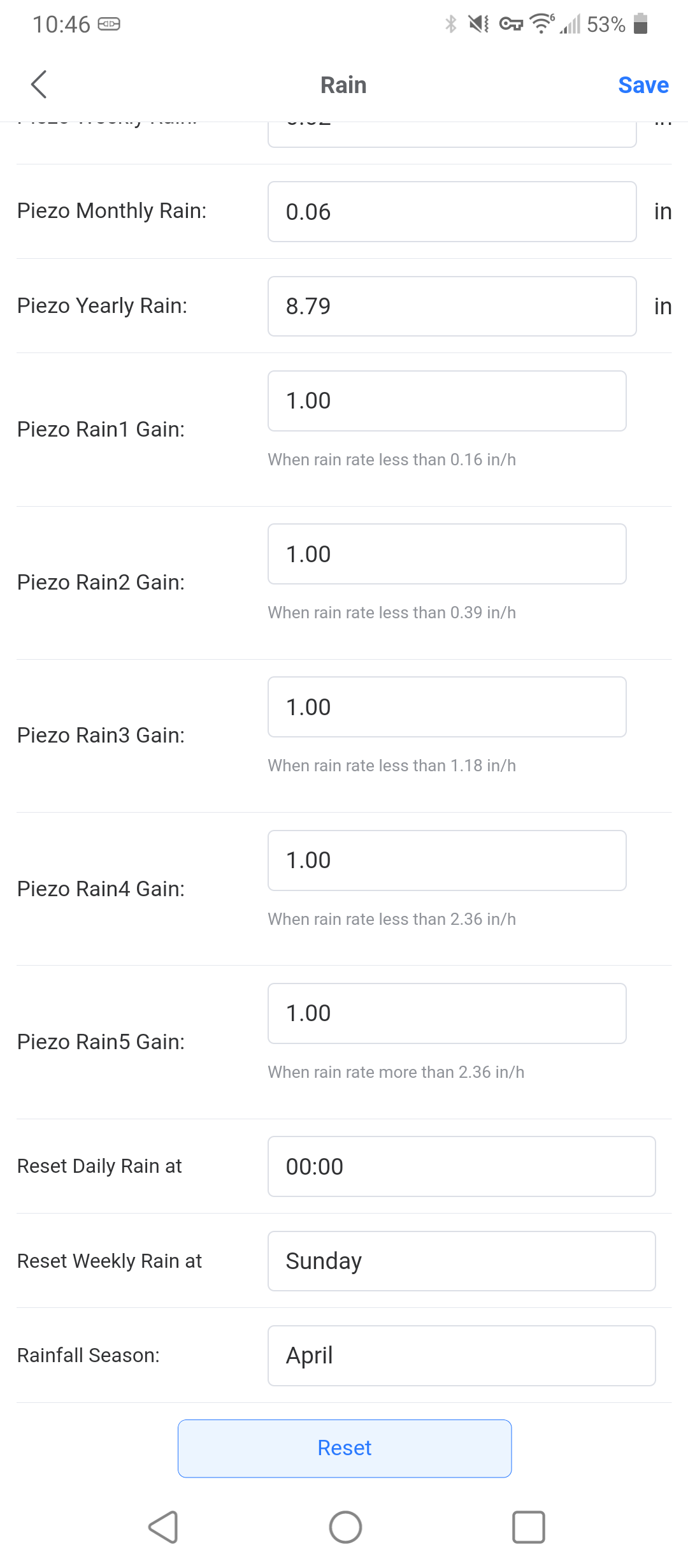

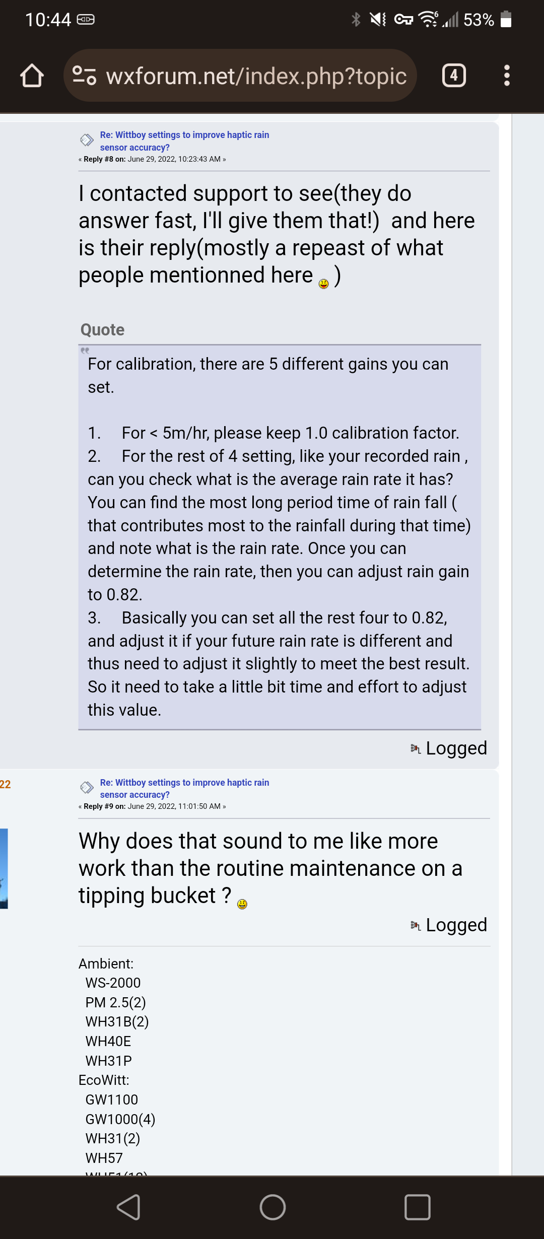

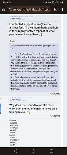

You can fine tune how sensitive the piezo rain sensor is for detecting rain . That is what this is for.
But not sure why only 1 setting there are five of them. ie so probably not usefull and why ignored it.

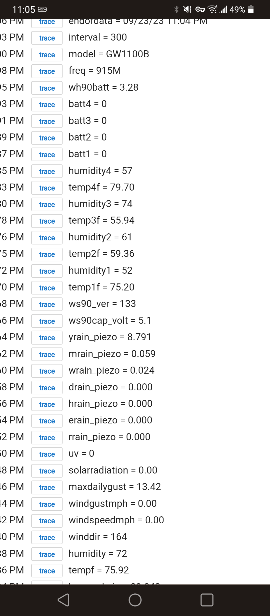

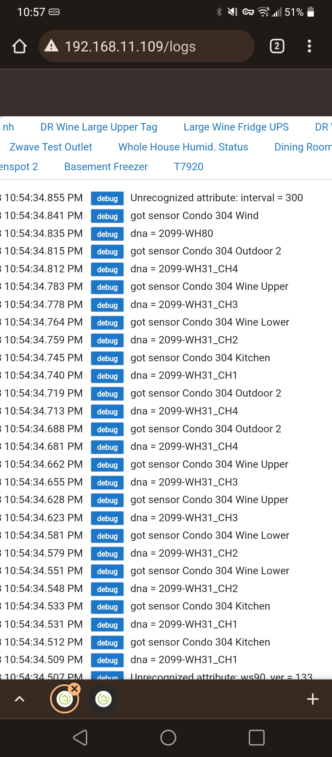

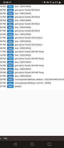

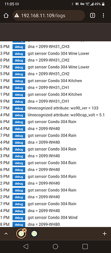

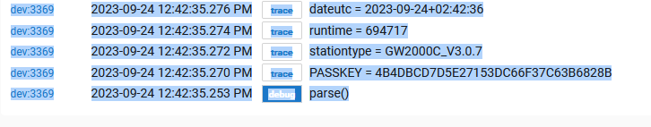

I turned on Trace Logging (note this appears under my WIFI Gateway device, NOT the actual external weather station - Witboy)) and it got busy :rofl:
FYI: The actual Witboy weather station doesn't have any selecting logging

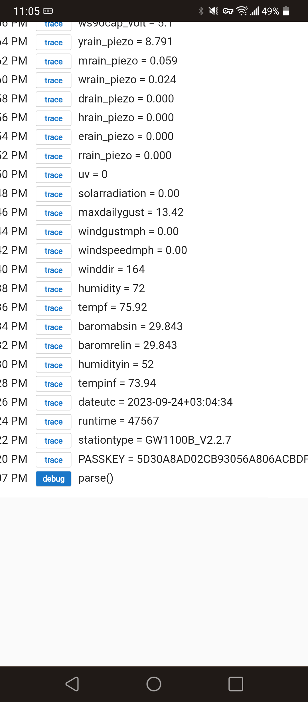

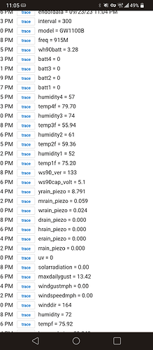

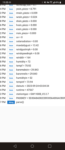

Do you get a station type at the start of the trace logs? Oh and thanks for checking on these.
yes..
Yeah, I know. In my thermostat driver I am considering taking the setting out of the parent device and placing it into each child device, but in that instance the child devices operate mostly independently of one another. In the EcoWitt drivers most things, i.e. the data, are funneled through the gateway driver, with just the values passed down to each sensor device to be recorded, so it kind of makes more sense to manage and record the logging through the parent device.
Ok, cool. That confirms that the gateway version (the V3.0.7 in the stationtype value) and the Wittboy weather station firmware version (the 126 in ws90_ver) are two separate things. So recording the firmware version on the weather station device was the right place to record it, and not just a change in the way Wittboy data was being captured.
Now I've discovered that there's a firmware update, I'm going to update the firmware in the Witboy. :rofl:
