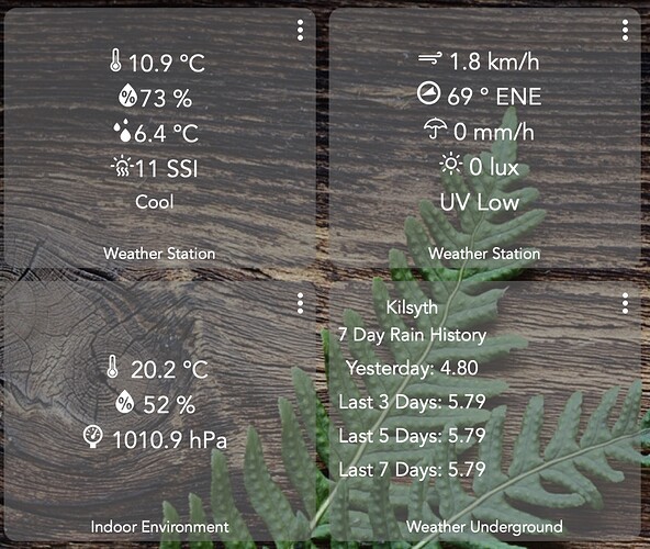

@sburke781 I've been meaning to ask this for a couple of weeks; would it be possible to get some more informative Dashboard tiles and detailed data?
I'm missing some of the data and info I got from Netatmo that I used in automations. eg recorded max temp for the day etc. It was really nice having a Dashboard tile with detailed info for each gauge / function. eg Netamo
Screenshot 2023-08-18 at 4.22.05 pm
compared to Ecowitt:
It looks like the data etc is all there - any chance we could get the extra data and more advanced tiles please?

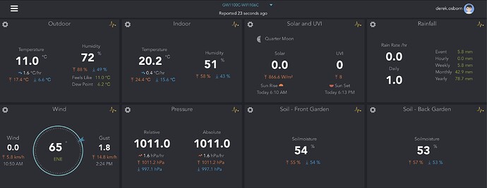

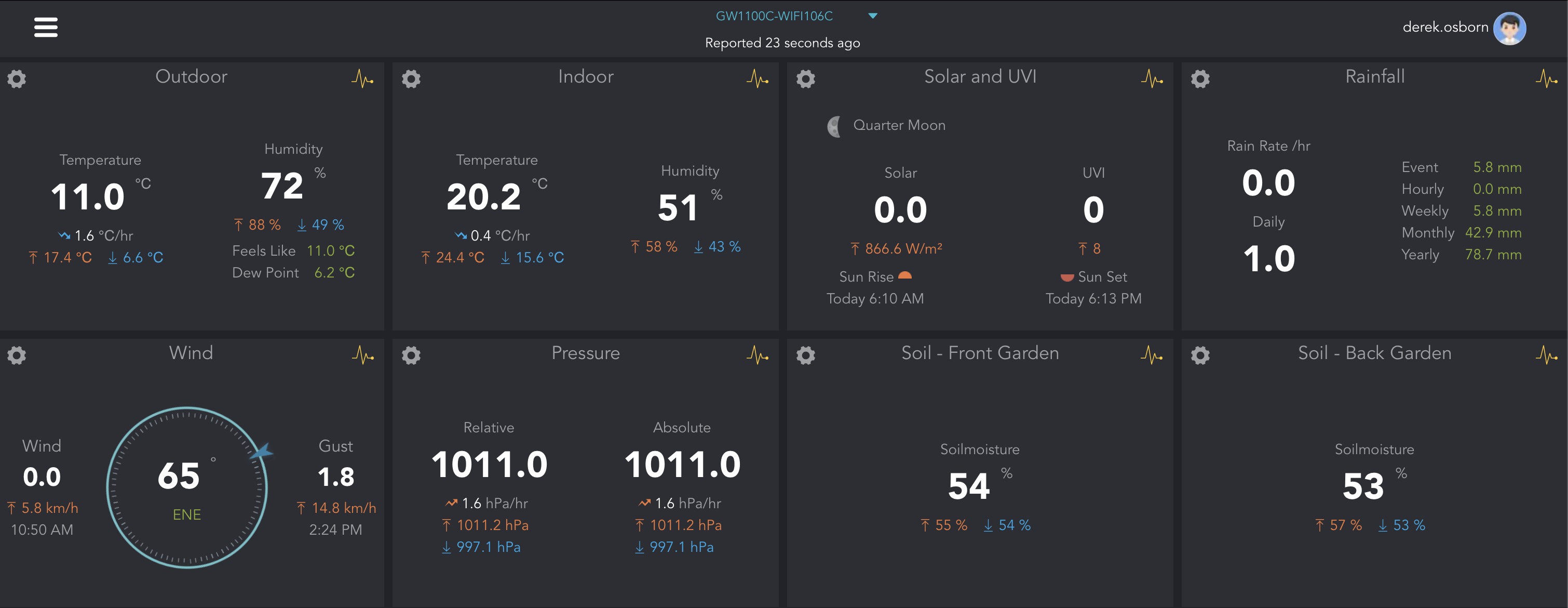

PS, here is how the Netatmo Connect app does it:

Looks like you received the min/max temps from Netatmo...? If I read the app code correctly. EcoWitt must calculate that on their side when displaying the dashboard, it is not sent from the gateway. Not that it means it can't be done, just that I will need to find the most appropriate way to implement it.
yep, Netatmo recorded them and they were available via the API.
Bugger, I looked at getting the data from WU, but it's not available from the PWS data as that is all point in time.
It's all good, I was actually expecting you needed to do it as well, so was just going to steal your code :wink: But not to worry, will definitely be possible, and a nice feature to have.
