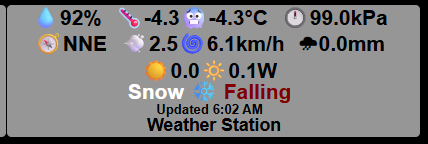

I have little HTML weather tile setup with forecaster, works very well for my needs.

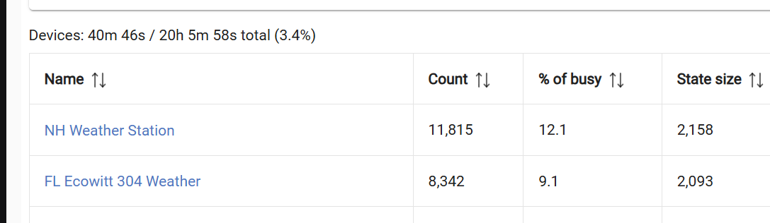

I understand you haven't had the opportunity to review my previous proposals yet. In the meantime, I have implemented several additional changes focused specifically on performance improvements.
Currently, my four Ecowitt devices and gateway account for over 55% of the total busy time across all 225 of my devices. To try and change this scenario, I have incorporated various optimizations, including some suggested by AI, ensuring that functionality remains unaffected.

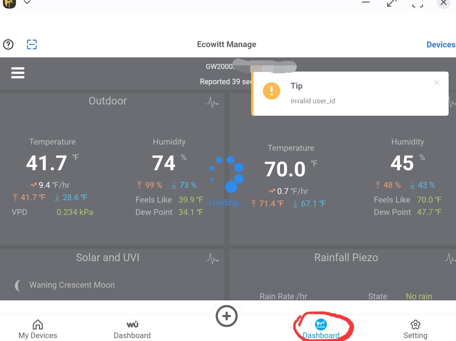

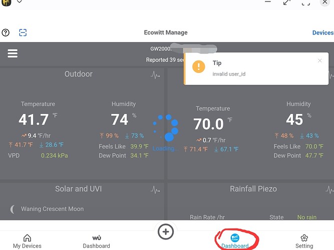

So, not necessarily related to the HE integration. Since we all are using Ecowitt, you guys might know the answer though.
I do not use the WS View app for viewing the stats very often. So, it has been a while since I opened it.
Opened it up to look at some of my graphs, and got the pop up message "invalid userid" as a "tip". Nothing was not working. Just get that message when I open the app, and/or when I switch back to the ecowitt dashboard from the Home, or WU Dashboard, or any of the others.
Doesn't seem to be affecting anything. Everything loads just fine.
Appears to be related to Ecowitt dot net login. But, that works just fine in a browser. There are no log in credentials for that stored in the app. So, not sure what is going on.
Pop Up Error
Haven’t seen that in the WSView Plus app on iOS, though I don’t have my weather station configured with ecowitt.net credentials, just the local upload to Hubitat.
PS: I can’t remember for the life of me why exactly I switched from WSView to WSView Plus sometime in the last few years. But reviewing their Apple App Store pages, it looks like only the Plus app is still getting updated.
That was kind of my point. There are no Ecowitt weather credentials on the app. You have to go to the website, then paste the MAC for it to start uploading. There is no where on the app that you can actually put in the credentials. (Hence the head scratching)
Also, I was referring to the plus app. I just got into the habit of calling it the WSView App. (Wasn't the non-plus deprecated?)
