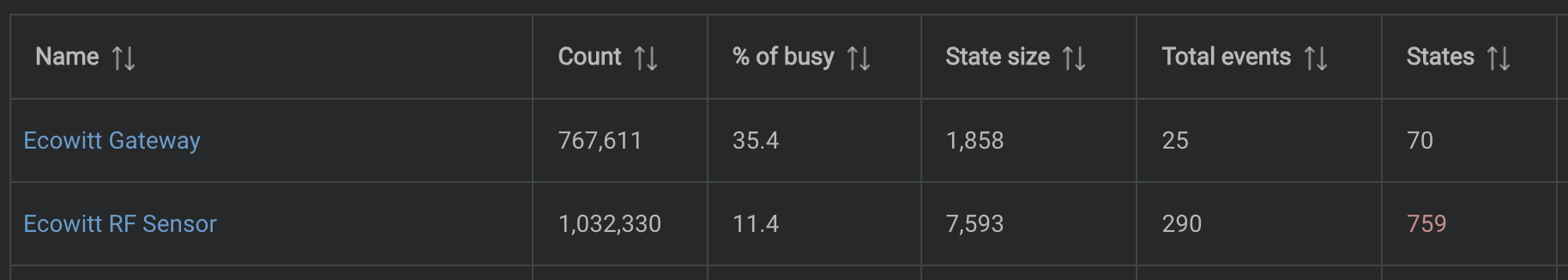

1) CPU Usage
  • Checking at Logs -> Device tab I have noticed that Ecowitt devices were by far the top CPU consumers.
  • The WS90 and GW2000B devices combined were responsible for 45%+ of the CPU time of all drivers! And I have more than 100 Zigbee devices, 5 Ecobees, plus some other LAN devices.

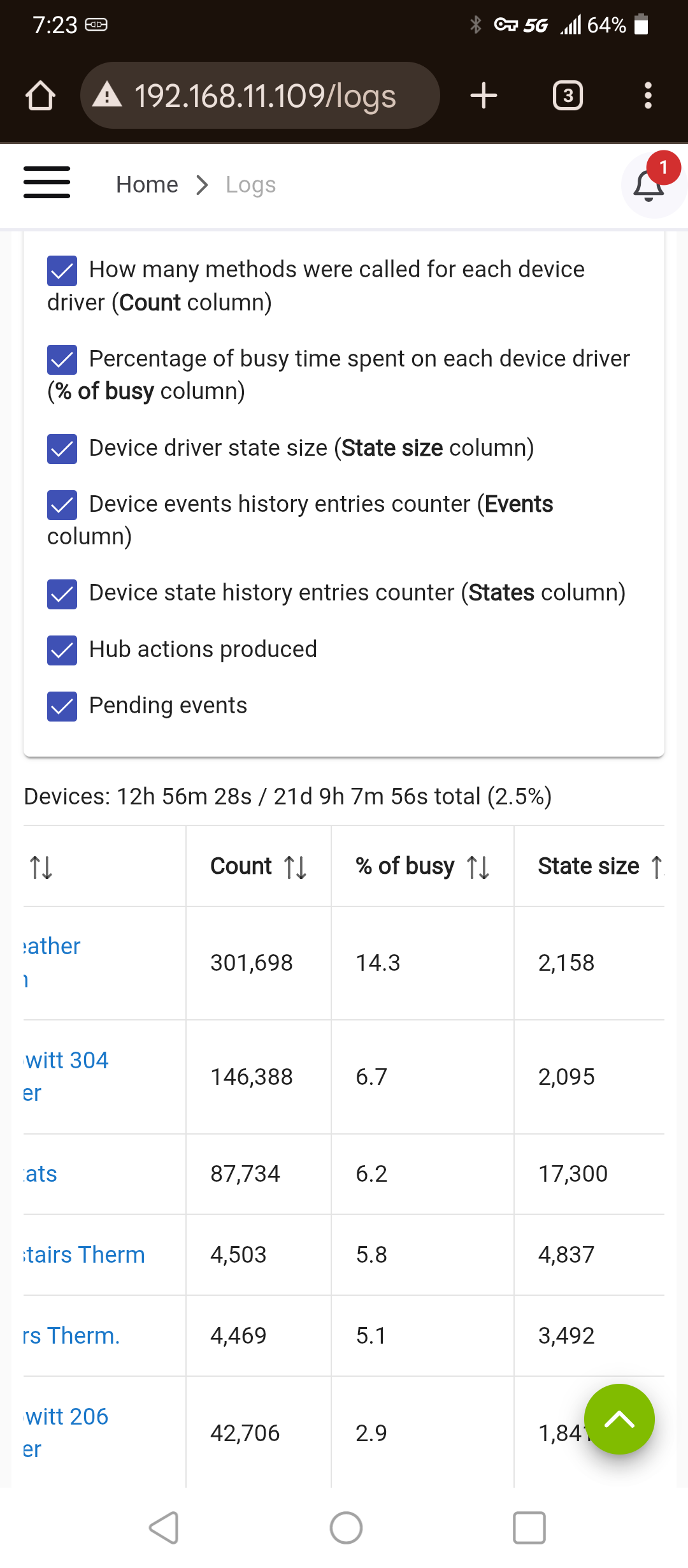

yes the percentage is high but you also need to look at the top percentage. here in my case the top 2 are indeed weather stations but if you notice the total is on 2.5% .. so not really an issue so about 20 percent of the 2.5 percent equal about .5 percent total
Wow, thanks for taking the time to work through all those changes @eduardo . I will need to read through your notes on more detail and let you know what I think.
Just chiming in. Mine only uses 0.3% of busy and has a state size of 1406 and is in 30th place in my list of apps when reverse sorted by %busy. I have the GW2000B, WS 90, 7 - WH31 Temp/Humidity sensors, and 3 WH51 Soil Moisture sensors.
My top two items are dashboards that are on my wall mounted tablets. The Ecowitt feeds one of those dashboard.

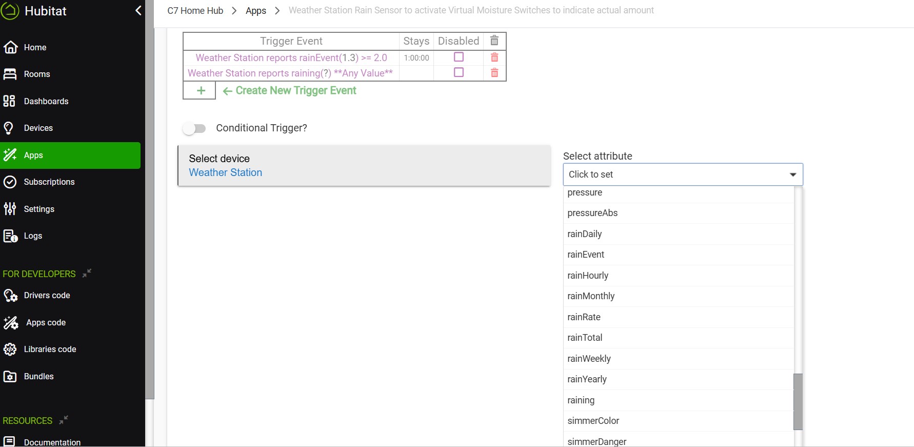

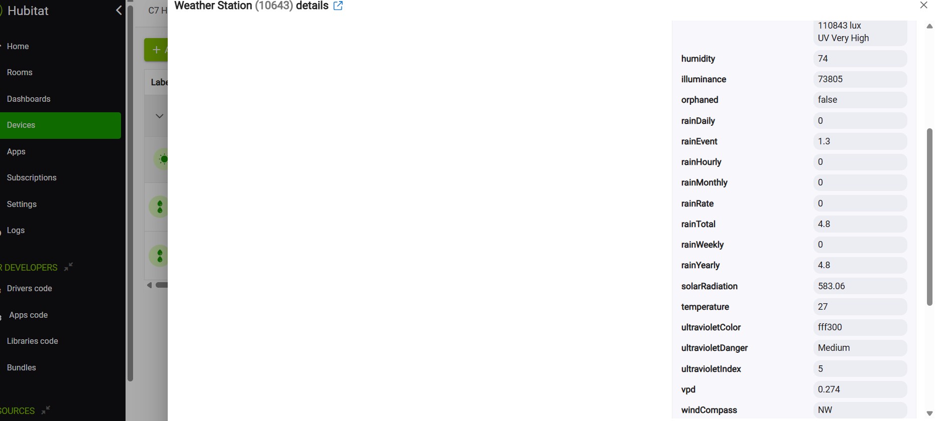

Hi All I'm after a bit of help with the available Attributes. I want to use Rain attributes to control the amount of watering that is done, which I think I'm OK with. The other thing I want to do is setup an app to advise when it starts raining so that the household can check that the rain isn't coming in through any open windows. I have senses on any window that is susceptible so have that part covered. In the 'Weather Station' device attributes I can see several 'Rain' items (see screenshot). However when selecting from the attributes in an App there is one called 'Raining' which is not showing in list in the device attributes. When selected in the App the value is showing as 'Null'? I thinkig that this currently isn't being collected in the Driver Code. Is this correct? If I can't select 'Rain' what can I use to notify that it has started raining, & then what do I use to know when it has stopped? Thanks in advance for any help
Probably rainEvent, but I’m not sure if that increases as accumulation is happening or once it has stopped. rainTotal will increase, so you could look for a change in that to trigger a “raining” indication.
If it is like the display on the EcoWitt dashboard rainEvent would be an accumulation as it is happening, potentially over midnight.
@greghoward1962 - You could probably use either rainEvent as @SmartHomePrimer suggests, or the rainRate. Probably worth considering how sensitive the sensor is, as well as other factors that could influence rain coming in after it has started, like wind direction.

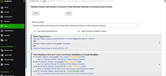

OK when you get time, its a work inprogress. It hasn't rained here since about 10pm last night, 'Rain Event' was showing 1.3mm at around 7.30am & is still hasn't changed. Rain Hourly is currently 0. So maybe that can be used to turn it off??
Is there a way to find out how quickly the Attributes react? I would have thought that 'Rain Event' would have reset after purhaps an hour?
Can you help (or advise where I can get help) with how in Rule Machine to get a trigger for if say the 'Rain Event' attribute increases or decreases?

I believe i added a raining attribute in the last couple of years. just checked I did. but that attribute is only present and reported for ws90 wittboy
EDIT - You are likely right.. and I did not read your post closely enough.... (Was watching the Men's Final of the Aus Open Tennis).... I'll need to check it when I get a chance to see what is the best attribute to use and how best to detect the rain.
