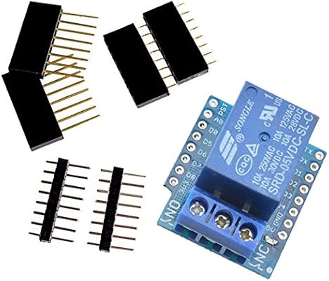

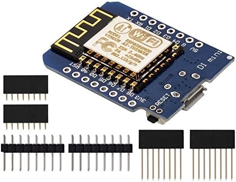

If you're looking at using Hubduino and you just want something for your garage door, I would recommend using a Wemos D1 Mini:
With a "realy shield".
This can be powered by a Micro USB power supply and requires less wiring than a separate relay. The Relay board is powered/controlled by header pin connections from one to the other. You can then wire a contact sensor (reed switch) to one of the other pins on the D1.

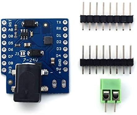

Yes, I use those boards all the time. The advantage of the combo I linked earlier is that the base board offers 5vdc and 3.3vdc pins, can handle a normal barrel connector and can use power supplies in the 9 to 12vdc range since the base board has a 5vc voltage regulator on board. When powering multiple relays, you often need external power. The base board also affords easier GPIO pin accessibility without the need for a breadboard.
It’s really up to you. The combo @Ryan780 posted reduces the amount of wiring significantly, however it probably only allows for a single relay (although I am not sure!)
It does allow for only a single relay. So, if you are controlling more than one garage door, then that's not the best option. The other advantage of the D1 Mini system, if you want a power adapter with a barrel connector....they've got a shield for that!
If you don't mind waiting a month, this one is only $2 and accepts a standard 5.5x2.1 DC barrel connector with anywhere from 7-24v DC. The great part, get yourself some extra long male header pins, solder them to the D1 mini and a set of female header pins on each of the shields and you can make a nice little D1 Mini sandwich. Has MUCH less chance of coming unconnected than header pins. There are a ton of different shields for the D1 Mini system.

Last week I ordered a Wemos Di1 mini with relay shield and door contact to automate my garage door in Hubitat. Is there any other information you can provide specifically to this project to help a noob along? such as pins used, changes to ST_Anything_GarageDoor sketch? etc. I think I have an idea but any guidance would be greatly appreciated.
Since the Wemos D1 Relay Shield probably does not allow you to choose which GPIO pin to use, you will need to determine that on your own and then modify the example Garage Doors ESP8266 sketch accordingly. Also, you’ll need to remove the second Door Control device in the sketch. Make sure you select the correct board in the Arduino IDE’s Boards Manager.
Most likely your relay shield will use pin D1 for relay control. All the ones that I have seen use that pin. So, you would have to use a different pin for the contact sensor. I recommend D2 or D5-D7 as there is no interference with boot mode selection.
Also the existing ST_Anything_GarageDoor sketch appears to be setup using D1 and D2 which is similar to your comment. I will use D1 and D2 and see how I get on. As such I believe the code needs to be changed to reflect.
