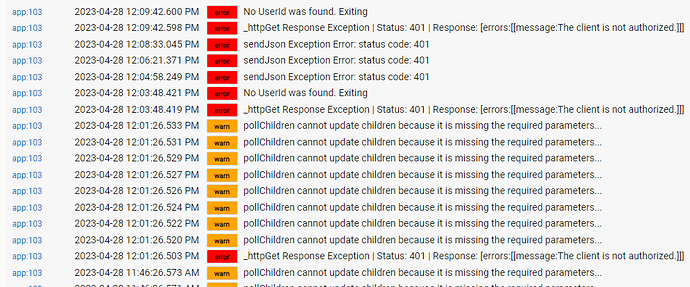

My Rachio integration appears to have broken. Anyone else experiencing this?
Below is a snip from the logs that I noticed.

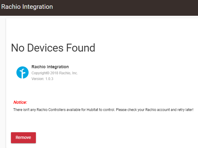

The app status says I don't have a device available. I can access the unit via the Rachio website and native app just fine.

I thought that might be what I need to do, but I cannot find a place to login from Hubitat. Do you know where/how I would do that? This is all I see on the app page:

It's a built in app and still listed there. Did you remove the driver or device somehow?
What do you see if you click the gear icon next to the app?
FYI, there's also an expanded Rachio community app.
Clicking the gear does give me what seems to be a correct status report.
Yeah, basically mine says there are no devices found. Which is odd because my device still shows the controller device and all of the zone device. But all of them show something like "device is offline":

The cloud API uses different cloud end point than their own website and native app. Looks like they may have had a cloud outage, as it appears to be working now.
I went from the built in App to the Community App and it worked fine yesterday, but it's back to giving me errors. It's almost like it's logging us out, but there's no way to log back in.
There must be something wrong with your location. There are no outages reported by Rachio, nor can I replicate the problem with my controller (using built-in integration):
Make sure that both Rachio and Hubitat are connected to the cloud. This is a cloud integration that requires active cloud connection on both sides.
I think I found it, and it's my error. I had to setup a refresh rule for Rachio Integrated app, but the Community had polling built in. So I exceeded the polling for the day.
